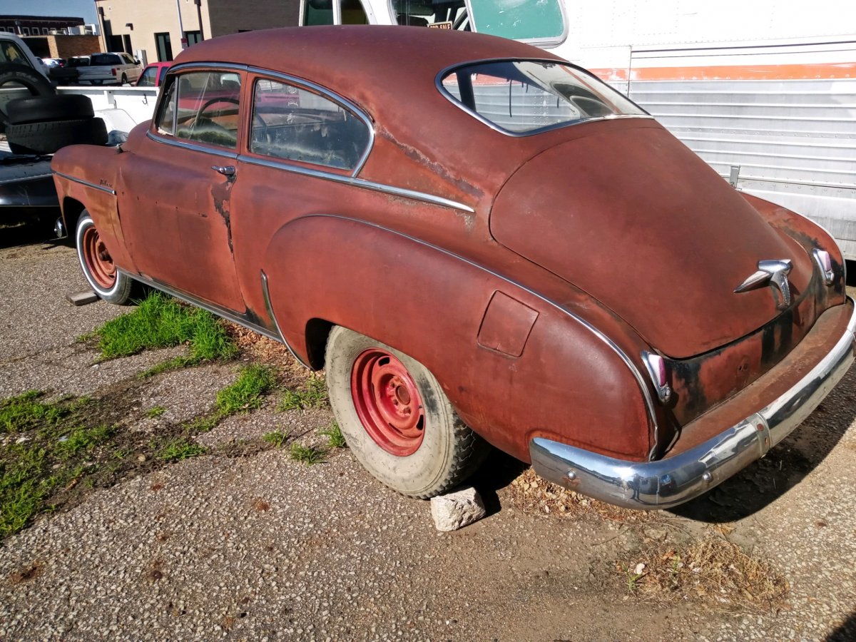

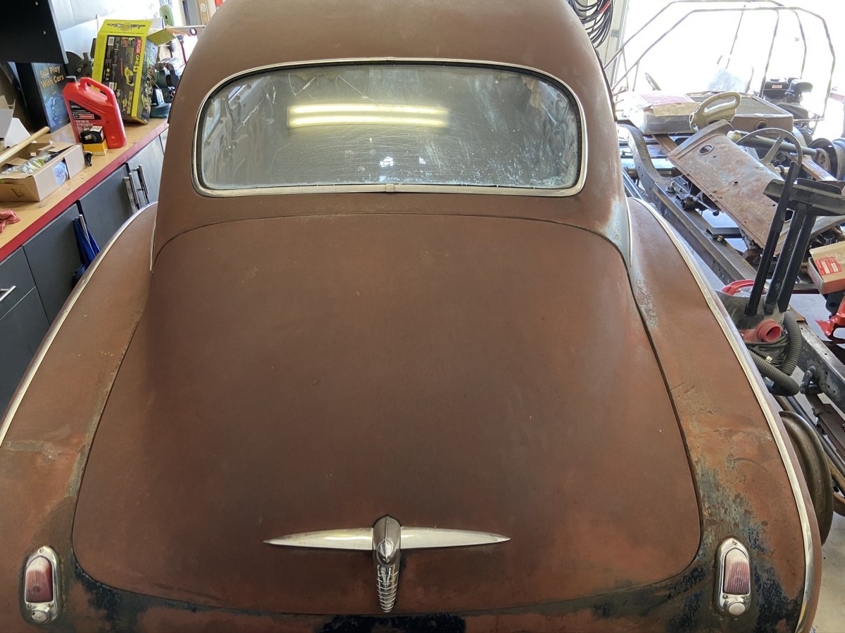

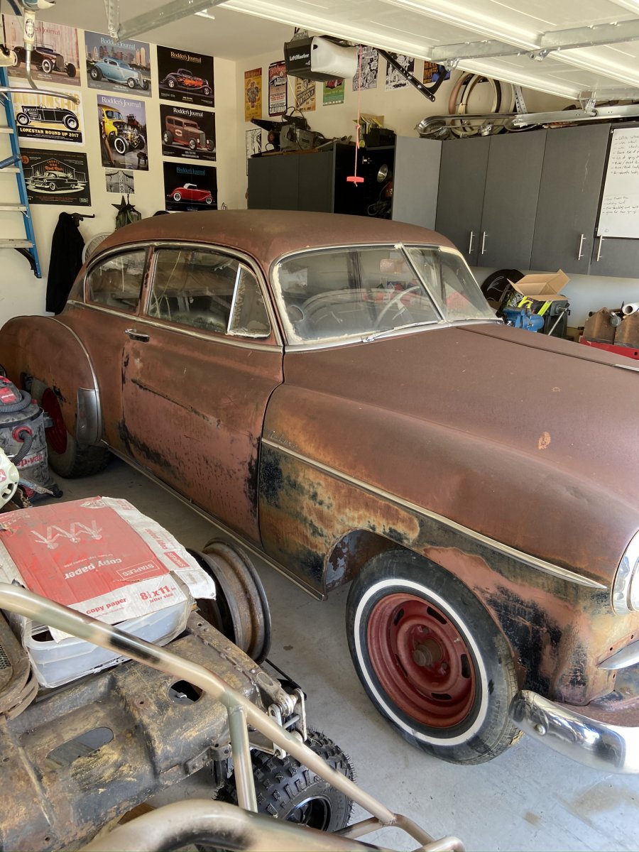

    My son Eli and I will be building this car together as a father son project. Eli is 12 so we have about 4 years to get this thing done. We will update this thread together and look forward to any feed back, advice and tips and tricks you all have regarding these cars.
    We have the sale locked in and are going to pick the car up next weekend. I am super excited to do this build with my son. My dad and I built a 67 Malibu for my first car and it was pretty cool. Eli is a good kid and not afraid of working hard so we will have a blast doing this together. The end goal is to have a fun, reliable car that he can hop in and drive anywhere.
    Running Gear:
    The plan is to keep it simple. We will start by swapping in a 55 Chevy car rear to replace the 50 rear so we can loose the torque tube. We will also grab some new springs Posie’s super slide springs (or equivalent) with a 2” or 3” drop. I will have to figure out what gears we will run (open to feed back if anyone has suggestions.) The front end will get rebuilt, dropped spindles and power disc brakes. Not sure about the steering box yet. We will not add power steering. We need to learn more about these stock steering boxes…not sure if they are good or if we should switch to another (open for suggestions). We have a couple of 283’s to choose from and will add a 700r4. I have some old Cal Custom valve covers, maybe an older aluminum intake and a performer carb…keeping it simple. Rams horns, 2” exhaust and some Porter glass packs with chrome tips out the back. We will wrap it up with either painted steel wheels w/hub caps and wide whites or chrome steel wheels with wide white.
    Paint and Body:
    Our starting point is pretty clean and complete. It looks to be original paint so I am not expecting any surprises. We are going to keep most of the body stock with minimal customization. Maybe frenched head lights and 54 Packard taillights or maybe all stock…we will see. Paint will be a single stage bright red. Eli wants red and I want single stage for the ease of touching up chips and scratches.
    Interior:
    We will insulate the floor, roof and doors really well. We will add a nostalgic looking under dash A/C and have a simple hidden stereo system with Bluetooth connection. We will go with simple pleated vinyl seats, door panels and headliner. We will use the exterior colors on the interior as well. Dash will be new gauges fit in the old dash with an engine turned panel. Either a stock or early Corvette style steering wheel. We will go with a Rebel Wiring harness or similar. Maybe add power windows with early 1960's GM style switches.
    I will start it off with some pictures of the car and another that Eli likes for inspiration.The next upload should be our road trip picking up the car.
    IMG_1012.JPG IMG_1013.JPG IMG_1014.JPG IMG_1023.JPG IMG_1024.JPG IMG_1044.JPG

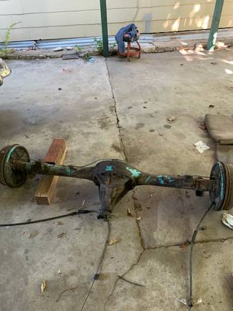

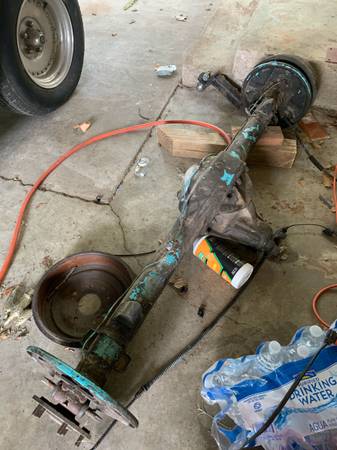

    We found a 1955 Chevy car rear end here is Austin. I have read these should be 3.73 gear ratios.

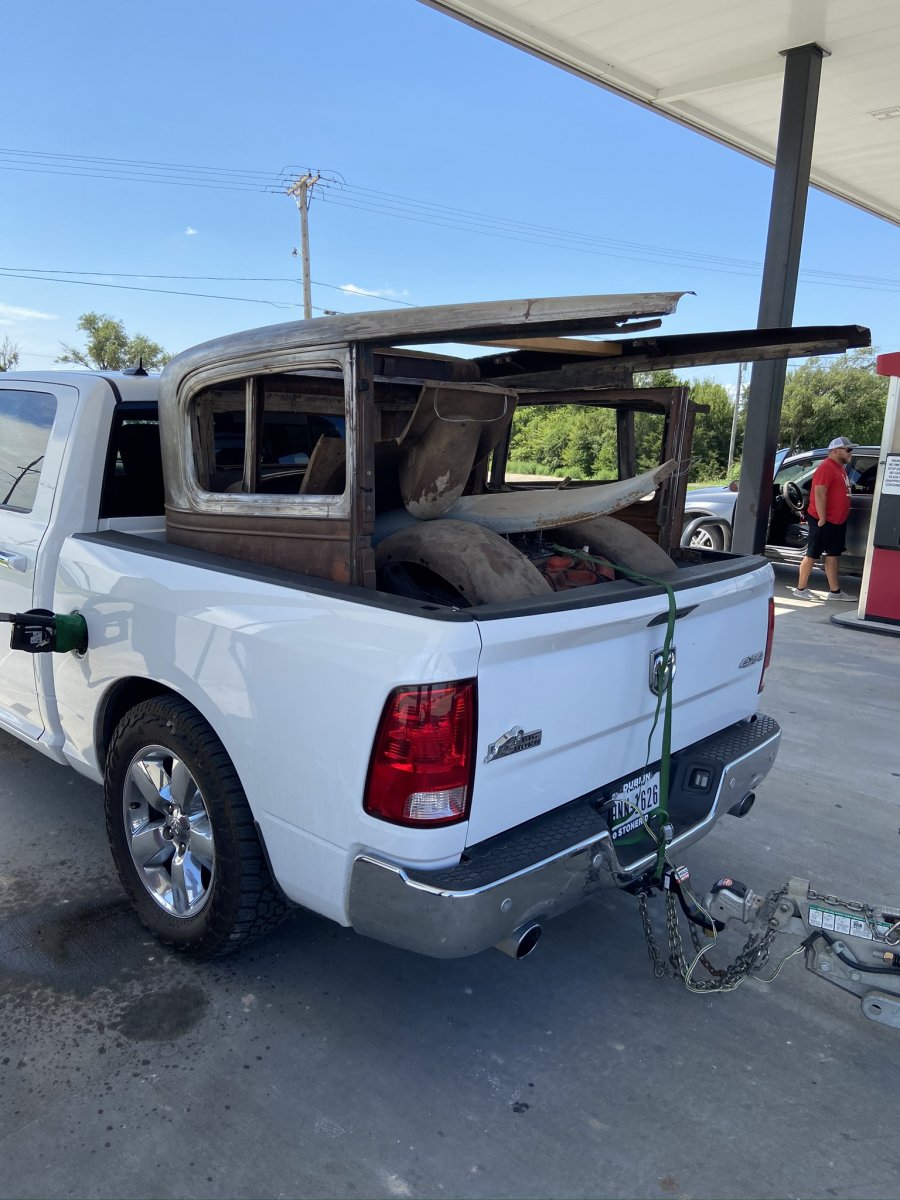

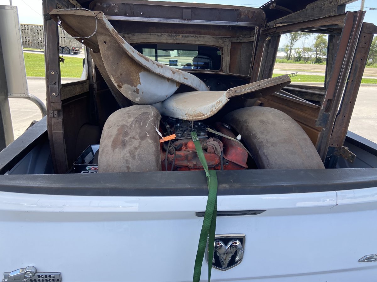

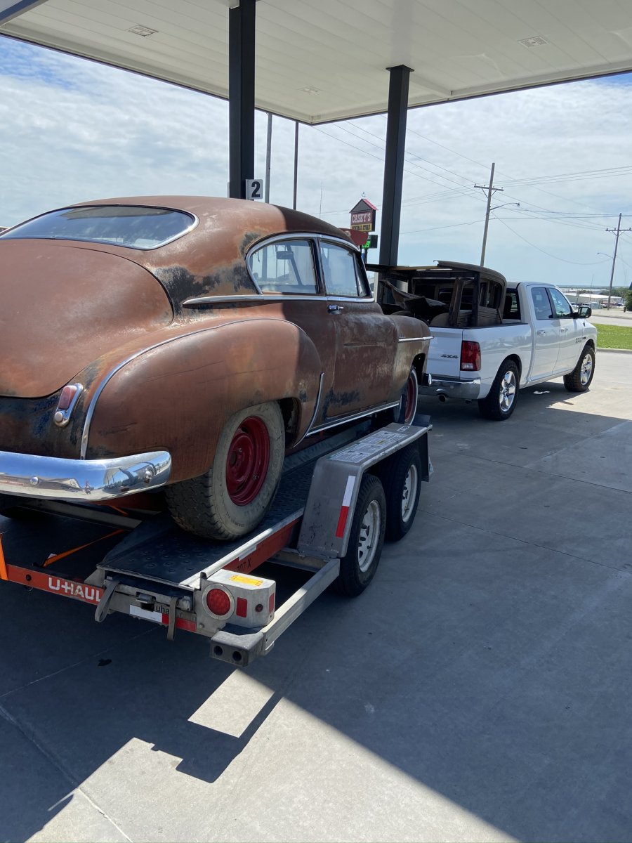

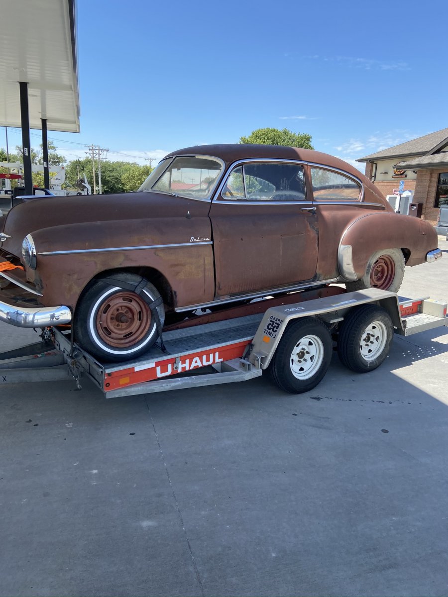

    We ran out to Kansas last weekend and picked up the 50 for Eli and some 31 parts for my build. Here are some pictures of our load we hauled home.

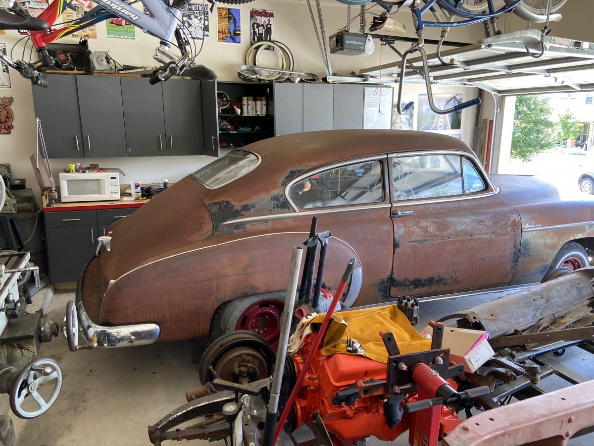

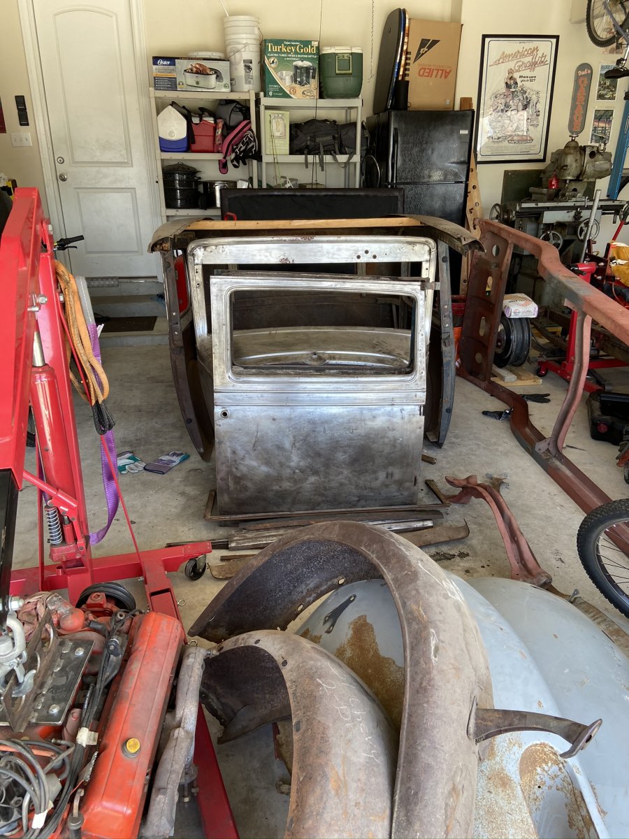

    We have everything unloaded in the garage. We have lots of organizing to do to make room for everything.

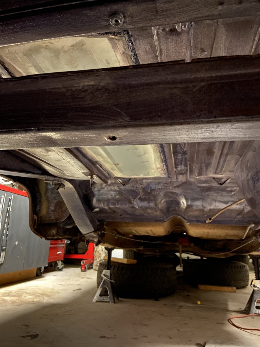

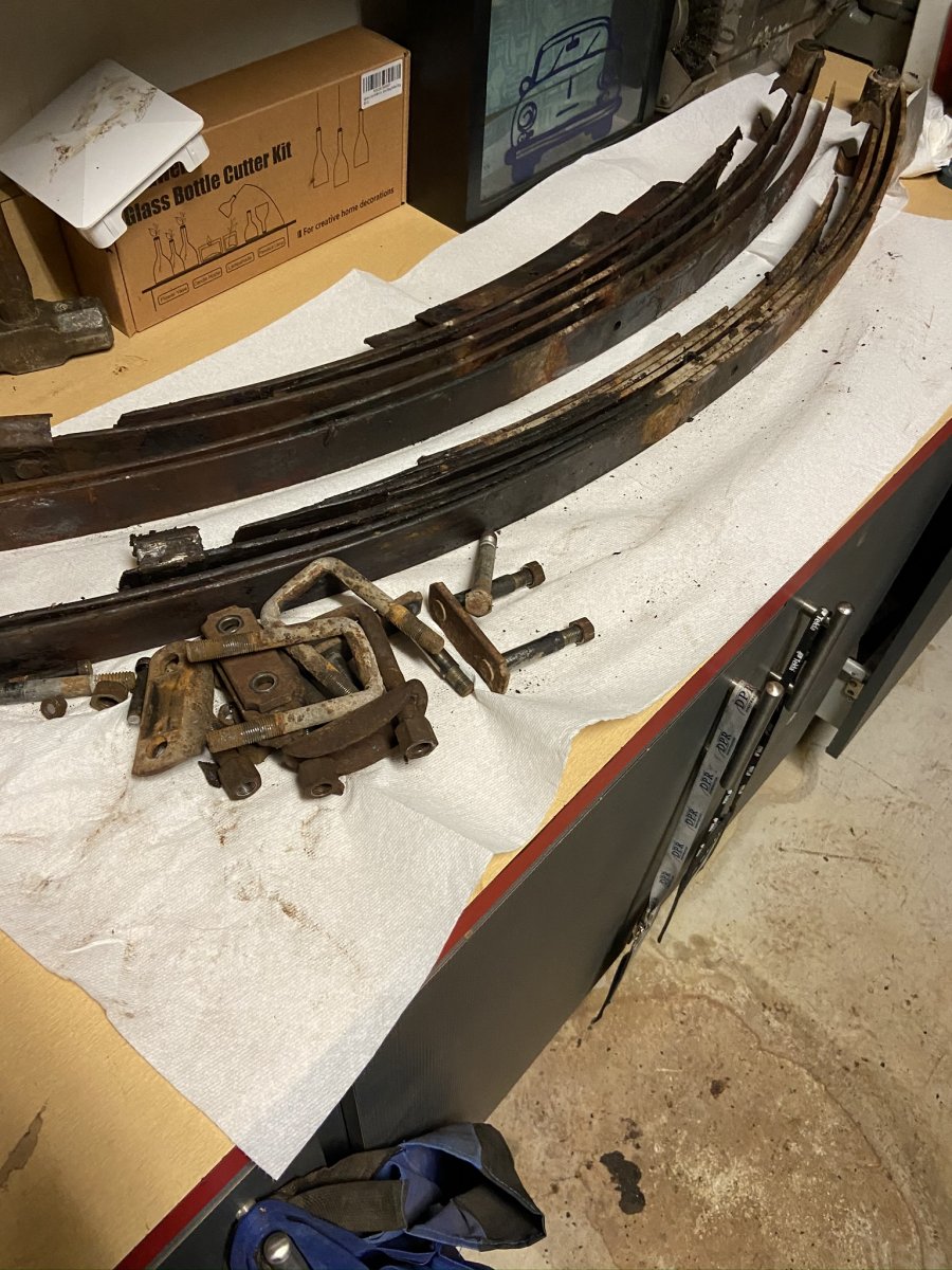

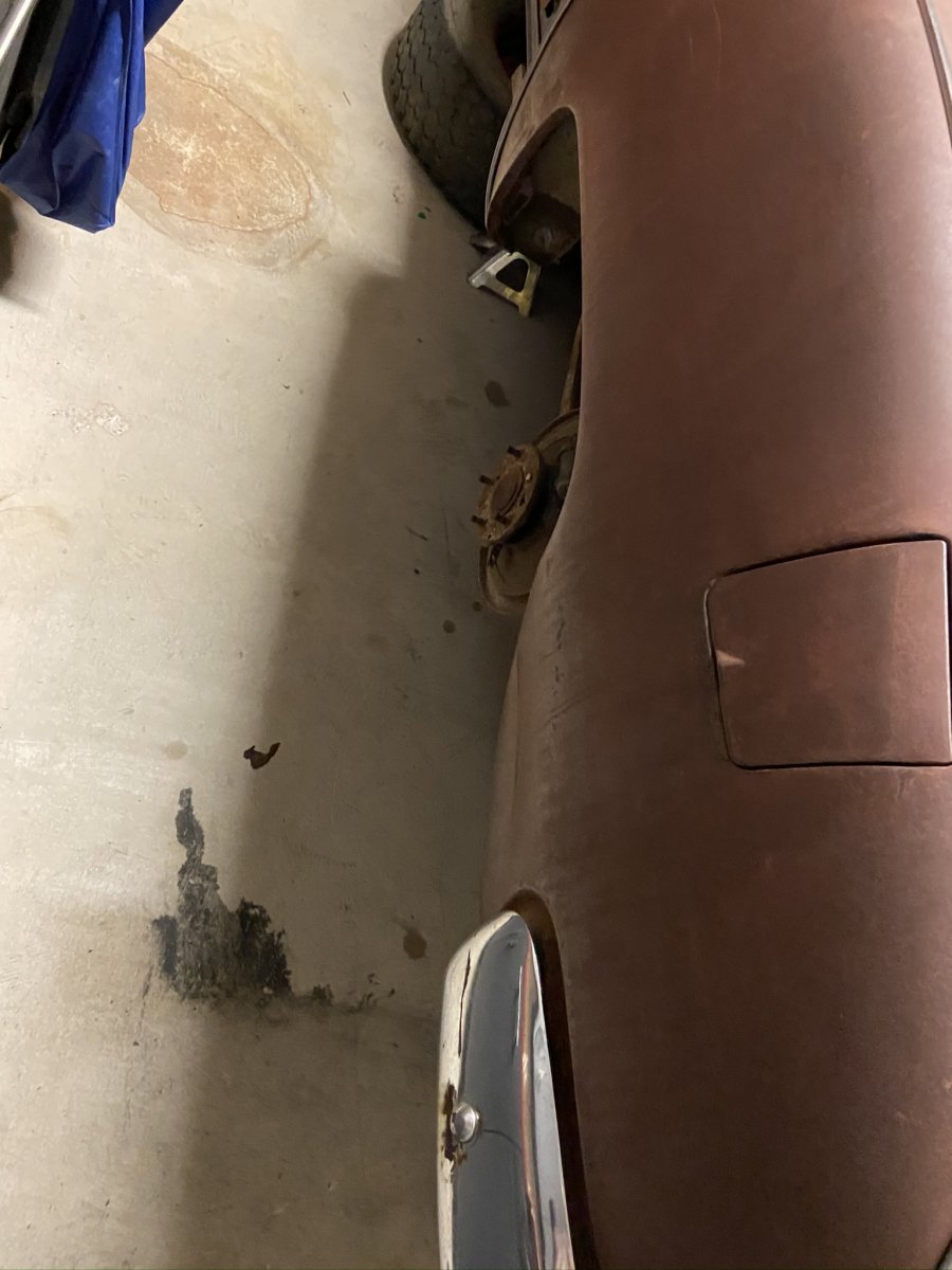

    Small update. Took a bit of time to get all of the crap in the garage sorted out so we have some room to work. We pulled the rear end out. We are getting ready to put the 55 Chevy rear end in. Before we put it in, we will clean up the springs and regrease, assemble and paint them. We are putting new bushings, shackles and bolts along with 3" lowering blocks. Also will paint the bottom side of the floor for the back half of the car, then put the rear end in.
    Once we get the rear end in, we will then move onto rebuilding the front end. Then after that, we will drop in the engine and transmission. Long way to go but we are both excited.

    How many were broken? My Fleetline had a couple bad per side.

    As far as the rear springs, I ran the originals and blocks for quite a while on my 52 sedan but finally decided to swap to Posies. I was amazed at how much better it rode with those. Something to consider and I know you mentioned it previously, so just a little feedback specific to this car.

    They all looked good. None broken. We are going to clean them up real good and inspect before reusing...but so far they look good.

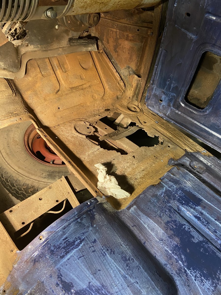

    Not whole lot of progress yet. We got the rear end out, order a trunk floor patch panel. We only need a 12"x18" piece but found a decent replacement panel to cut up.
    We decided to go with the Posies springs in the rear. I called them up and it looks like they will have a set for us in the next few weeks. They are 3" lower and have the pin offset for a later model rear end which will work perfect as we are running a 55 Chevy car rear end. Thanks for the info on these springs @guthriesmith
    For the next little while, we will patch the truck, clean up some surface rust inside trunk and the bottom rear half of the car. Once we get a new coat of paint, we will put the rear end in, then move onto the front suspension.

    Rear end gear ratios for your 55 rear end: 3 speed stick with overdrive transmission 4.11:1, stick shift transmission without overdrive 3.70:1, Powerglide equipped cars 3.55:1; sounds like you're probably 3.70:1. 55-56 rear ends are a little less strong than the 57 ons; they had thinner third member cases, and smaller/narrower bearings, but the third members all swap 55-64 full size, 56-62 Corvette, and 62-64 Chevy II/Nova. Positraction first available in 57. Only really bad thing on the 49-54 Chevrolet car, rear leaf springs, is they are fairly narrow. The torque tube of the stock rear end helped to prevent body roll. We just used overload (coil wrapped shocks) shocks with traction bars and never had an issue with the 51 Bus Coupe (and i'm still kicking myself for selling it!). That's all I've got.

    Butch, thanks for the info! So the rear came from a power glide car, from what I was told. Have not tried to confirm anything regarding checking identification tags yet. The car will have a 283 with a RV cam and a OD auto trans so we should be alright regarding the rear being strong enough for what we are building.

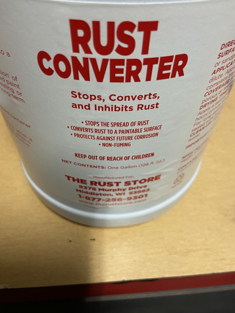

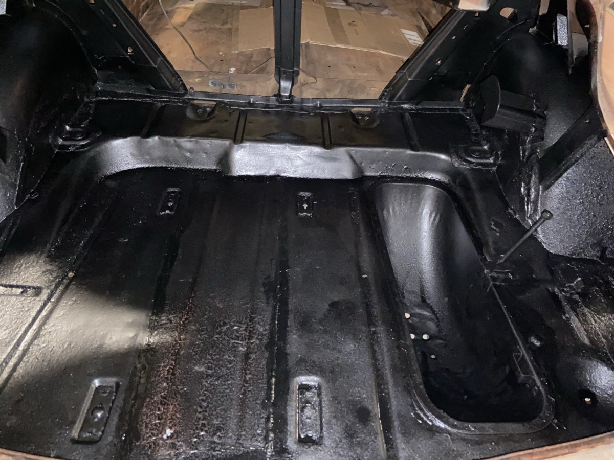

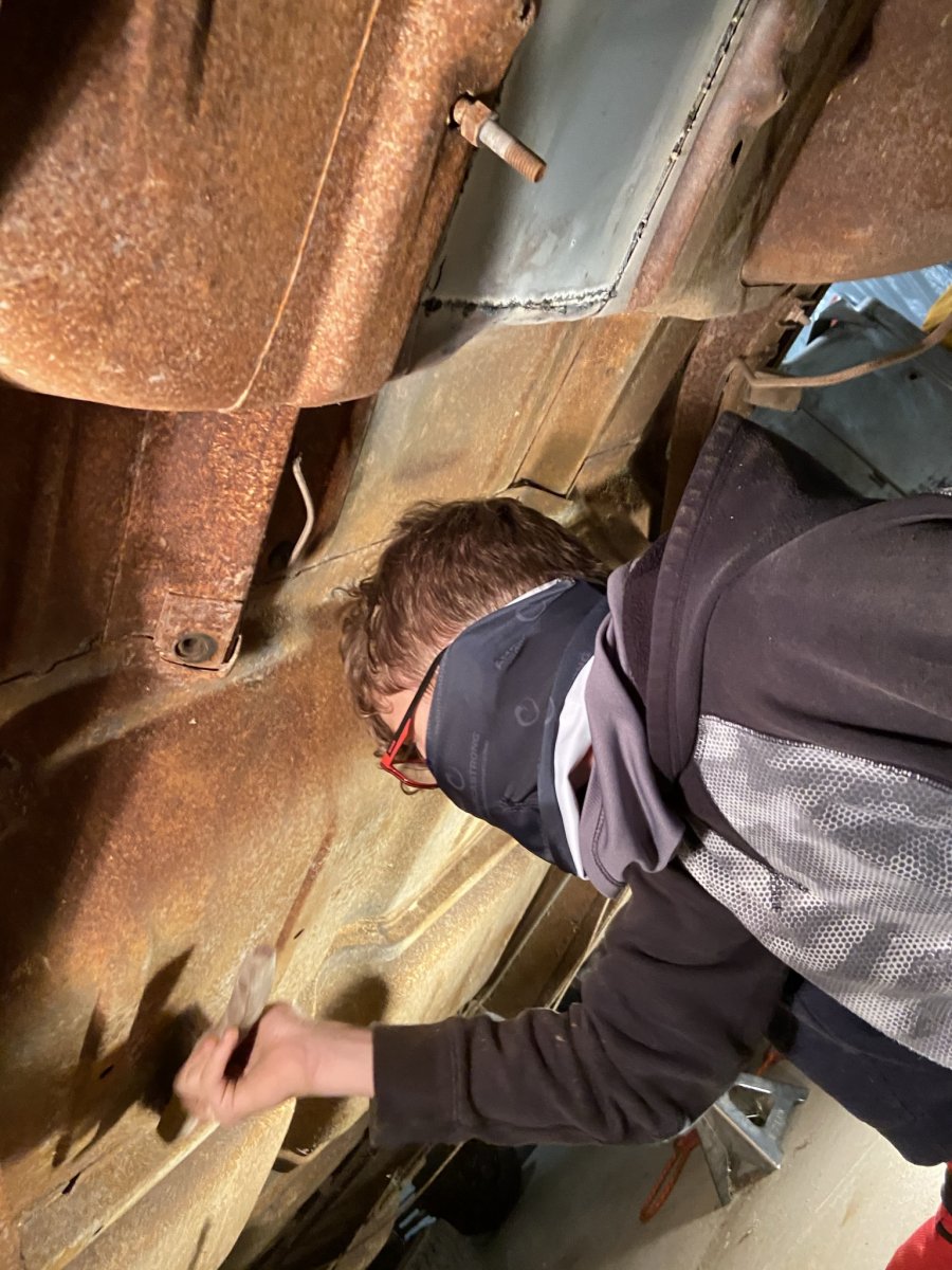

    Small Update: Last night, we prepped the bottom of the trunk for using a rust inhibitor primer. We wire brushed any loose scale, cleaned off the surface and brushed on the primer. We will then brush on a coat or two of rustoleum enamel. WE are also going to use the same process for the inside of the trunk. We cut out and replaced an area that rust pitted and rusted through. The rest of the trunk and bottom of the trunk was just surface rust.
    Here is Eli wire brushing away.
    Here is a shot after applying the second coat. Need to coat the patch panel with a normal primer, seam seal the weld before we paint the bottom.

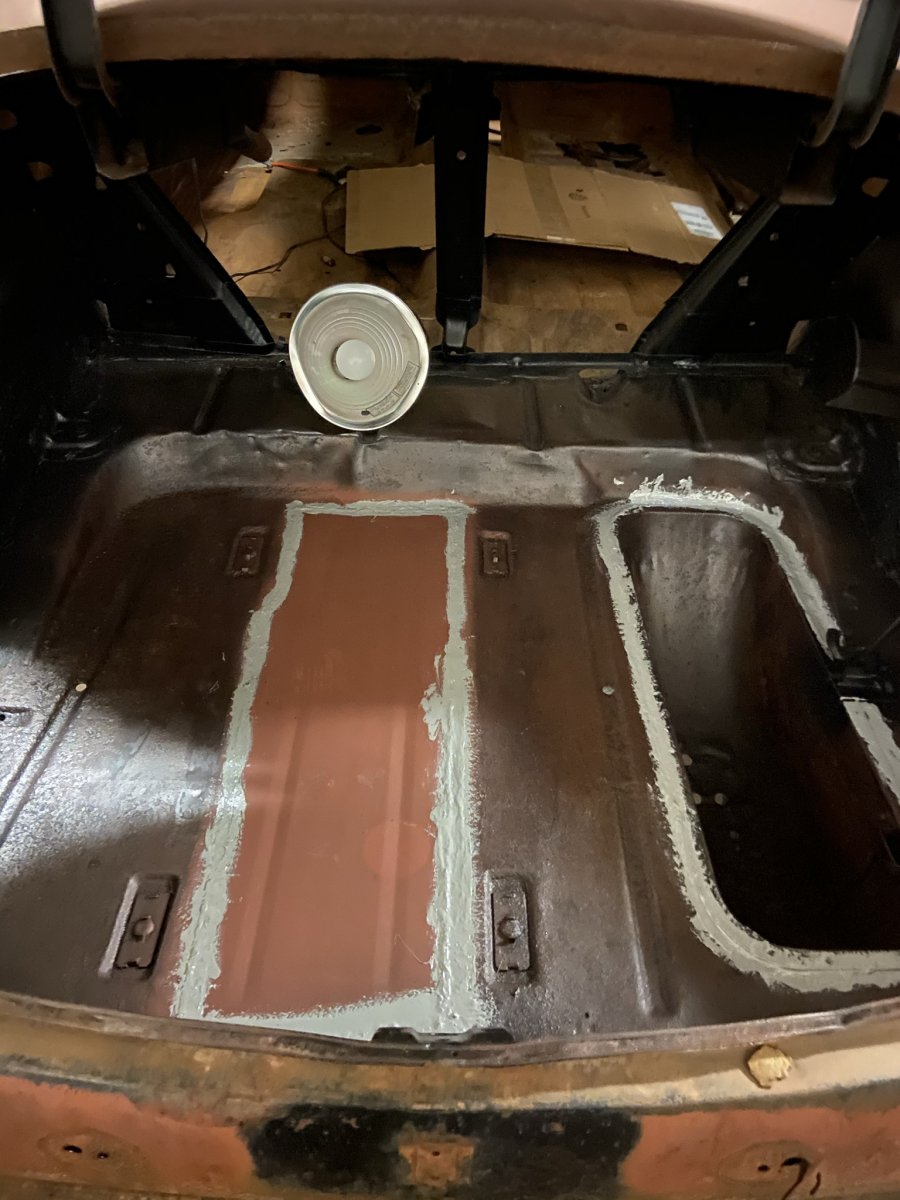

    Some more updates. We work every Monday, or most Mondays and when ever else we can get time in the garage.
    We got the truck primers, touched up some seam sealer, then painted the truck. Had an area where the paint lifted so we need to sand that down and try again.

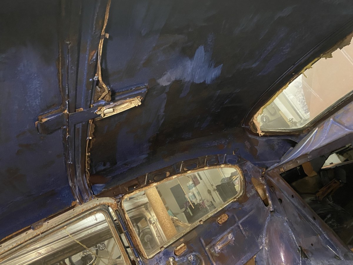

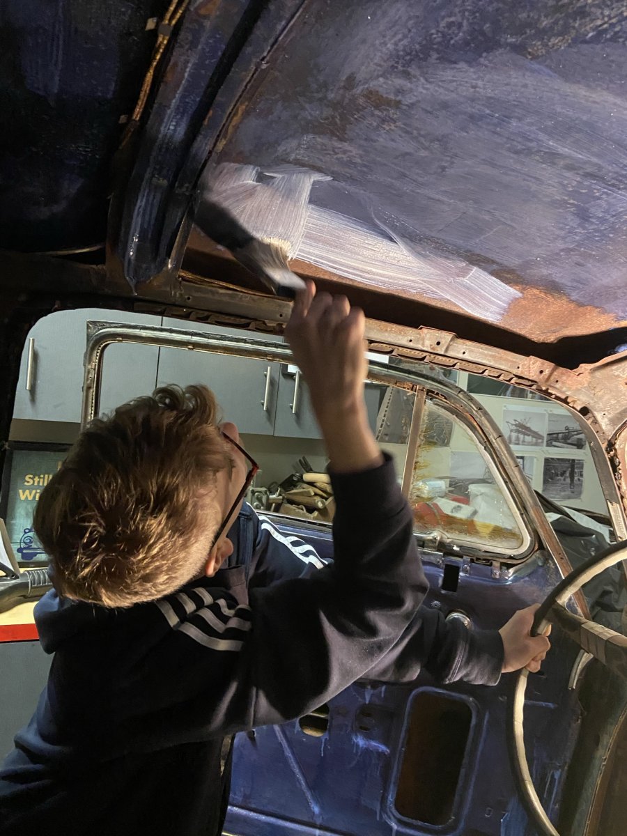

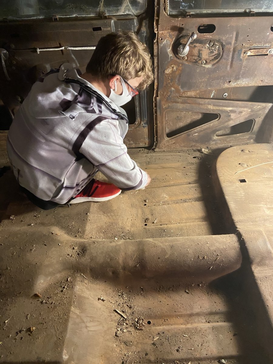

    We cleaned up and used the rust inhibitor primer on the interior as well.
