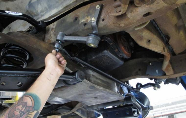

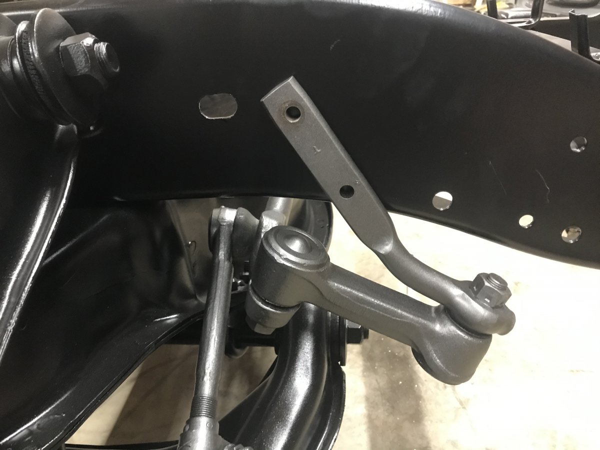

  1. Thanks, but actually it is a 73-87 crossmember with all the steering linkage other than the pitman arm which is still the 63. According to where it was on the other frame and how everything levels out when all other joints are attached, it appears to want to land about here. I’ll make sure tomorrow that everything is right before I mount it.

    Ahhh alright cool, didn't realize you had a different year crossmember....may want to check just to see if the other idler arm would still work, just to utilize the stock frame holes....may work, may not, worth the shot for cleanliness

  3. Good point. Wouldn’t take much to mock it up and the one I took off is just behind the shop. I’ll check that out! Thanks!

  8. The stock 63 thru 66 idler will over center. Use the 73 up idler. no problem to drill two 3/8 holes.
  9. Good to know. I haven’t had the time to look at it yet, so will just plan on the newer one.

  11. Well...got the rearend in with the lowering blocks, shocks back on, and buttoned up the steering in the front. Ended up just drilling a couple holes to mount the later model idler arm. Maybe tomorrow night, we can get all the brake parts on other than plumbing it all up. I’m getting too old to be doing this every night. Good thing we have a deadline and my kid is energetic.

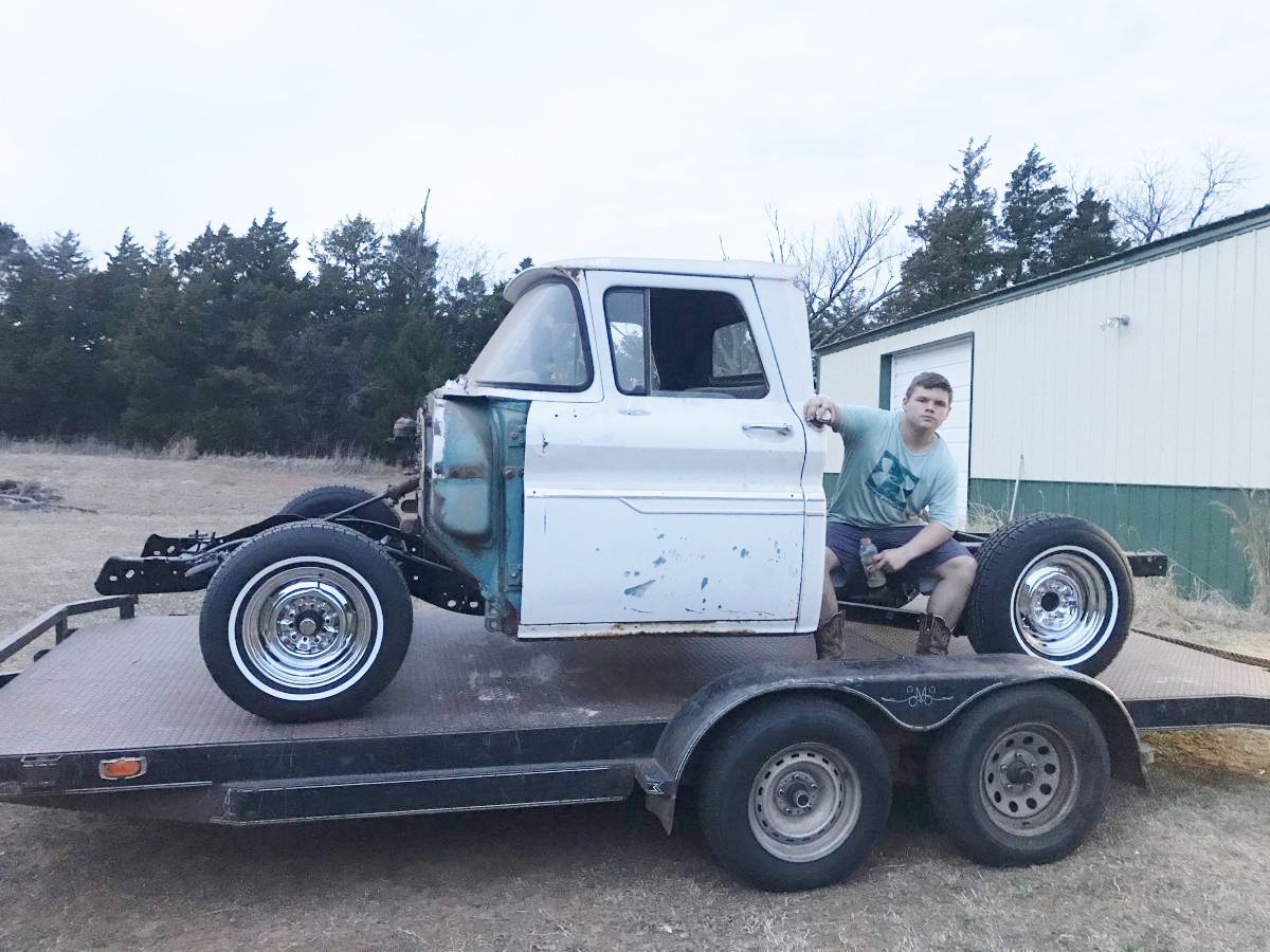

  27. Thanks! It was definitely right at dark by the time we got to loading the pu. The rest of the story is that we had just finished unloading a bunch of fencing off the trailer so we could use it, put out a hay bale for the horses and then chased one down after she ran behind us and out the gate while we were putting the bale out :mad:, fed and watered the chickens and then finally got to what we were wanting to get done for the evening. :D It had been one of those evenings... But, we did get it to the car wash and then stopped for some milk on the way home. Oh, and that didn't include taking my other two kids to driver's ed for the evening that will also be 16 this year...

    Being from Kentucky & not Texas or Oklahoma, it tickled me to see your son setting behind his engine in shorts & his cowboy boots. Kids around here only know expensive sneakers. It was a welcome change of pace to my eyes. Love watching this build, have my eye on an old 60's Chevy truck down in the country I hope to get this spring if someone doesn't see it & beat me to it.
    1Nimrod, Big mike 1968, Thor1 and 4 others like this.
  29. Lol! Actually, this kid likes expensive sneakers too...I just make him change out of them regularly when we are working in the shop. I actually didn't even realize that is what he was wearing in that pic, but did notice it in the one I posted yesterday of him sitting on the frame on the trailer.
