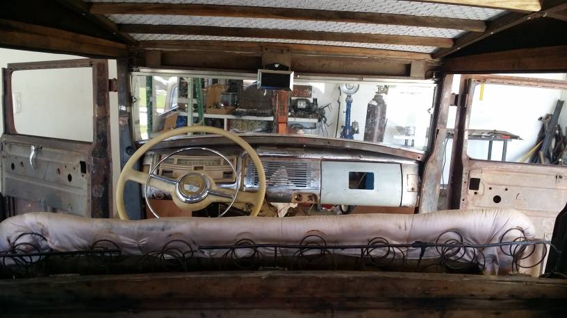

    I traded this sedan body for my roadster body but I planned to just fill the old dash bolt holes and paint

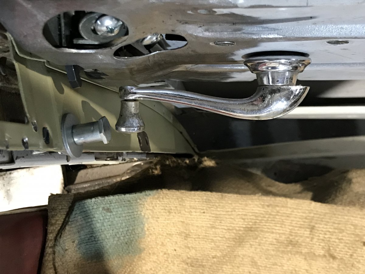

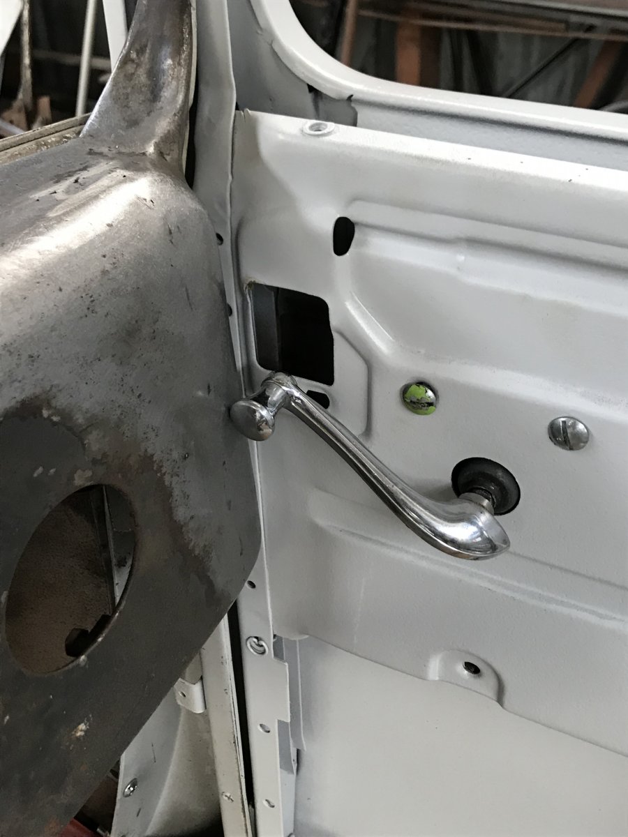

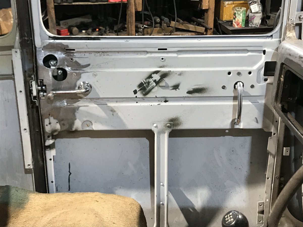

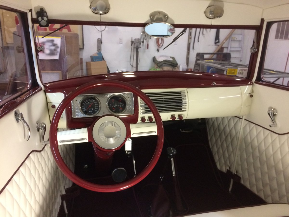

    067C9B8A-BB93-488C-8631-5DBA7949FFD2.jpeg 5F5BBC39-4330-4BEA-B442-488FC9F3B7C0.jpeg 2489FFFD-5721-4128-9E51-AABAB105A1FC.jpeg 6B756DFD-1D38-4681-BA47-E467BB0CA685.jpeg Just remember to allow for window crank clearances. We did not allow when fitted 36 dash to a 28 . On pondering the dilemma we realise ford had planned this swap in 28 and all we had to do was swap left regulator to the right door a right to the left and put the in the corresponding factory holes at the rear of the door. And fitted 37 type door remote handle to the new bear claws.
