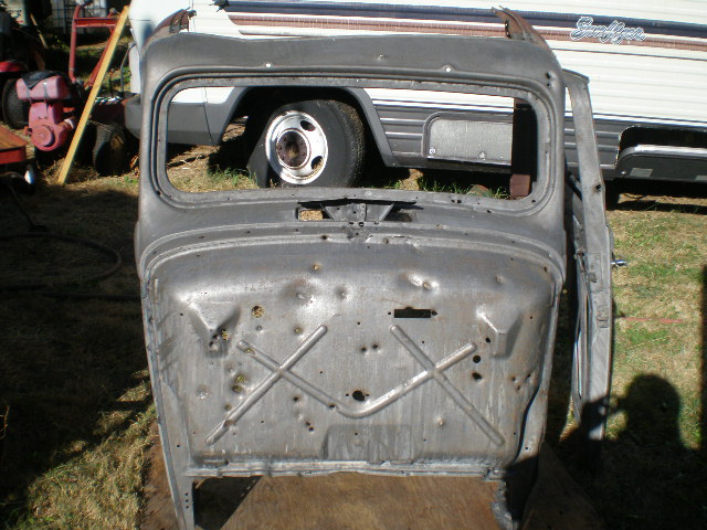

  15. NORSON
    Joined: Jan 19, 2009
    Posts: 469
    NORSON
    Found three more and one is even worse. Also found the fronts, much better, but dear. The last piece of the puzzle is the hood. PC040098.JPG P7260066.JPG
  16. The37Kid
    Joined: Apr 30, 2004
    Posts: 30,787
    The37Kid
    What are you using to dip them in? Derusting job looks good. Bob
  17. NORSON
    Posts: 469
    NORSON
    I'm using citric acid. It's used in food and soft drinks. Takes about five days.
    Norm
