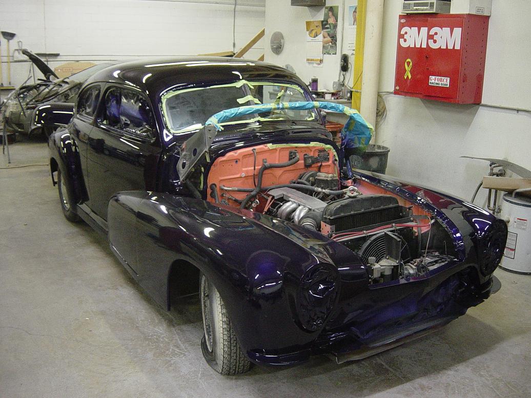

  4. I am a dummy....heheheheh.. I had it up higher, and lower and in the middle....The bumper has a curve in it, and the curve of the emblem matches, that is why I have it low. I am waiting to get the chrome on the car with the color to see where it looks right, if it needs it at all....Nice thing about emblems, they unbolt really easy! Here is a couple pics from Steves camera yesterday....preping for paint

  6. Nice Poncho Rocky! Back from basketball practice, So I will get the pics up to speed. Here is Mark spraying the seal coat primer to keep the evil peach color from bleeding through!
  7. Here is the base. Really a different look.
    kidcampbell71 likes this.
  8. I had to leave after the first base coat to be home in time for the kids to get off the bus, so I missed alot of the process. After I made dinner and got the kids homework and stuff taken care of, I had to take them to baton practice. We left early so we could stop by S&M to see how the car came out. When we got there, Mark was still in the booth! He started spraying at 1pm and we got back there at a little after 7pm! Here he is spraying the last of the clear coat....after about 15 min. I took the kids in the spray booth to check it out. They were very proud of the color that they picked out!

  12. Here it is as it sits today.....It was too tacky this mourning, so I worked on the garnish mouldings. In the afternoon I started sanding. I used a stone for the little dirt knobs. ( not many ) Then I started wet sanding with 1000 grit.

  25. Thanks for all the great comments! Yesterday I sanded, and sanded, and sanded.....1000, 1500, then 2000. Anybody have any opinions on what hubcaps to run on this thing? Frist task when its back home is to do the wheels and mount the new tires.
  26. After dinner, (family brought KFC to the body shop for a winter picnic) my brother in law Joe came and rubbed the car out. I owe him big time as I think this body keeps getting bigger....
