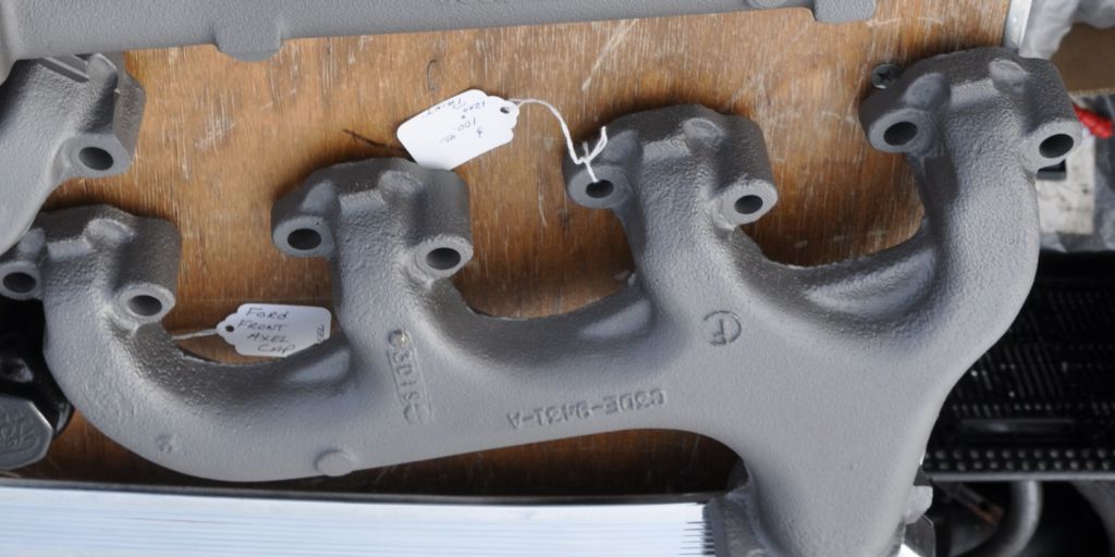

    The '63-'65 Comet and Falcon had a special left side manifold that directed the pipe more straight down for clearance. Here's an image from the Mustangtek site (Sorry for the link, it seems I can't copy the image):
    http://www.mustangtek.com/exhaust/images/C3DE-9431-A_01.jpg
    C3DE-9431-A
    63-65 Falcon Comet Ranchero
    Driver side
  16. That may have been a '63-only part. I'll note that only the 260 was available in them that year. I've owned multiple '64-65 289 V8 Falcons and Comets, none of them used that manifold.

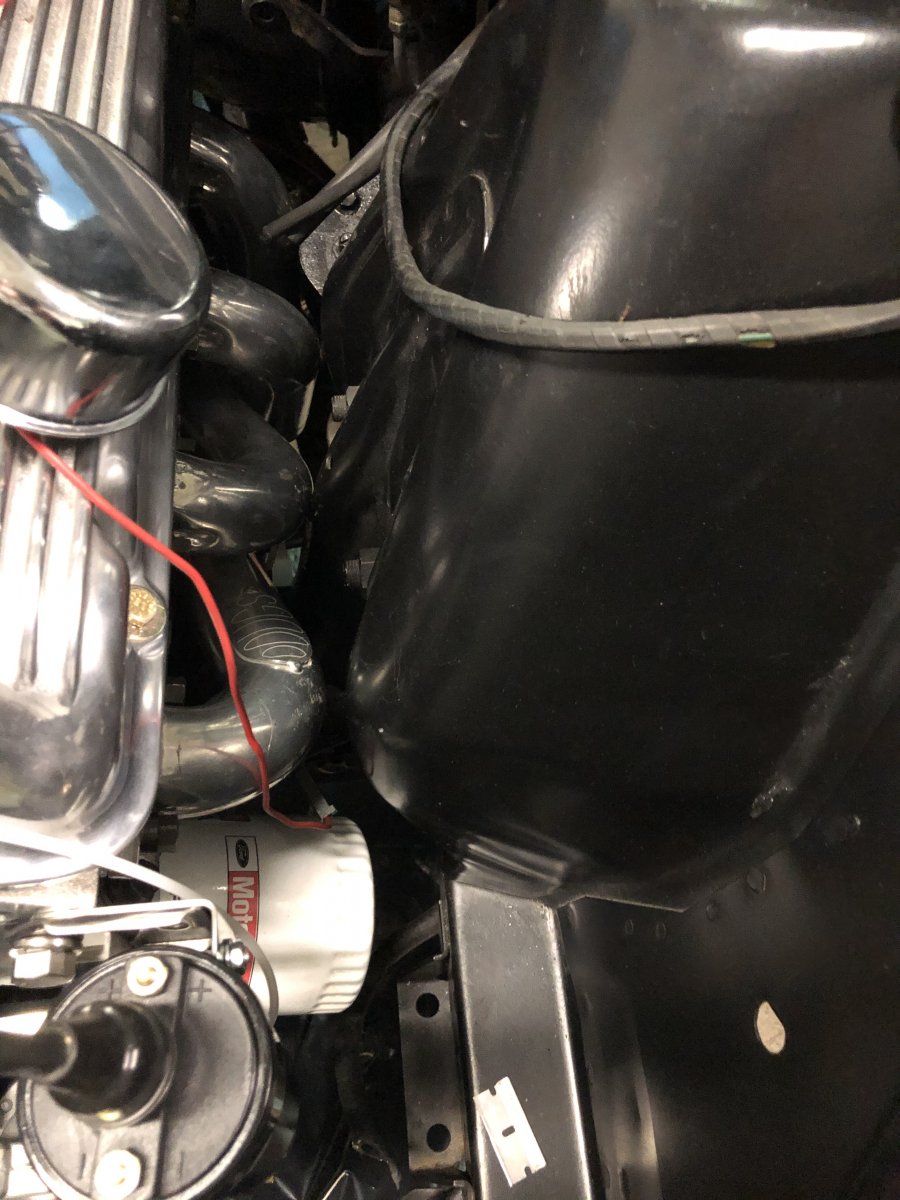

  20. Doug’s in my 65.....scored em cheap on FB....not an easy fit....bit they fit A2402172-B7DB-4D7E-A648-95CF6CA2CF9C.jpeg D3D233DC-CA83-4203-92CA-71C0866536A6.jpeg

    That manifold shown in post #16 is what is on my factory V8 ‘64 Comet. Just checked it.
    C3DE-9431-A

  23. Well...yeah..motor had to be lifted, tilted..came in from the bottom...I modified a wrench by grinding the #*#* out of the closed end and ground the open end too..I spent money buying what I hope are the best gaskets and the bolts have the serrated washers that are supposed to lock and keep them from getting loose..these engine bays are tight..

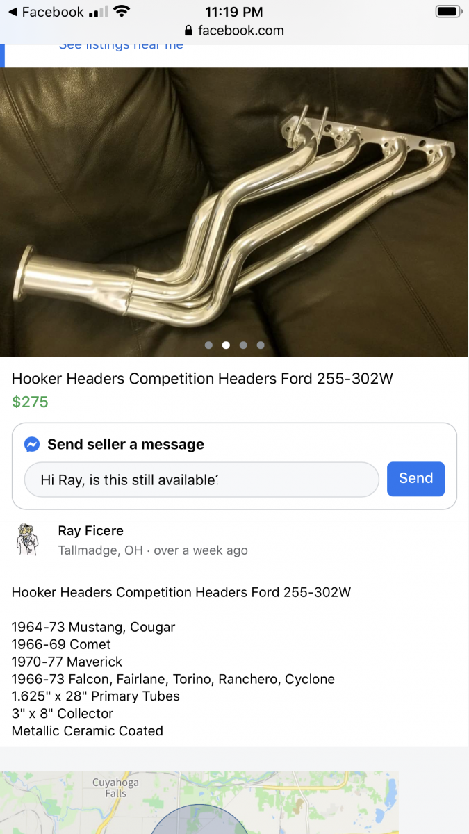

  24. 76B567FA-43C4-41CA-9896-D7C9504D8663.png Facebook Marketplace...
    captaintaytay likes this.
  25. Notice there's no mention of '60-65 Falcons or Comets....
