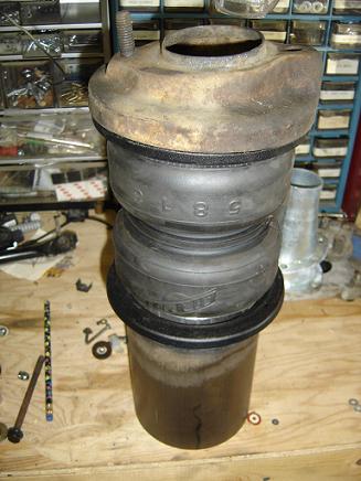

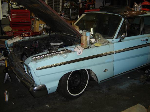

    Ok, nowthat I have done some research and had some time to dig into it here is what I have gotten done so far. The tops are actually the original cups for the coil springs that mount inside the shock tower and provide the mounting location for the shock & crossbar brace to firewall.
    I didn't take a picture but I used some all-thread thru the top of the bag thru to where the shock originally mounted so I could still use all the braces and keep the bag located. The top plate is welded to the factory cup (sandwiched between the oem coil cup and the airbag cup.
    It sits 4.5" at the rear of the front wheelwell rocker when aired out. I tried to have it so that if a bag blew or tire I wouldn't be dragging my chassis on the ground :eek: . This is my first air suspension and I can always go lower later but I prefer to drive my cars so they need to be safe.
    I still have to wire it all up and finish my brake swap but here it is as she sits now.
