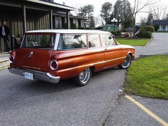

  18. Shaggin bagged his 62 wagon this past winter and it has worked great! Drop him a pm if you have any questions......hope this helps.
    Shaggin's bagged Falcon.

    I looked up Shaggin's username but nothing came up... :-(
    Would you happen to know if the rear end in his car is narrowed? Are those pics you posted of the car at ride height? Thanks for the info.
