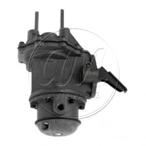

    Vacuum wiper fuel pump (note the two lines out the top):
    Non vacuum wiper pump, on-board filter:
