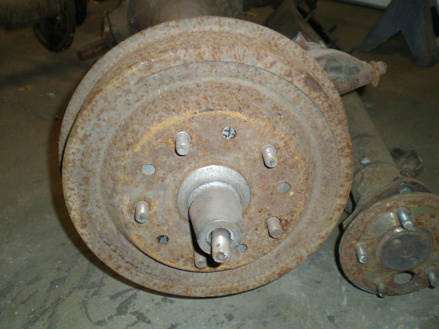

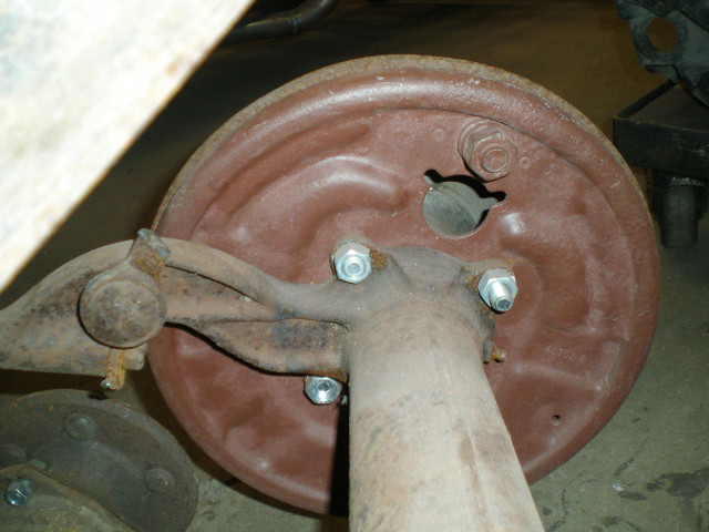

    Pretty easy to put F-1/F-100 front plates on the rear, add some 11" Bendix e-brake hardware, weld in some tubes for the stock cables, turn down the hubs here and there, and use F-1 drums.
