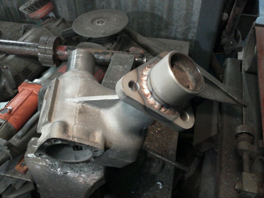

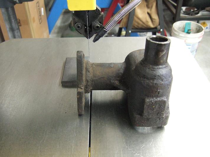

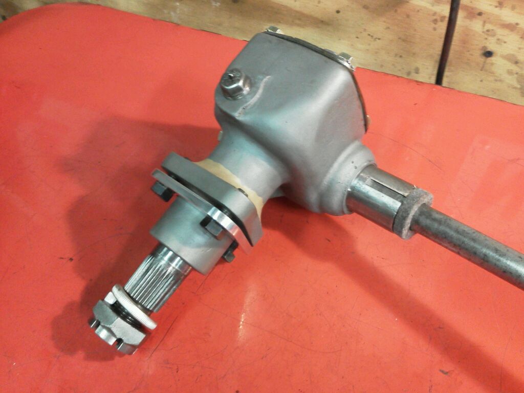

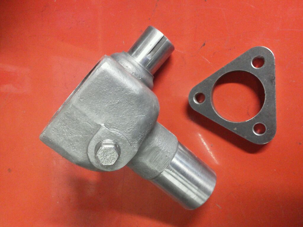

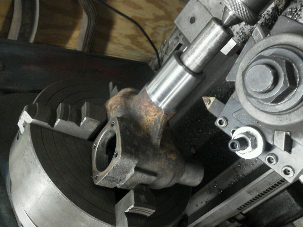

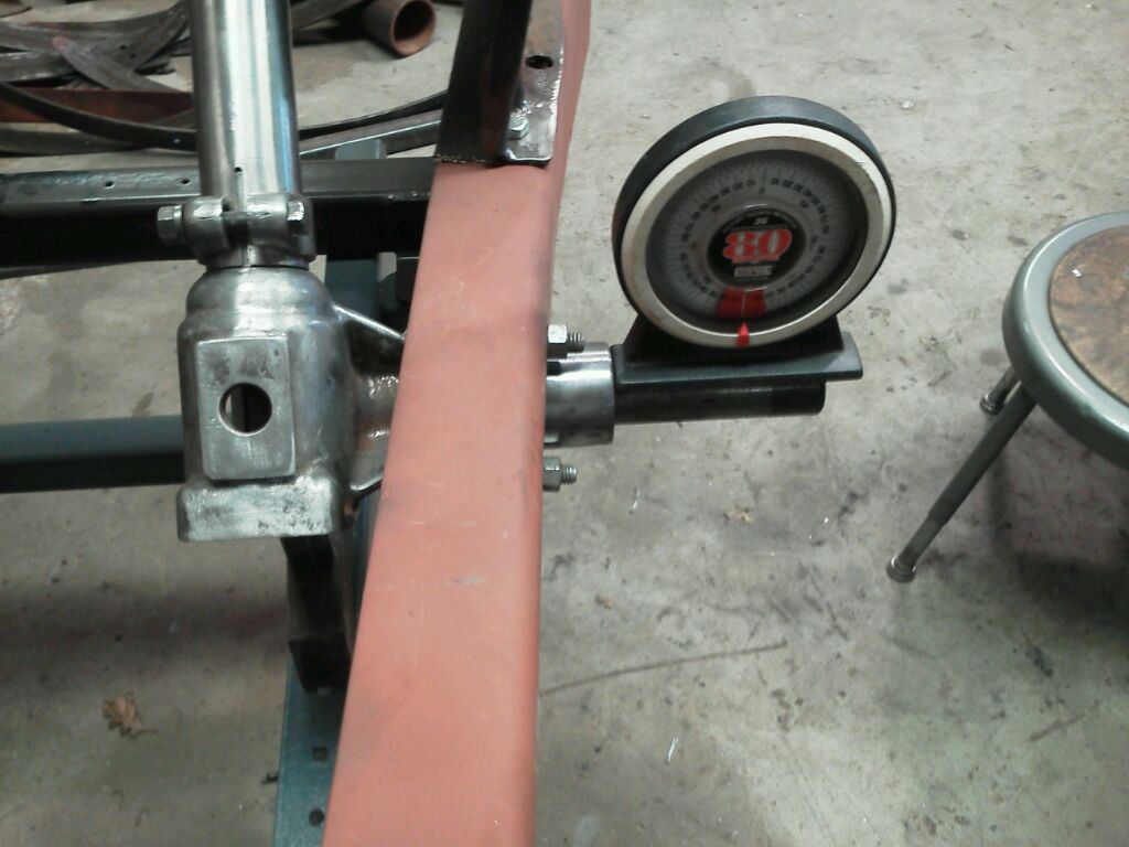

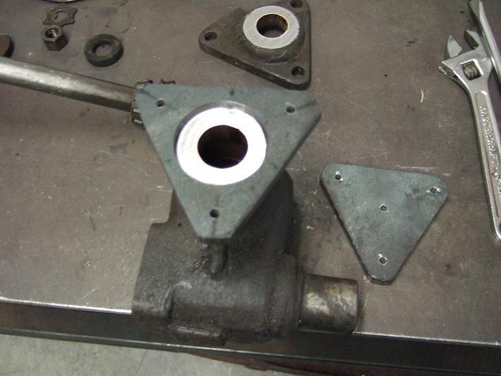

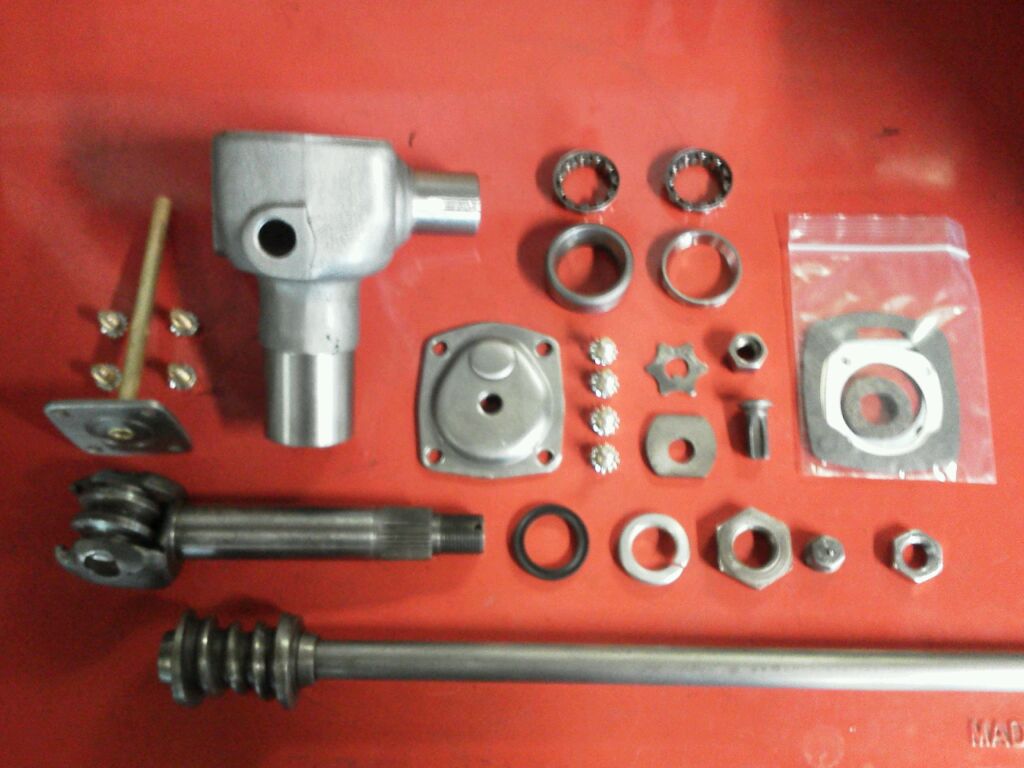

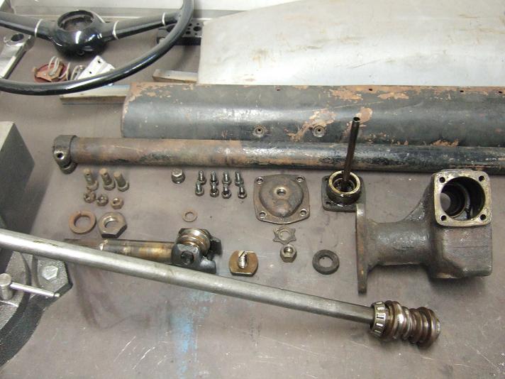

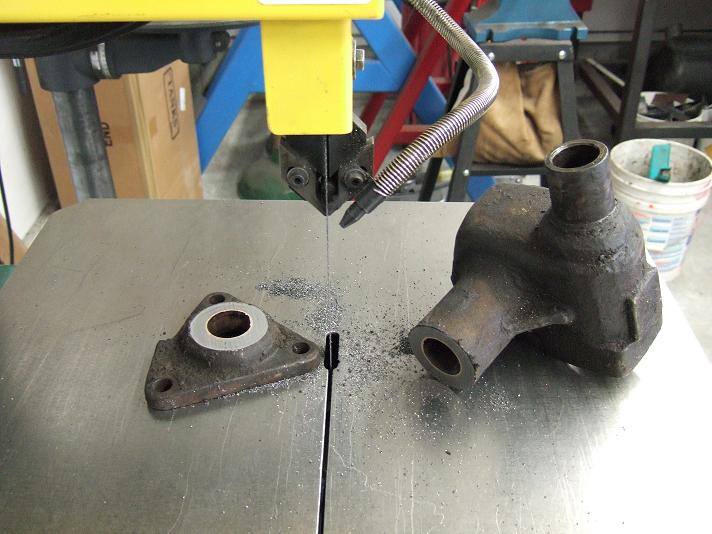

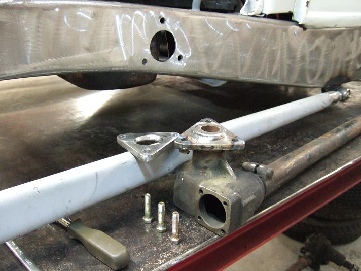

    I had a few questions from Hot Rodders, how I was installing the F1 Ford Truck steering box in a customers '33 Ford Frame, so here are a few pic's which will explain it all. Just as a note, I first determined how long the steering "box" shaft had to be and before welding the flange to the steering box, I heated the box in order to prevent cracking during welding to the box. I didn't take any pic's, however; I use a few clamps to hold the column where I wished the column to be positioned in the cab, then I tacked the flange to the box (obviously on a slight angle).... Thanks....

  8. is there going to be a seal?
  9. Candy-Man
    Joined: Mar 21, 2006
    Posts: 1,709
    Candy-Man
    There is no seal in a truck box, only a bushing, after cutting in the manner I did....

  17. Candy-Man
    Posts: 1,709
    Candy-Man
    Ha Ha, okay I am a ass...
    I should ahve explained myself clearly, which I did not. I cut the seal off of the box, as there is no longer a provision for the seal, as I do not like the box protruding threw the frame.
    I turn the steering shaft in my lathe, cutting a small grove, allowing a rubber "O-Ring" to be placed on the shaft, to form the seal on the bushing.... I missed explaining this !! Oh well..... :)

    Remember : You can shorten the shaft length and then re-weld the frame mount to the box as well....
  21. TexasSpeed
    Joined: Nov 2, 2009
    Posts: 4,617
    TexasSpeed
    That's what I plan to do. I will have to anyways, to center the wheel on the driver's side as well as clear the engine. I wonder if I could just cut the ears of the mounting surface off, grind it down until the end of the sleeve is round so I can retain the felt. Or is the felt not worth the trouble?
    No access to a lathe, so I can't machine in a relief for an O-ring seal.
  22. Candy-Man
    Posts: 1,709
    Candy-Man
    Well it is all up to you. The box is filled with grease, so you would not lose too much oil if you did not have the seal and/or 'O' ring... Just my personal opinion, as I know others will disagree.
    As you mentioned, cut the mounting tabs/ears off the box and weld your mounting flange on the box. With this method, you would retain the relief for the seal..... You may have to hone the brass bearing slightly after welding on the box, before reassembly....

  24. NealinCA
    Joined: Dec 12, 2001
    Posts: 2,882
    NealinCA
    Here's how I do them. I trim the flange ears off with a cut off wheel, the machine the sector housing in the lathe. I then square it up on the frame and tack the new flange in place. I then take it out for finish welding. The bushings then are replaced and honed to fit the sector shaft using a sunnen pin hone.
    As far as lube...I don't think grease is a wise choice. It will wipe off of the worm and roller and not flow back...leading to metal to metal contact and eventually galling. If you do use grease, use an NLGI 00 semi fluid grease. That's your best bet for good lubrication but minimal leakage.
    That's my 3 cents.
