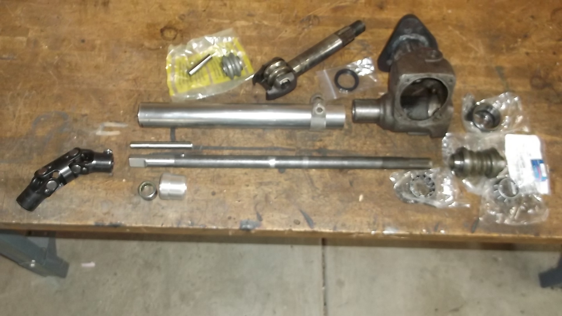

    I'm actually right in the middle of this on my A pickup. The way I'm doing it is I cut the old flange off of the F1 box and machined the snout of the F1 box and bought a new flange made for the model A frame from NealinCA here on the HAMB. I'm putting it in the stock A location and the length of the column seems just about right. It's pretty strait forward once you look at it. Let me know if you need some pictures!

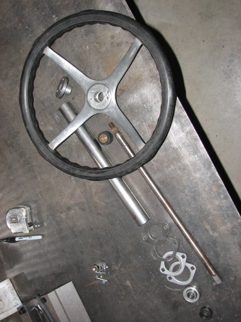

    I am just about at the end of this install also in a 31 Ford roadster. I had the snout of the f1 box turned down and bought a flange kit from NeilinCA as well. The f1 column jacket is smaller than the A jacket so I was just going to get an insert machined up for the difference in the dia. between the two. Here are a couple pics of it. Ignore the steering wheel as it was all I had on hand to get an idea what a 15 3/4" dia. wheel was like.
    Gordon
    P.S. The box is temporarily bolted in with one bolt and a nut for a spacer. I PROMISE it will not be run that way! :eek:

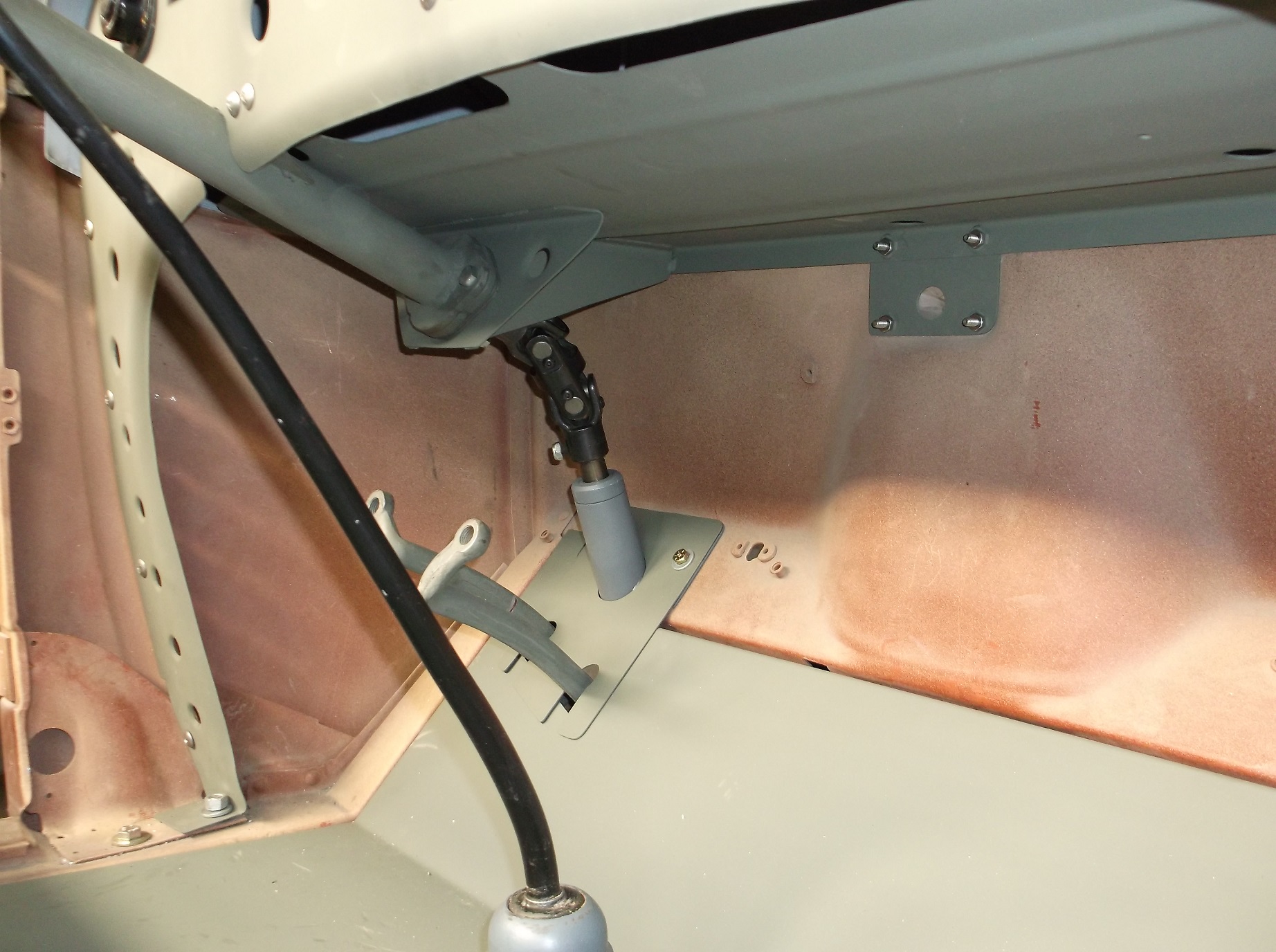

    To make more foot room and flathead room in my AV8 roadster I split the mast on an F-1 box. Easiest just to attach some photos. There is a mounting flange welded to the top of the mast that bolts to the firewall and another flange at on the upper mast just behind the dash. Hard to see, but necessary. The upper and lower sections have to be very well supported at the u-joint.

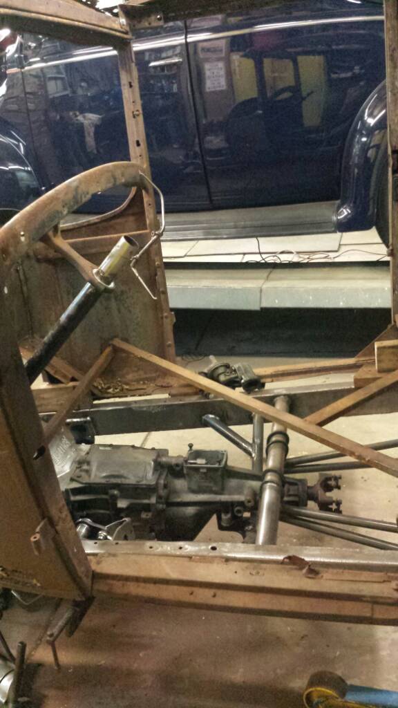

    Here's what I got so far. Drilled the stock hole in the frame a little bigger. My frame is boxed so I have to weld my flange on all the way against the box. Also you can see the adapter I made for the column drop.

    Here's a picture of it machined and in the frame. It's turning out really well so far I think.
