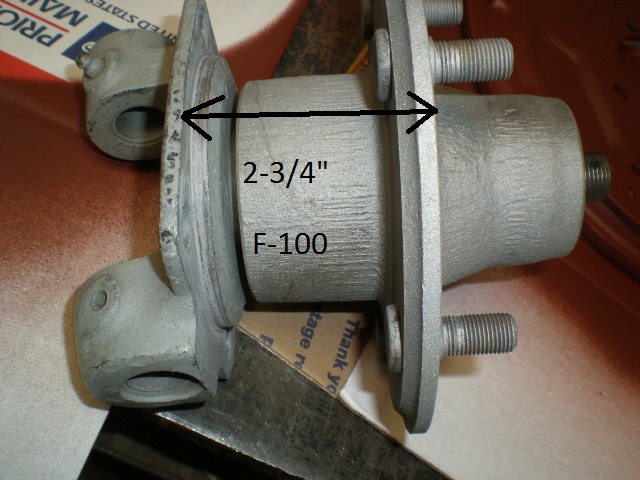

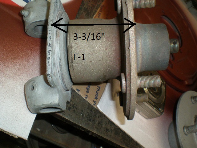

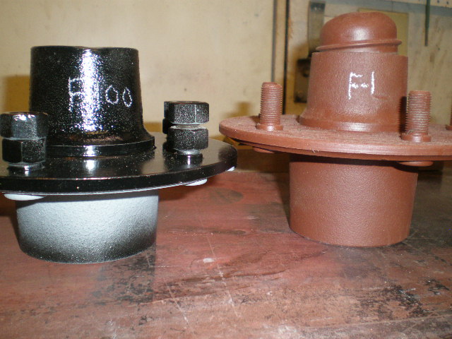

    F-1 front hubs move the wheels about a 1/4" further out per side over F-100 hubs.
    Nothing to worry about. Plus later model F- 150 rear drums can be used on F-1 hubs at a great cost savings.
