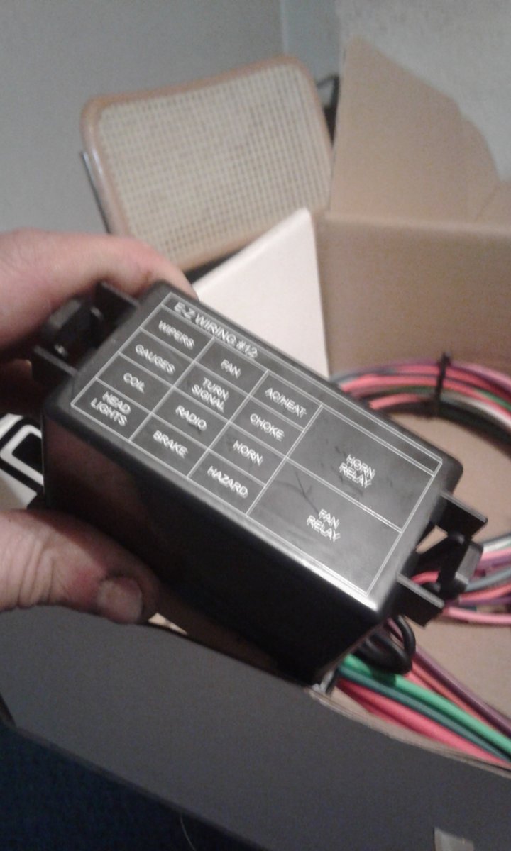

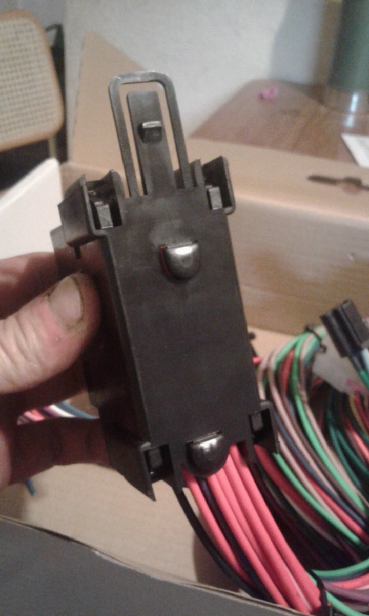

  1. That thing is a ROYAL PITA to mount.

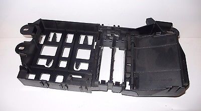

    It would be a breeze if they gave you the female part. I had to make one and it sucked. The tits have a goofy shape and profiles. That has to have a female mount base made for it, it's out there somewhere but I couldn't find which one.
    Every thing else was AOK with me though

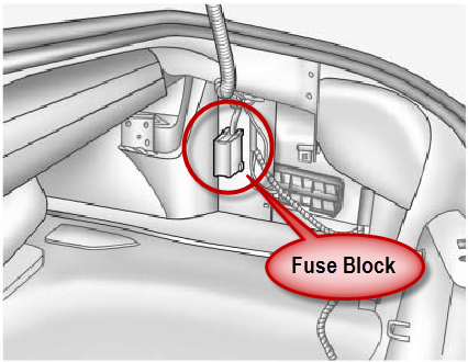

    I'm guessing that is a rear fuse panel of of some late model production vehicle. They have a mount base somewhat like this in the truck. The boxes clip in and out and that would make that thing flat out awesome.

    I was kinda thinking I was missing some kind of cradle for it . I'm gonna call them on Monday. And I will let you know what they say. I was thinking of drilling a couple holes in the back of it but I'm hesitant. I hate mess in up new parts.

  4. That would probably be a good idea. I got it from speedway, but it's the same unit. If you could figure out what the female comes from I'm sure lots of guys would appreciate it. I know I would have gladly thrown a few bucks at it to make mounting it easier.

    I don't remember the details, but I made a mounting plate from sheet metal without too much trouble. A couple of keyhole shaped holes along with a hole for the lug to snap into, if I remember right.

  10. We had the Speedway version of that mini fuse panel; just took the back off and drilled holes thru it where the tabs were and machine screwed it to a small angle bracket. We centrally located the panel, and regrouped the wires to run out both sides of the panel.

  18. I made a flat aluminum plate to mount mine to the floor, up high. I used to have a picture of it somewhere. I screwed threaded standoffs to the plate to get the fuse box off the plate by about 3/4" or I ran into an issue where the wire bundle exited the fuse box.
