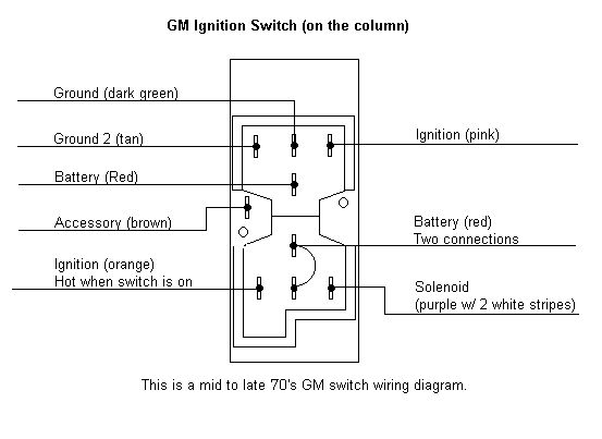

    EZ wiring does not send complete wiring diagram with harness. They give alt, ignition switch wiring for different makes, but that's about all. Now for your question. The 10 gauge red wire should hook directly to battery, normally at the post on the solenoid. GM uses red wires for hot all the time and pink wires for ignition hot. Also there should be another 10 gauge wire that goes to positive post on alt. Since you have a all black harness, you should get a wiring diagram for a GM car with your column ignition switch and use that to figure out if wires are hooked correctly. My diagrams are at shop. I'm sure another Hamber has them on file.

    The 10 gauge wire that says "Solenoid" on it goes to the starter where the battery cable attaches. This is the main power to the Ign SW. And it will feed the fuse panel for the battery side and then from there , there is another wire that goes from the Ign. SW Acc. side to the fuse panel to run the Ign. side of the fuse block. It would be easier if you had the colored wires instead of all black, you'll just have to read every wire to see where it goes.

    You are correct ,the last 2 wires to the right are Ign/ Acc. With the key "on" those 2 wires should test "hot" to make the fuse panel "hot" on the Ign side.. Make sure those 2 plugs are pushed in tight on the sw., they look "loose" in the photo. Also, that Ign. Switch is adjustable.
