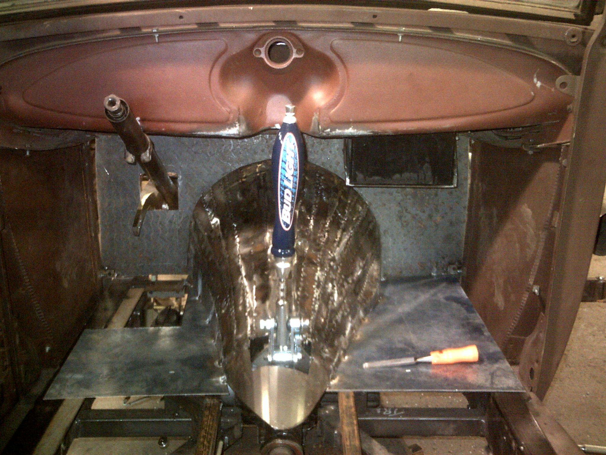

    For the guys with the transmission sitting with you in the interior of the car....How are you sealing up around the bellhousing? I can't come up with a good solution that allows for engine movement (rubber motor mounts).
    Please post pics of how you did it.

    Cover it with a floor.
  3. I suppose you could sandwich a big sheetmetal mid-plate between the engine and trans and rivet heavy leather strips between the edges of the plate and firewall...
    But, yeah, what he ^^^^^^^^^^^^^^^^ said...
  4. Now that is way too practical.
    I suppose I would take rubber like 1/8 thick and cut it to lay against the bell housing and screw it to the firewall, it wouldn't seal it but it would cover it up some.

    I've been wondering about something like that. If the gearbox is "divorced" one can have a sort of domed floor panel over the bellhousing with a hole with a rubber boot of some sort where the front driveshaft comes out. Of course one doesn't want an exposed drive shaft next to one's ankle, so that would run in a sleeve with another boot or something to the front of the gearbox. That would put the clutch in a less threatening position, and allow a bit less engine heat to be conducted via the bellhousing.

    I'd make a tranny tunnel that unbolts and comes out through the interior.
    That way it can hug the odd shape of the tranny& OD, and you can take it out of the way when the tranny needs to slide foreward to get it out of the car.

    Metalshapes has the right idea. Build a bolt-in tunnel around it.You have plenty of leg room. With that bell housing,trannie and overdive unit the heat is going to get to you. Looks over saftey is not the way to go.
