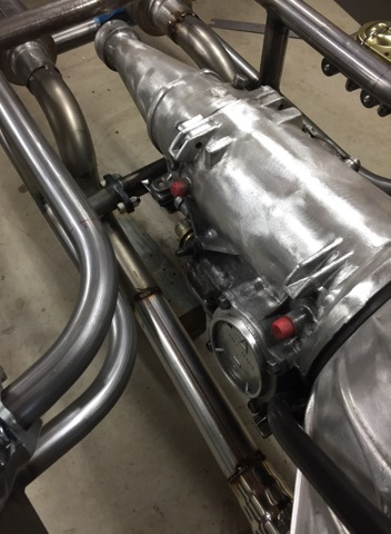

    I buy U bends, straight and hangers then break out the saws and welder. This one is all stainless under my '32. Bends from Speedway with straight, hangers and mufflers from Summit. Still needs finish welded. Hangers in front of the muffler and just before the tip. Only clamp is the band clamp behind the mufflers (really getting to like band clamps, this one time at band clamp.....). Comes out in 2 pieces per side. Take your time.
    Doing the same on my unibody but it will go clear to the back after I decide on mufflers.
