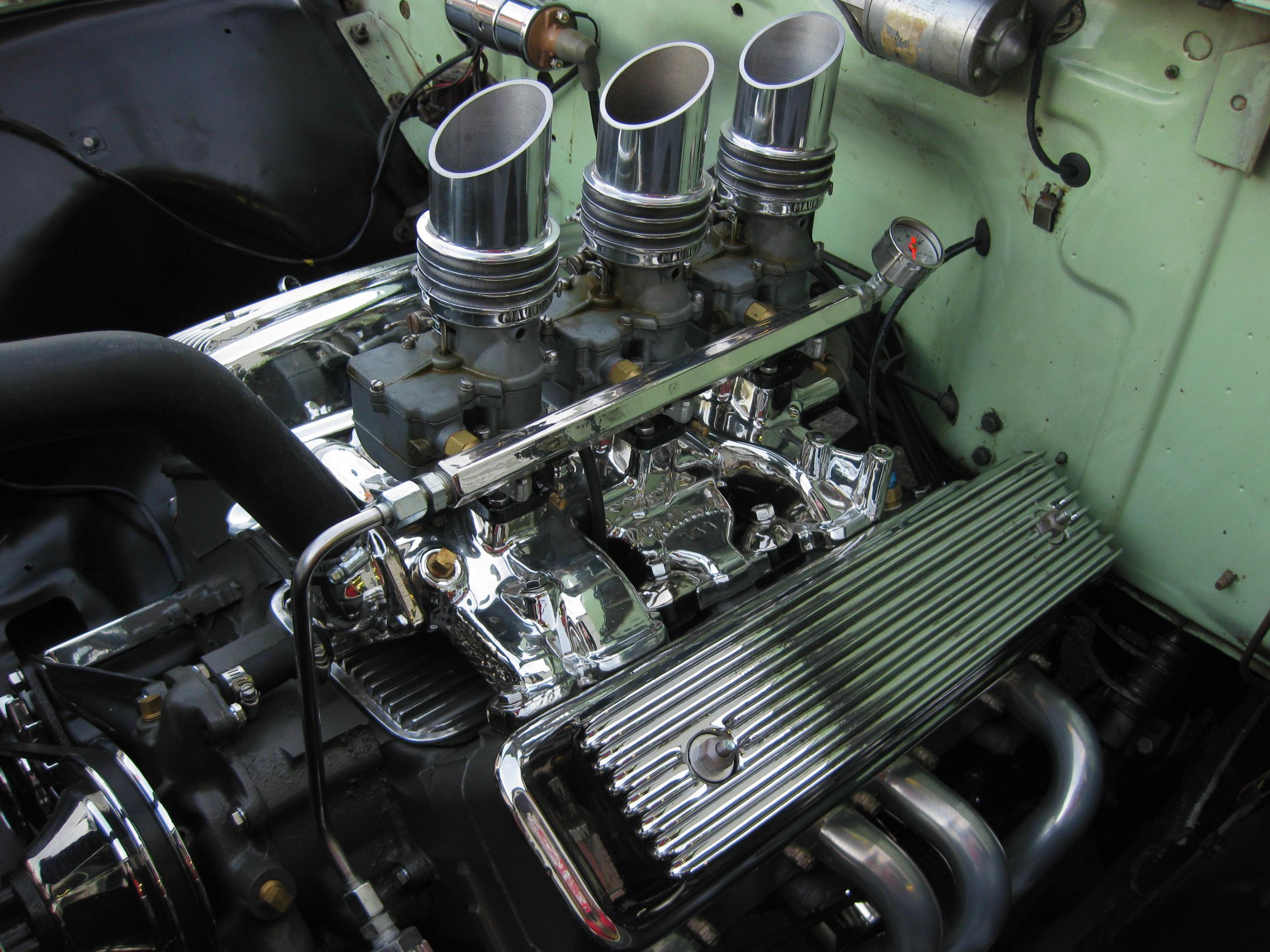

    Here are a few shots of my bro's F-100 Another buddy of mine owns Wheel Tech out here, Everything you see in the pics is powder coated Chrome done by Wheel Tech..
    Note the intake and Valley were not polished, i brought them to him and they were just sand blasted. He has it down..
    I imigine you could get everything done from him for about $4 to $500.00 maybe alittle less.
