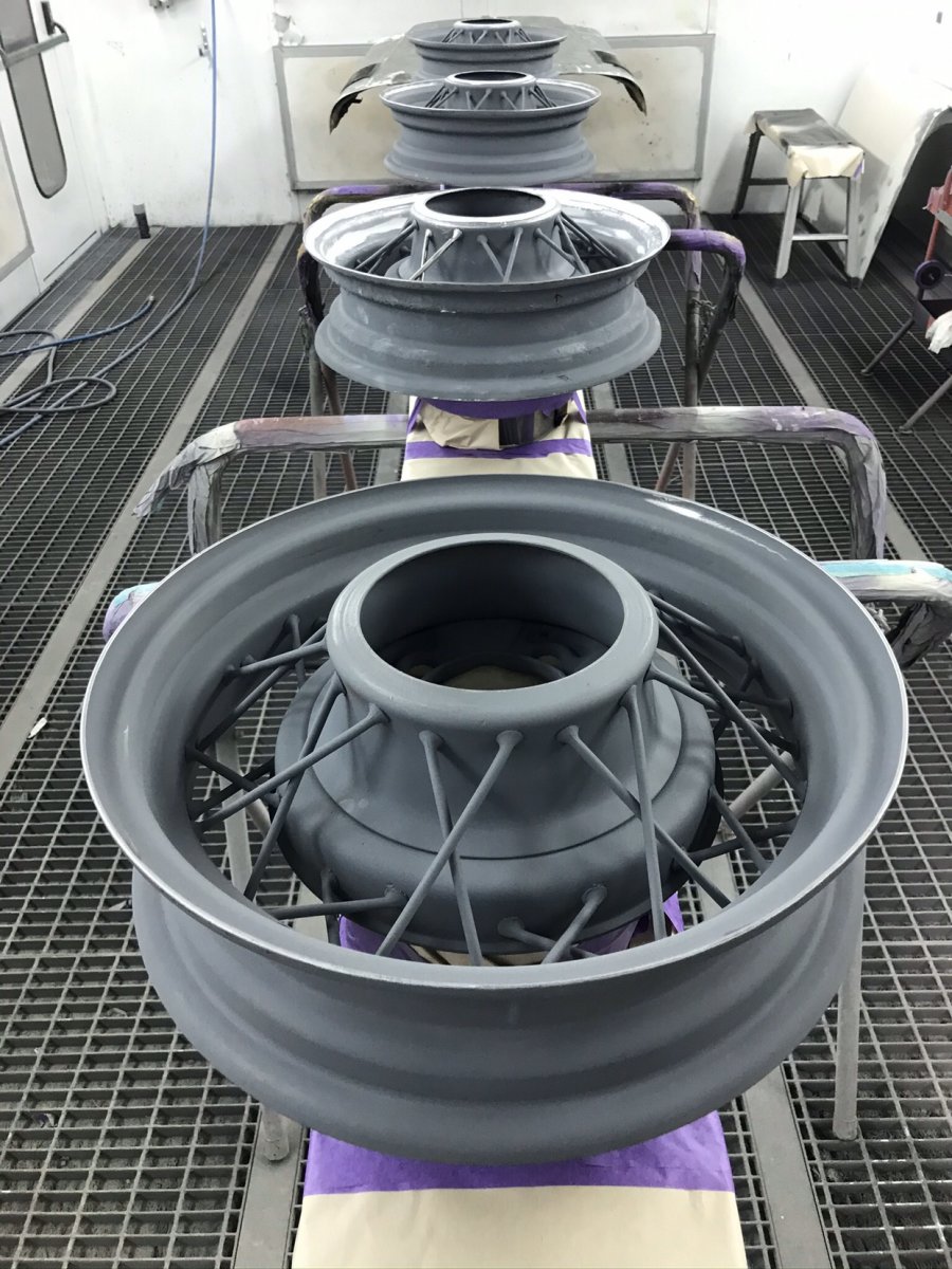

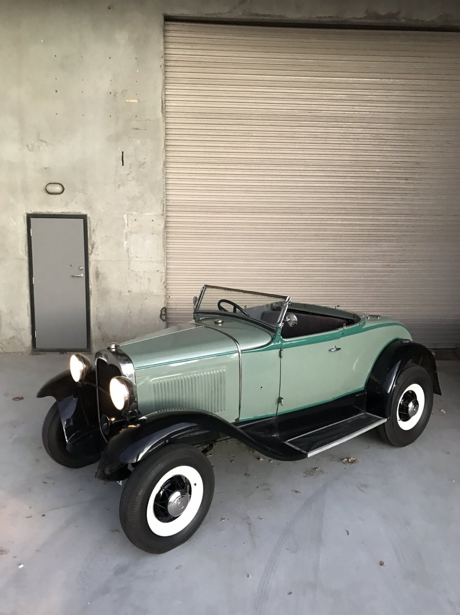

    Okay wheels- new 5.50 fronts and 7.50 rears
    Mounted on some original 35 wires. Few spoke straightening and rim lip bashing they were straight and ready for paint. IMG_4288.JPG
    Repop caps and Original Lyons white walls
    Before
    After

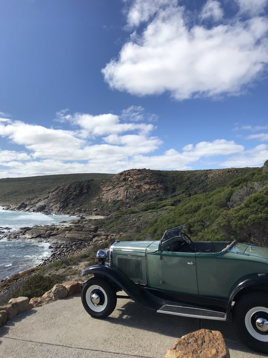

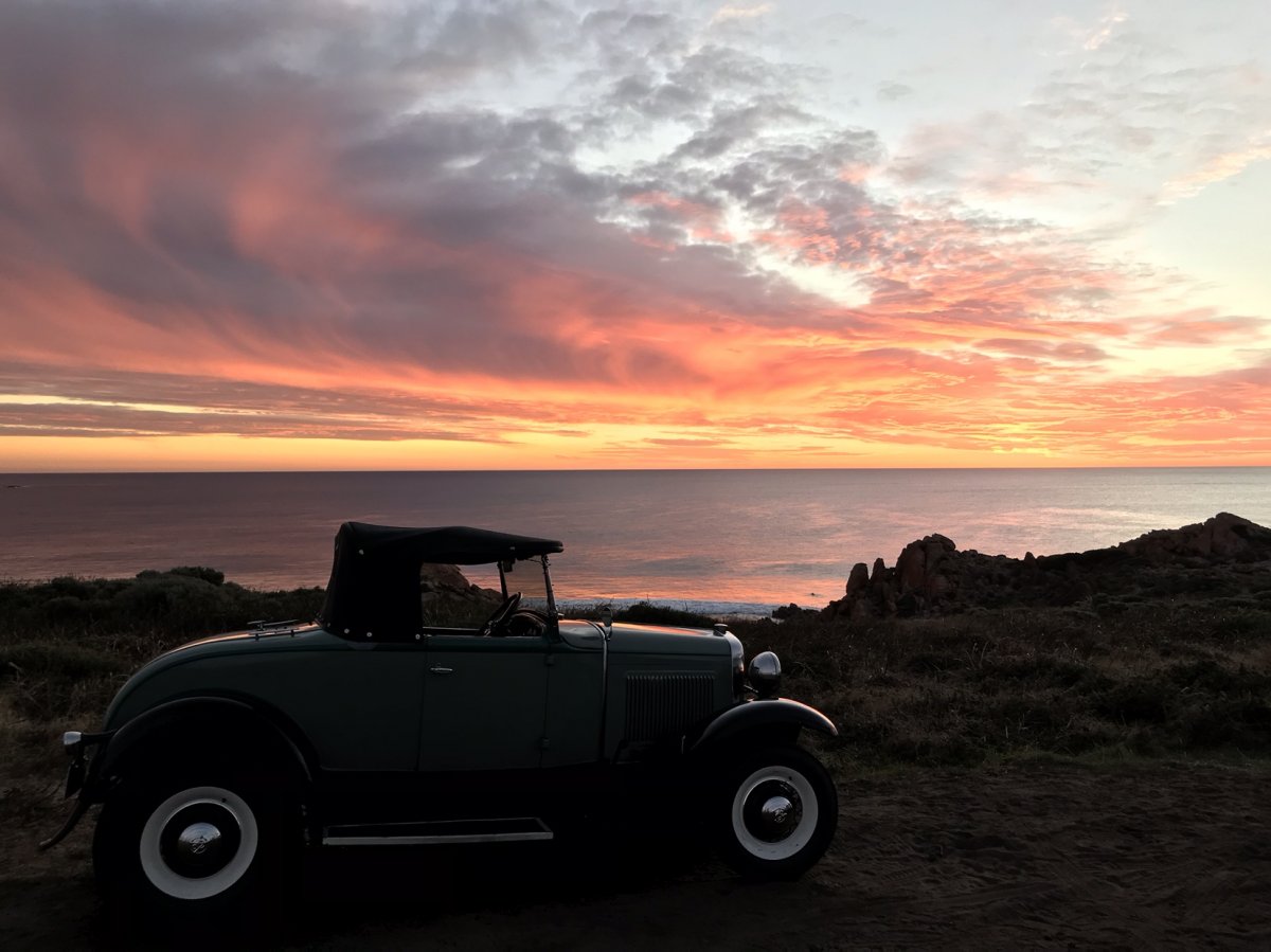

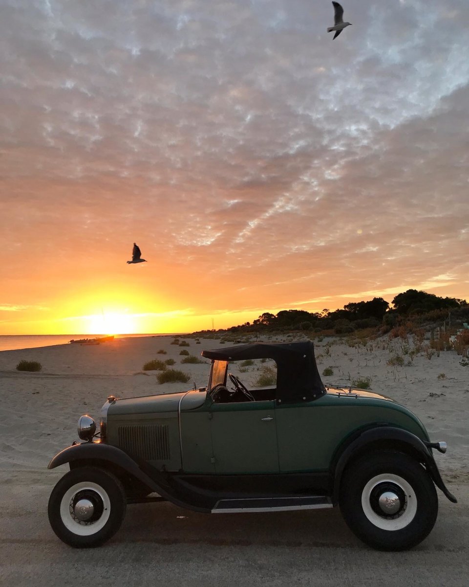

    Put the top on and took it on it’s maiden voyage.
    Didn’t sleep... new car feels.
    Watched the sunrise
    Drove around all day learning how this old works.
    There might be an extra stick on the floor making the drivability much better.. so I drove and watched the sun set.. and watched the boys surf this wedge.

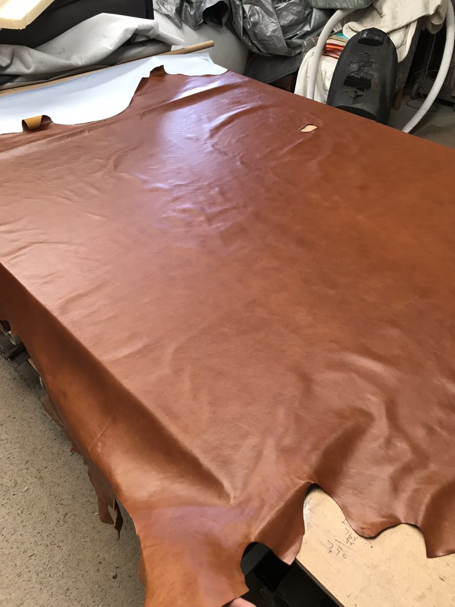

    The leather arrived this week and will take lots of photos as I tackle (with help) the seat and rumble Upolstery.

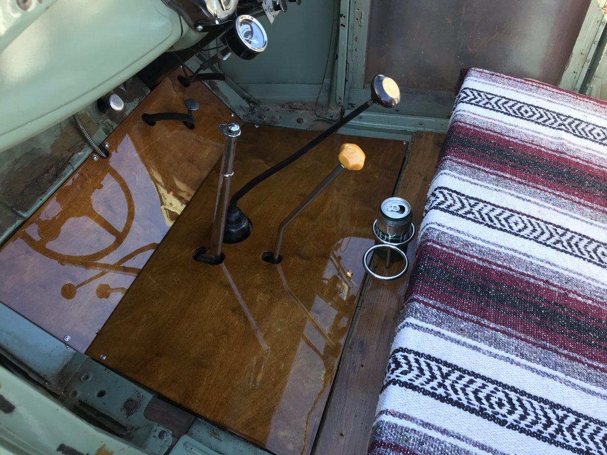

    Next was the floor, this car actually has a wood subframe and door frames- annoying but in the future I can swap out if needed.
    Adding stain and difference techniques (screw ups) it came out better than predicted.
    I then tapped the edges and applied a 2pack epoxy and let it sit for a week. Then sanded and added multiple coats of 2k clear
    I will seal the bottom and add this piece the support both pieces.
    49ratfink, waxhead, dwollam and 11 others like this.
  6. I needed somewhere to put my beer, dig around the shop found some stainless round stock and quickly whipped this up (I will add two 90deg pieces for the can to rest on.) and properly finish and polish better.
    Testing ...
    Success

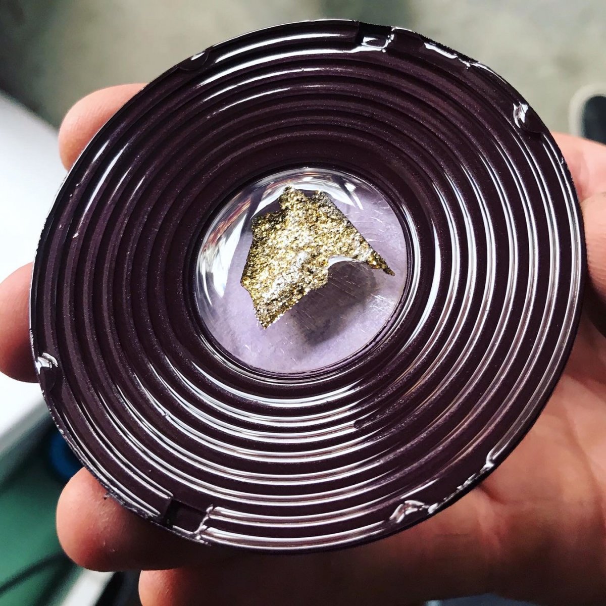

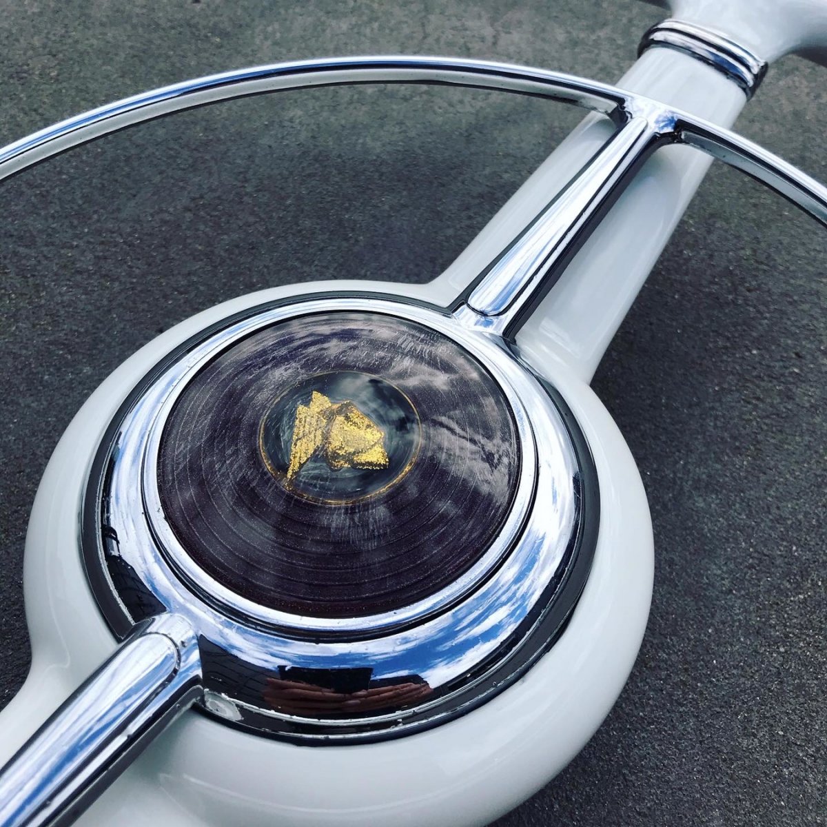

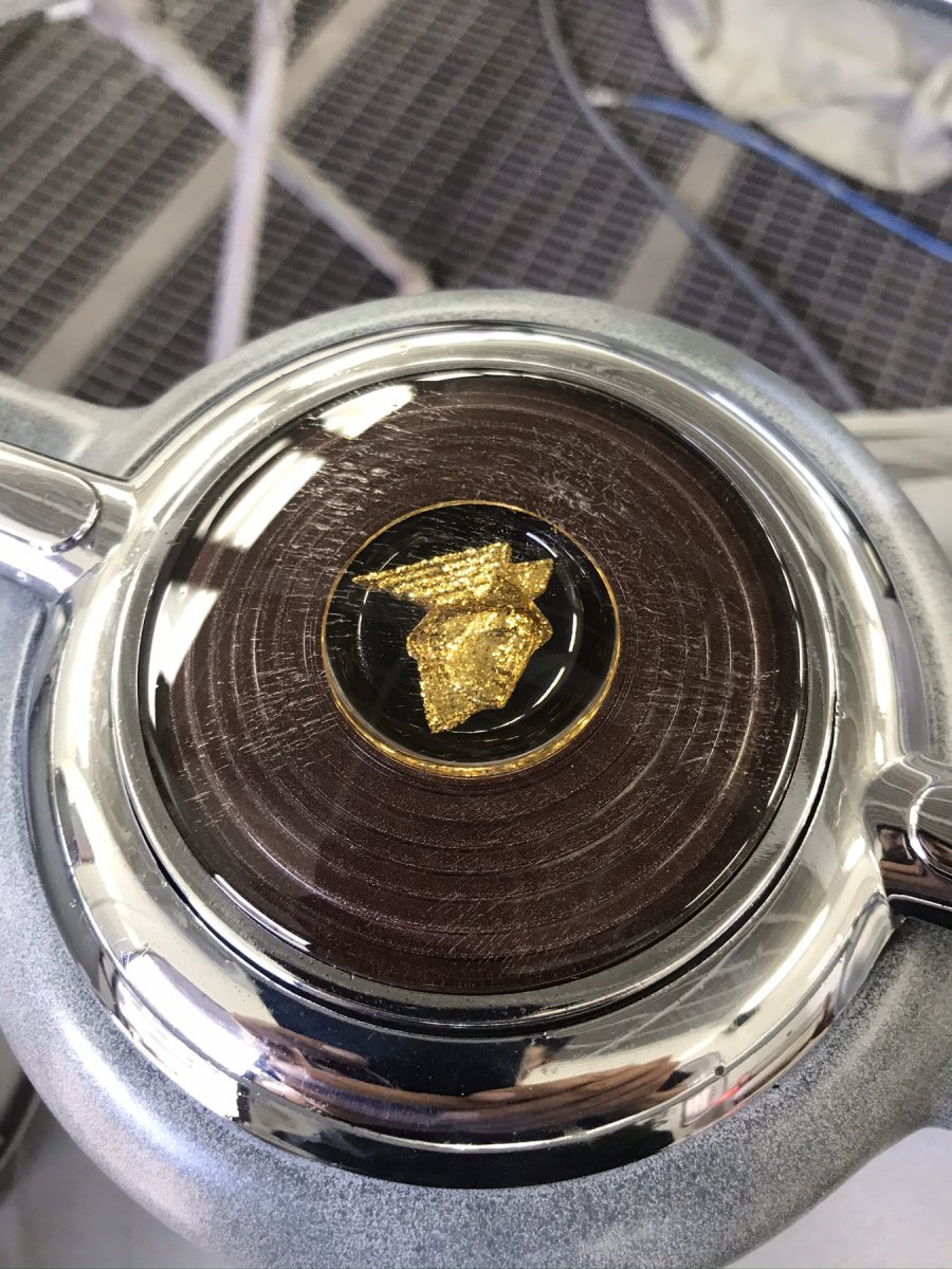

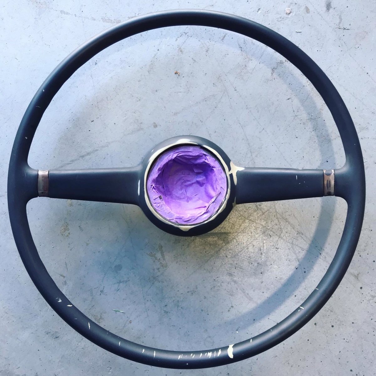

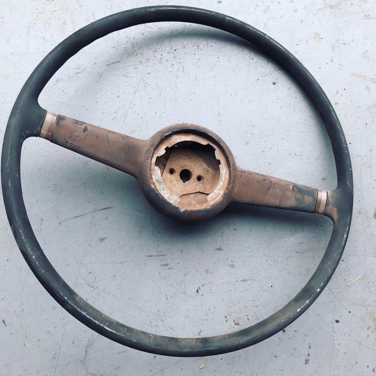

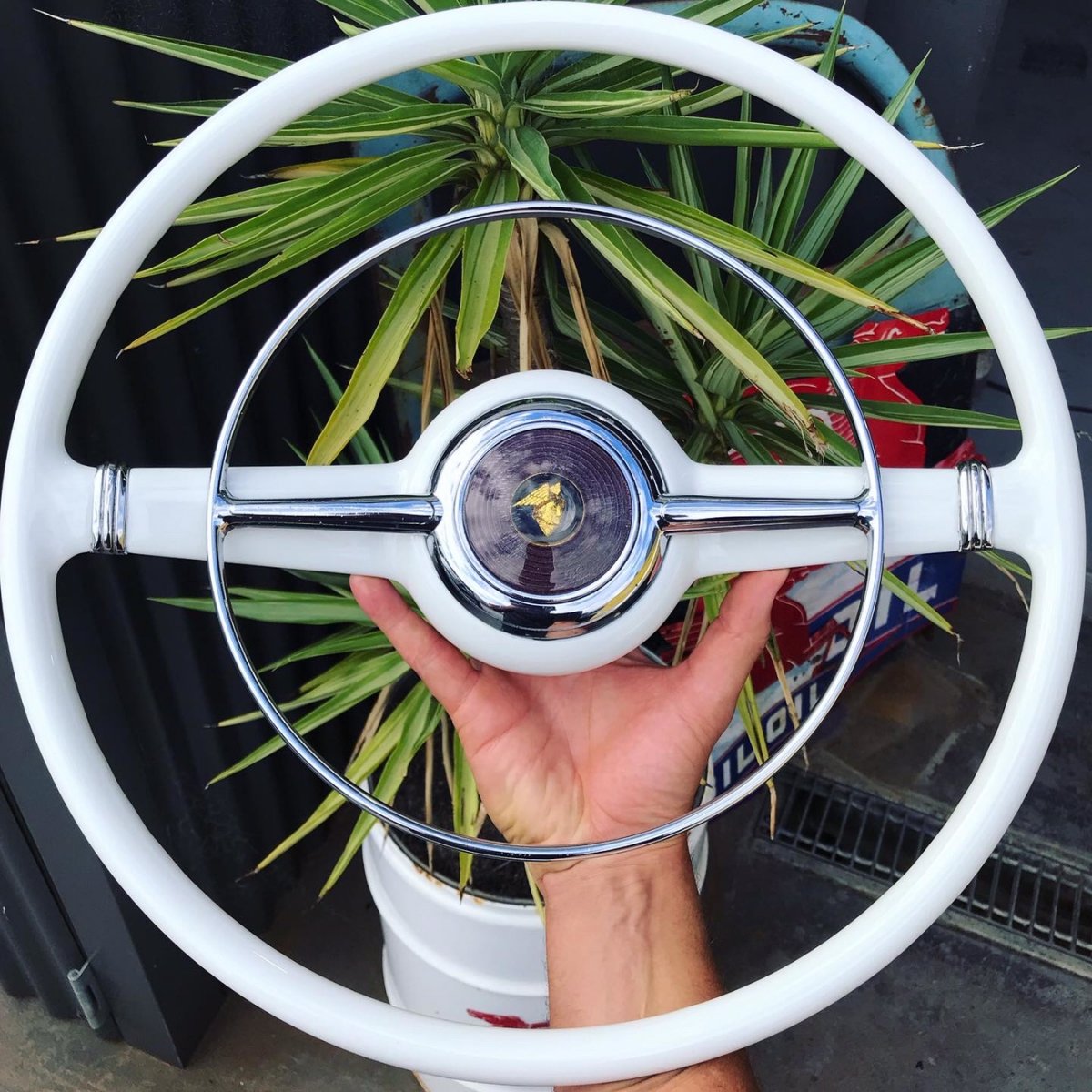

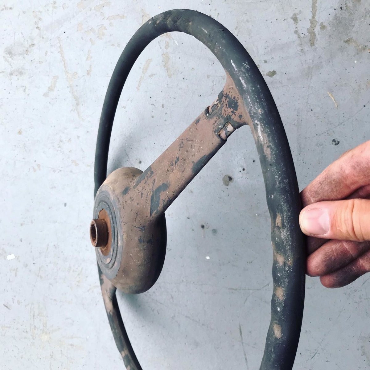

  7. I plan on running a later Merc wheel and f1 box.
    So I pulled a wheel of the wall and gave it some love.
    Used a dremel and grinned out all the cracks
    I was just screwing around with this and added gold flake to the face. Undecided still.
    49ratfink, waxhead, dwollam and 15 others like this.

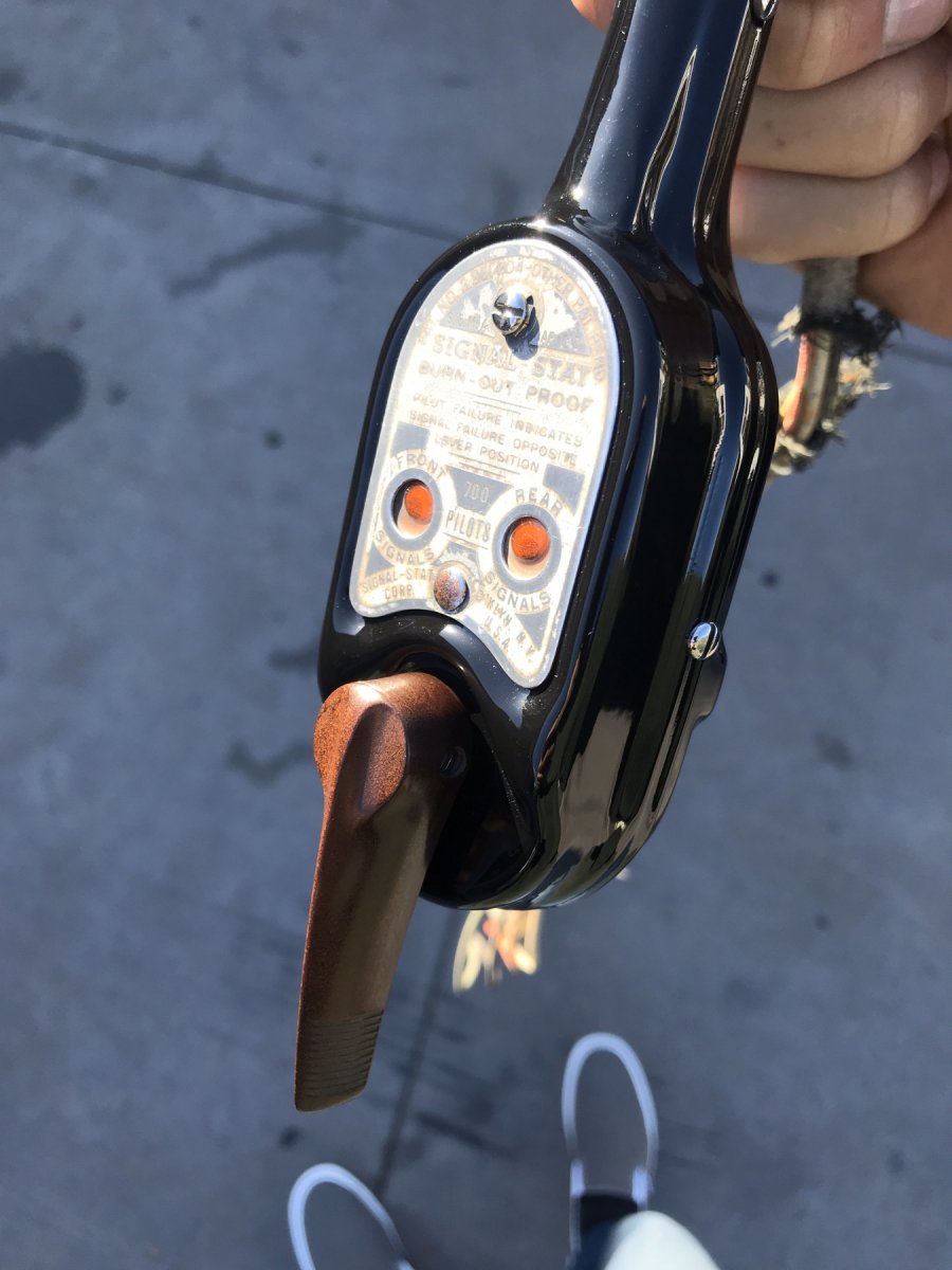

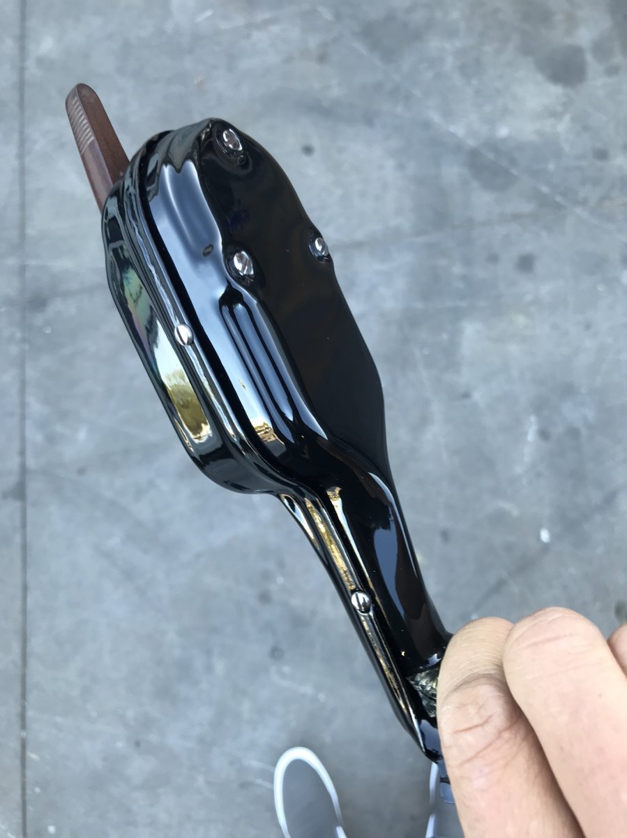

  8. Next was a Signal stat for the 39 coloum will be using.
    Painted and Bakelite polished.
    Should look nice behind the wheel. Maybe same colour as wheel?

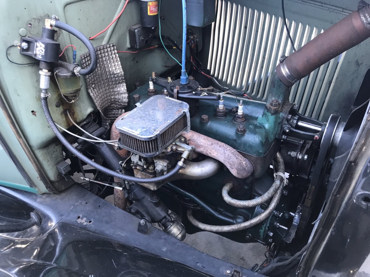

  11. The motor is this actually runs well. Now I haven’t really owned a banger as they tend to get replaced with a flat head. But I like this. It’s needs a good clean, gaskets replaced, electrical redone, electric fuel pump removed and so on. I have a stainless flange plate and will make a simple and tasteful set of headers and possibly an intake. Lots of banger reading and learning. Would love to wake this up slightly with maybe a new head and dizzy, recommendations would be greatly appreciated!
    It has a Mitchel’s splitter box that came installed from original owner. Amazing the difference it makes on the over all drivability of this, I do have a 39 box that I could possibly put in as well if it would create a bigger and better difference as well.

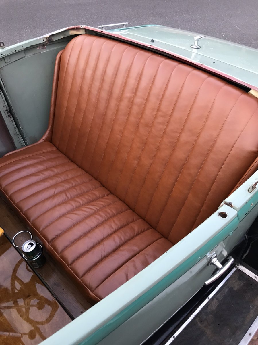

  19. My mate who’s a furniture Upholsterer helped me get this seat sorted, now he hasn’t done much automotive stuff but considering that I believe he’s done a great job, will post better photos when the rumble seats done.
