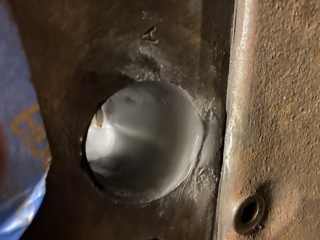

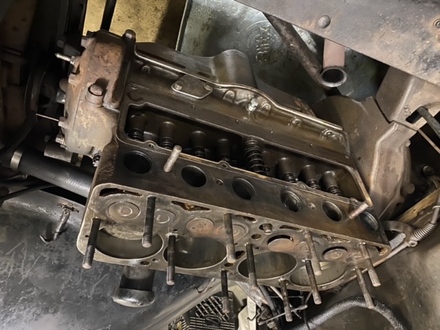

    So I found my culprit that has been feeding my exhaust antifreeze... I took down my model "B" block today to find an old repair. Someone stitched the crack and them threw a weld over the top. The stitch was not overlapped and was never properly sealed. So with what I had here in the garage, I tried to preheat, braze, and postheat only to find more cracks... I was able to cover most of the cracks and smooth it out with a bur-bit, but I am not totally confident with the fix...
    Does anyone out there know of a product that I can use to coat over the top of this. (Epoxy/Sealer???) They are hairline cracks that don't deal with a lot of pressure, I just want to run this motor till I upgrade to something later down the road.
    ***** I can't stitch where all of the cracks are.. so if it can't be brazed, I'm wondering if a epoxy or sealer will hold up to the temp.
    Anyone have luck with this, or can recommend a product??

  2. mdimages
    Joined: Sep 13, 2019
    Posts: 62
    mdimages
    Pictures

    are you left handed and taking the photos with a phone? 3950799-8c317577532ea79c978e74092e9eca6b.jpg 3950800-3cd72de5016fb85dca7c0ecf1fb60b49.jpg 3950801-6e282400af3492907a418ff38defe4e5.jpg

    The problem area is well exposed. You may consider finding a diesel engine repair/ rebuild shop. Competent shops often weld, braze or use some specialty alloy solders to repair cracked or broken cast engine components. They have proven methods
    of proper preheat to prepare the effected area for welding and to reduce oil impregnated into the
    effected areas as well. The shop will post heat to relieve stress and reduce chances of re cracking. Proper cast
    metal repair is a multi step process. You would probably have to tow the vehicle to them or bring the motor only. There is a shop here in the New Orleans area that has helped guys with these issues for many
    years. Just a suggestion, something to consider.

    I agree with you 100%, that stripping it down and taking it to a shop is the best and most professional fix. I just don't want to strip the motor down all the way and do a rebuild if I will be swapping it out down the road. it ran strong before. I would like a car this next year to putt around on. It won't be a hotrod till a couple years doe the road. just not in the cards.. I planned on building up this motor if it was a good block, so I'm glad I found this before I invested more money in it. so it is kind of a blessing in disguise...

    Did you drill a small hole at each end of the crack to stop the crack from continuing to run, before you brazed it?

    The the cracks were in places I could not get to, The place I covered had already been stitched, but not properly... More crack were seen from other places after heat applied. Some were pre existing that we not able to be seen after cleaning. Im sure the heat added to the stress.
