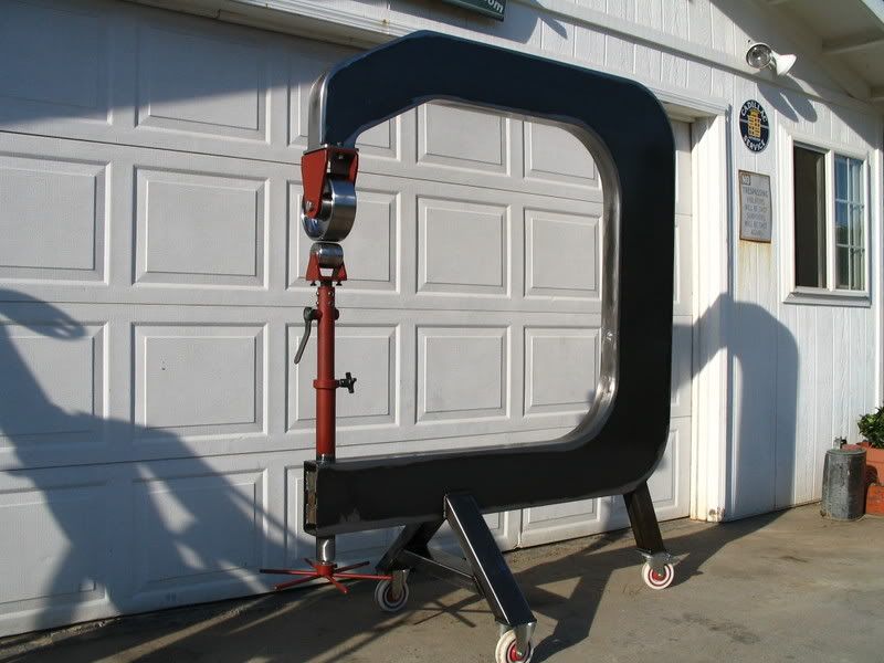

    I built mine for just under two thousand, but one this size would cost you over $6,000 from Fournier. Kinda over kill, but it was fun to make.[​IMG]
  14. [​IMG]
    This one for Joe Sulpy has a 48" throat.I think the horizontal arms are 4"x4"x1/4",the vertical column is 6"x10"x1/4",the diagonal bracing is 2"x2" The adjuster uses a Acme screw with bronze nut.
    Upper and lower yokes can be turned 360 degrees. Foot wheel is a foam covered steering wheel.Tool box holds anvils and different upper wheels.
    Total cost was well under $1000,and some time.
