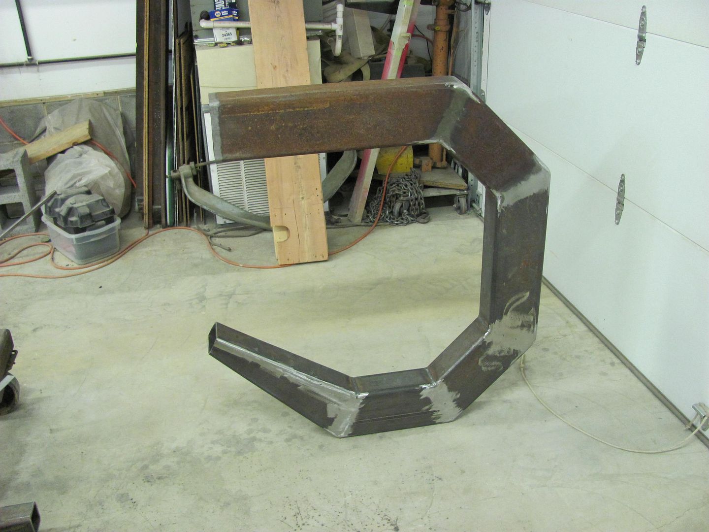

  21. MP&C
    Joined: Jan 11, 2008
    Posts: 2,254
    MP&C
    Well I finally got some time to work on the wheel. I had been looking for a good way to make some accurate 22-1/2 degree angled cuts, and just didn't feel comfortable with the accuracy using the 4-1/2" grinder with cutoff wheels. The best thing I had to work with was my trusty 12" dewalt miter saw, but all the cold saw blades at my local welding supply were only good to about 1800-2000 rpm. Some web searches and phone calls finally put me in touch with Cut Technologies in Bellingham WA. They have a cold cut saw blade that would handle the rpm's and material, so he said. At a modest $160 price tag, I was keeping my fingers crossed.
    After the first cut, the blade was still cold to the touch!
    Pieces mocked up.....
    Also needed to trim the old frame from the "kit"
    Should be large enough for most of everything I'll need it for....
    The 12" blade was just shy of cutting completely through the 4 x 6 tubing. And after all the cuts were complete, the blade had warmed up slightly, but still cool enough to grab it with your bare hand....
    The planned cuts for tomorrow...

  26. MP&C
    Posts: 2,254
    MP&C
    Here's the progress for today...
    All of the ends were chamfered to get better weld penetration, and also so I could grind the welds down for a flush look on the sides.
