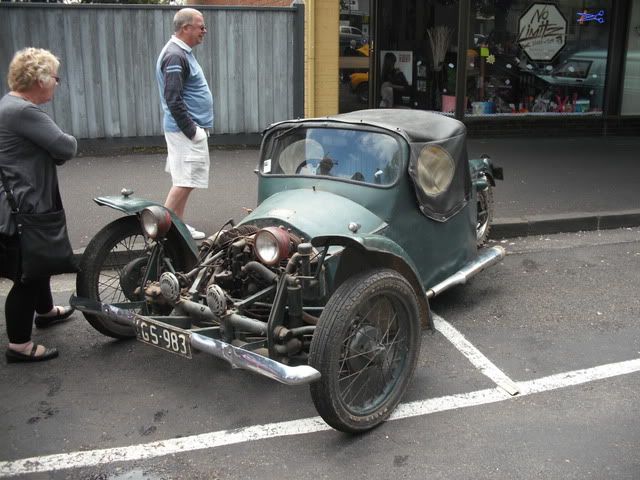

    Something like this Spark. Taken at Camperdown Rockabilly Cruise 2010.:)
    Monkey Biker, I also love that little bucket.
    Rocky.
  12. Arrrr.. sorry but no, the T bucket is the tits and has me wondering if the 10 hp can be warmed up , and the one above.....

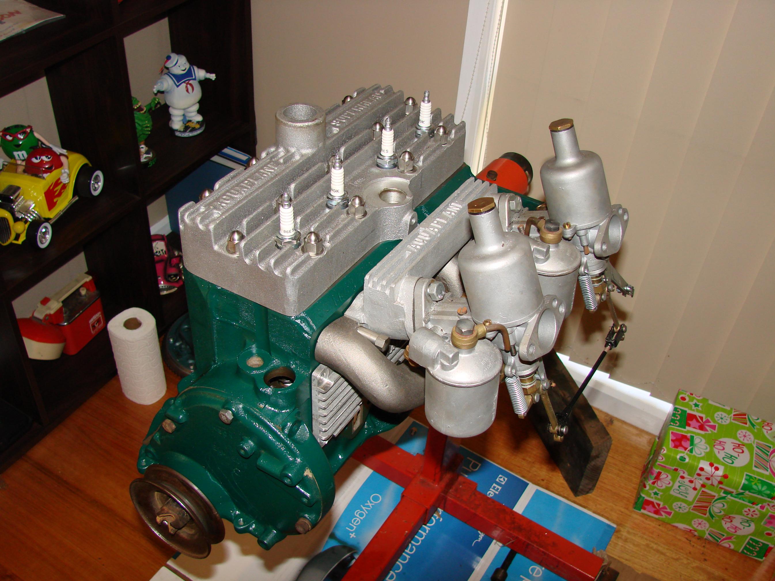

  16. RoddyB34
    Joined: Oct 13, 2009
    Posts: 543
    RoddyB34
    And they look good ,,this one is now in a 52' Anglia 2 door,,goes good ,,

    Spark, this belongs to a friend of mine here in Bendigo. My idea was to build something like this in a scaled down version on an Anglia chassis with the four cylinder done like Roddy's alum. head and twin carbs.
