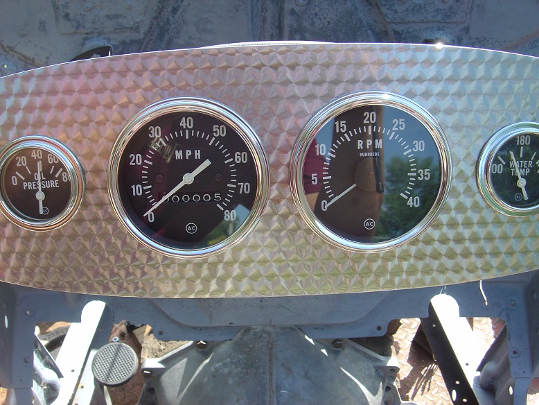

  27. I wanted to replicate the engine turn look of the original dash insert on our wagon when I added real world gauges,I love the look. HRP
    lothiandon1940 and i.rant like this.
