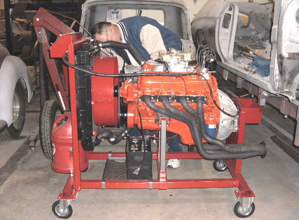

  12. Here's one.....
  13. BigBlockMopar
    Joined: Feb 4, 2006
    Posts: 1,360
    BigBlockMopar
    That looks like a well built test-stand.

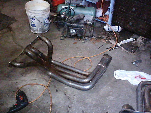

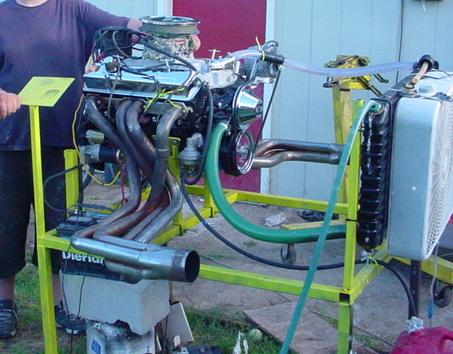

    i built one back in high school welding class.
    when i was building it i planned on making it so i could put anything on it, but i ended up making it just for chevys.
    i have broke in 3 engines on it though. and i have a trick set of big tube headers that i use with it.
    heres some pics...

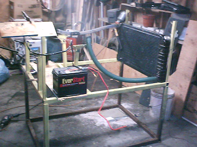

  23. 51 MERC-CT
    Joined: Apr 5, 2005
    Posts: 1,594
    51 MERC-CT
    Flathead Merc on my home made stand (dust included):) :D

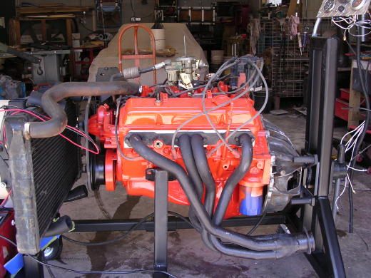

  27. This is the one I think you're talking about, Screwthe - the owner/builder of the stand is Gordy Cushman in Rockford IL, who rebuilt the Poncho in my A coupe. It's a very slick setup with an ignition / instrument panel that has tach, temp and pressure gauges...
  28. Moparhead
    Joined: Dec 2, 2006
    Posts: 236
    Moparhead
    Very nice!

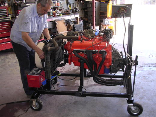

  29. 47 Tudor Guy
    Joined: Feb 19, 2006
    Posts: 345
    47 Tudor Guy
    I finally got around to getting some pics the other day. Here they are. Better late than never, hey??? :eek:
  30. 47 Tudor Guy
    Posts: 345
    47 Tudor Guy
    Another Shot....
