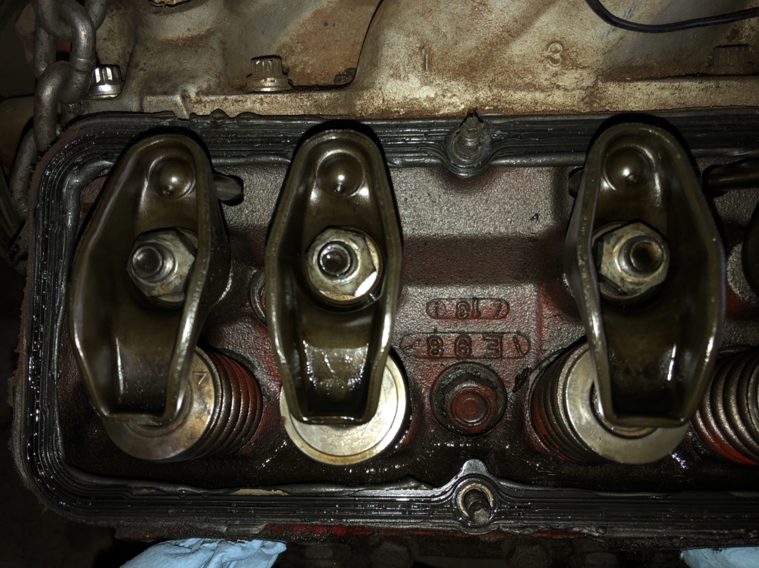

    Sorry the response has been so late but I’m trying to be better about not leaving threads dead. I found out it was a 1969 327 with camel hump 461 heads, and in taking the valve covers off I found a very clean set up! [​IMG][​IMG][​IMG]
    Deuces likes this.
  17. Deuces
    Joined: Nov 3, 2009
    Posts: 23,921
    Deuces
    Do you plan on taking the heads off????...
    I would love to see those chambers and intake ports.... :)
  18. squirrel
    Joined: Sep 23, 2004
    Posts: 56,085
    squirrel
    May 9 1963 casting date on that head, eh?
  19. cody ellingson
    Joined: Dec 28, 2017
    Posts: 76
    cody ellingson
    You know I’m not 100% sure yet. Originally I was going to and do new head gaskets and check the overall condition of the motor, but haven’t decided yet. I’m sure I will get to it eventually here. This winter is going to be gathering parts to do the swap next winter. I plan on running the 235 until that time.
