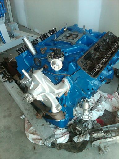

    IN FACT, the 390 will even have "352" cast into the front of the block on the right hand side just below where the intake and head meet. The only sure-fire way to tell the difference between a 352 and a 390 is to measure the cylinder diameter and depth. They used the same block, same heads, same intake. Has your intake got an oil fill tube toward the front of it, pointing off to the passenger side?
    Below is a 1972 FE 390 (+0.040) with a 1964 Thunderbird FE 390 4V intake. Everything interchanges despite the fact that the D2TEAA cylinder heads were made eight years later than the rest of the engine.
