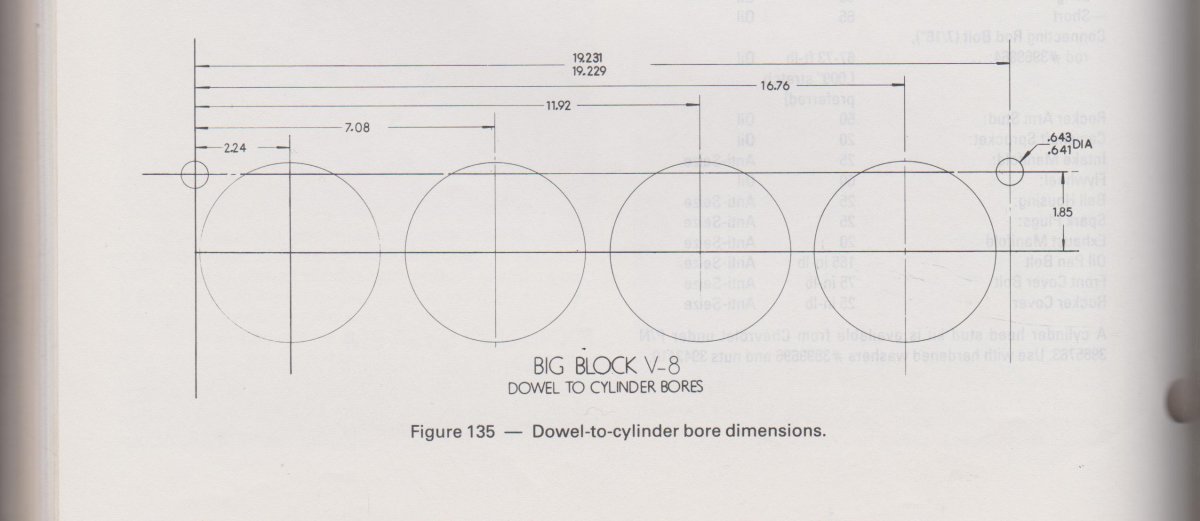

    Chevy BB front.jpg Thought it would be a good idea to start a thread that contained drawings with engine dimensions. If any HAMBers have some, please post them.

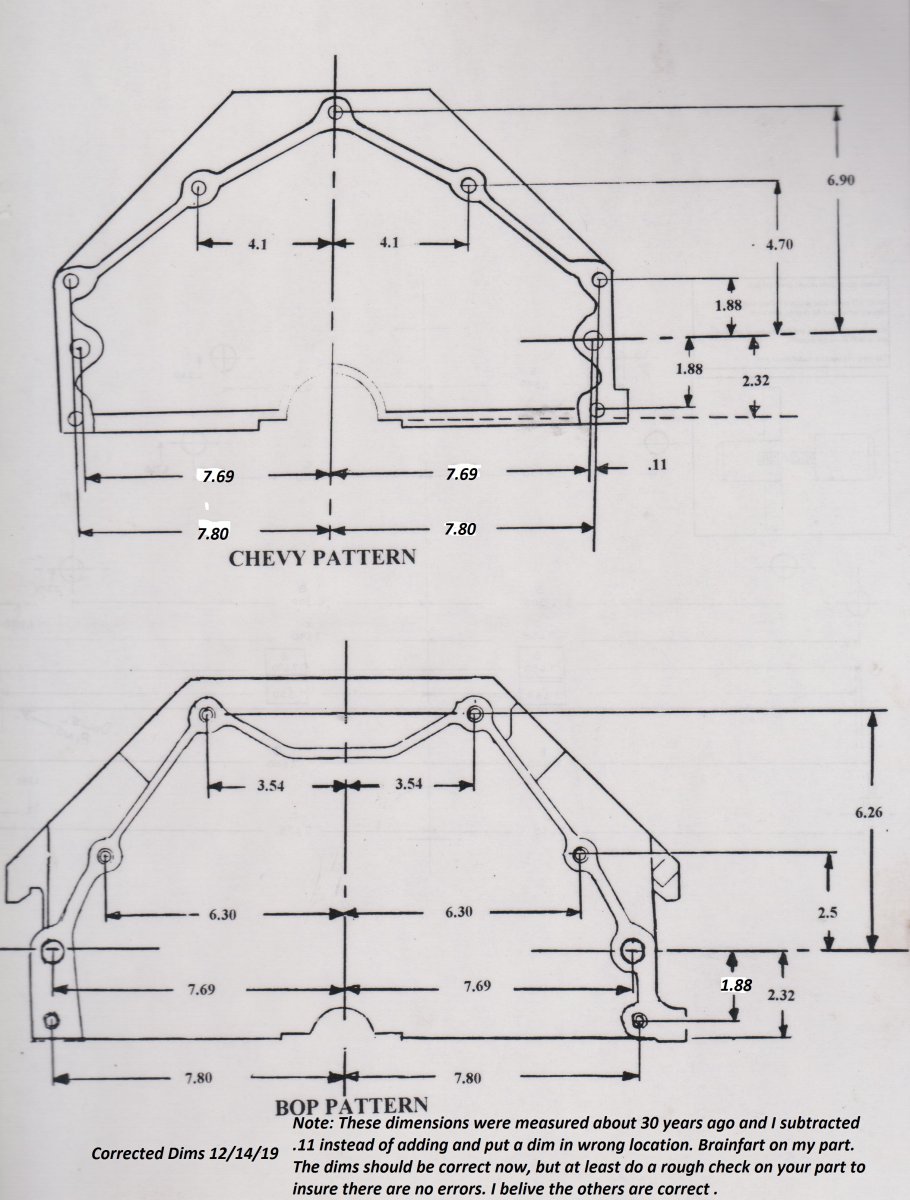

    Bellhousing Dimensions Corrected 1 001.jpg Here are some Bellhousing Dimensions that were taken from actual bellhousings rather than factory drawings, so there may be some variation. Note: I had a couple of errors in first dwg and Thanks to Hnstray for catching them and pointing them out. These were done at work about 30 years ago, so I apologize for the Brainfart on such a simple drawing............

    @ekimneirbo ......The last two, Chevy and BOP, I believe have errors as posted. The locating dowels on both should have the same horizontal spacing .....yet they are shown as 7.69” for BOP and 7.58” for Chevy, if I am reading the diagrams correctly.
    Likewise the bottom bolts should also be the same spacing for Chevy and BOP......yet, the BOP indicates 7.80” and the Chevy 7.69” (all in reference to vertical centerline).
    Also, vertical spacing from bottom bolts to locating dowel centerline should be same for BOP and Chevy, but are shown as different.
    It has long been my understanding those are shared dimensions and only the bolts above the locating dowels differ between BOP and Chevy patterns.
    Am I missing something here?
    Ray
    ekimneirbo and squirrel like this.

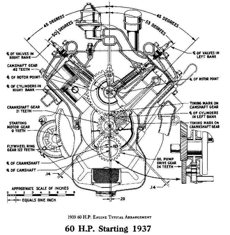

  8. 1st gen Chrysler Hemi (331/354/392):)
    Bleach, ekimneirbo and lothiandon1940 like this.

    Thanks for catching that Hnstray. They were some old drawings I made many years ago while sneaking the bellhousings into work and trying to check the locations without the boss coming in unexpectedly. We had precision inspection equipment so have no idea why I screwed it up........but I did.

    OK, I think I can wriggle part way out of the two mistakes I made on the BOP bellhousing dwgs. First one is the one HNstray mentioned about the 7.80 dimension vs the 7.69 /7.58 dim. Both BOP and Chevy should have 7.69 for the locating pins. Then I should have added .11 to that for a7.80 on both patterns. So they are the same as Hnstray said.
    I even went out and put a Chevy bellhousing on my 500 Cadillac engine to verify it.
    The 1.61 Dimension on the BOP bellhousing pattern is a little different story though. Even though the bolt holes below the alignment pins on my Chevy bellhousing align with the Cadillac bolt holes (1.88 dimension), there apparently were some differences in some of the BOP housings depending on what engine they were on. I measured an actual bellhousing, so I couldn't figure how I came up with the 1.61 dimension 30 years ago. So I found that Wikipedia says this: Though the pre-3800 rear-wheel drive (RWD) V6 uses the Buick, Oldsmobile, Pontiac (BOP) bellhousing pattern, an oddity of both the front-wheel drive (FWD) and RWD 3800 V6 is that although it is a 90° V6, it uses the GM 60° V6 bell housing (Metric Pattern). For use in the FWD applications, the bellhousings on the FWD transmissions are altered slightly.
    I have a factory drawing of the rear of the Buick 3800. If you subtract 2.96 from 4.57, the result is 1.61 which co-incidentally is what I measured at the time.
    So the best that I can come up with is that the bellhousing I had at the time had the complete BOP dimensional pattern except for the two bottom bolt holes. ;)
    Hnstray and Bleach like this.

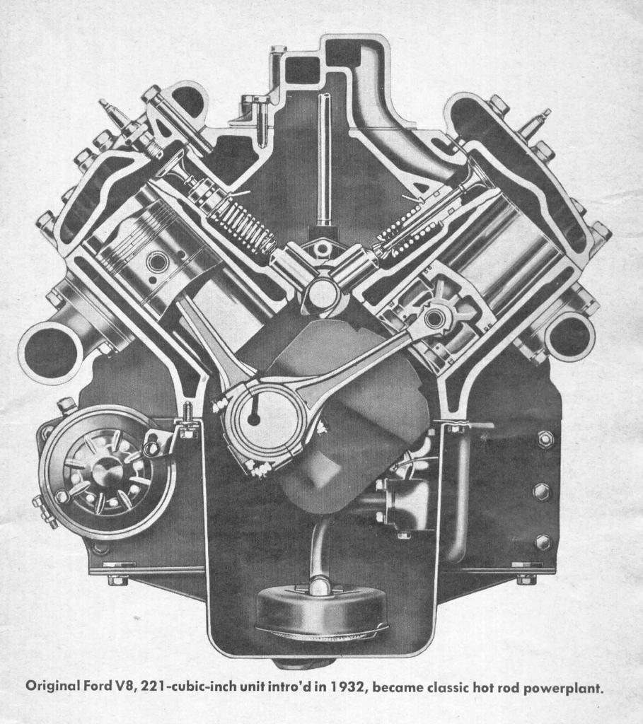

    ekimneirbo likes this.
