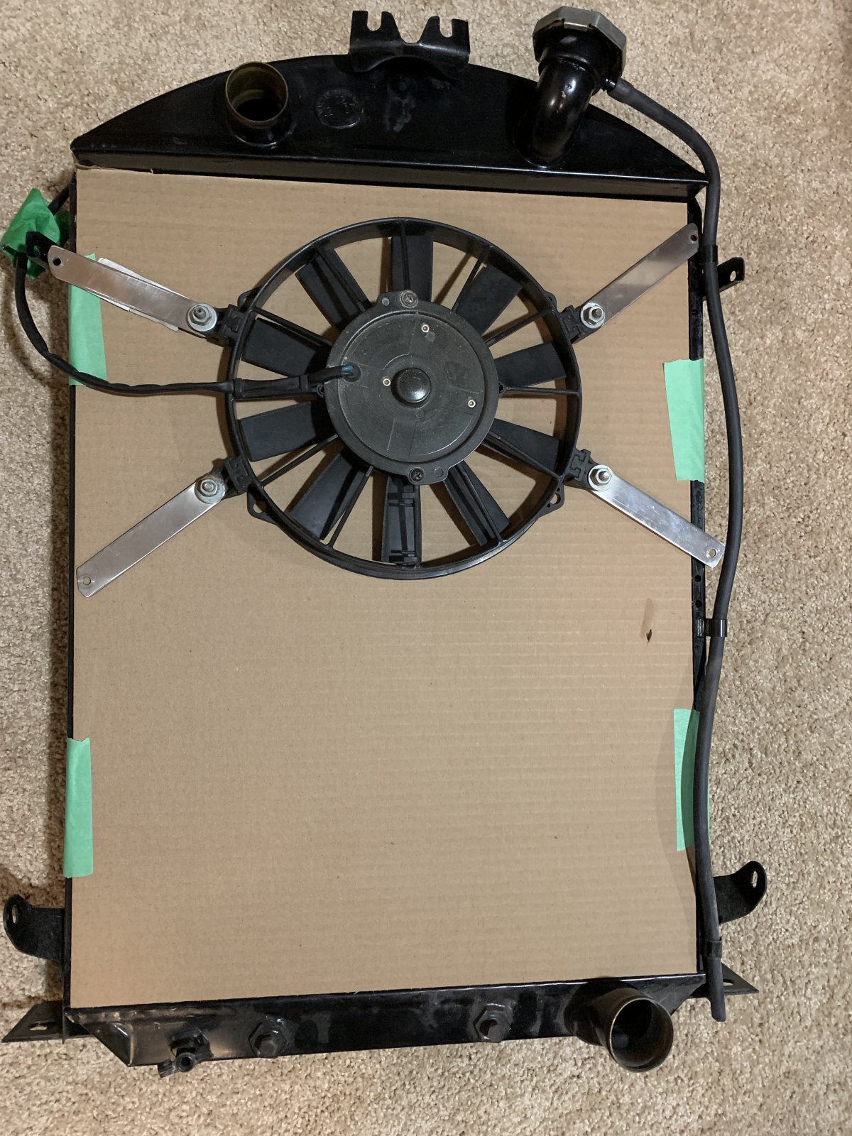

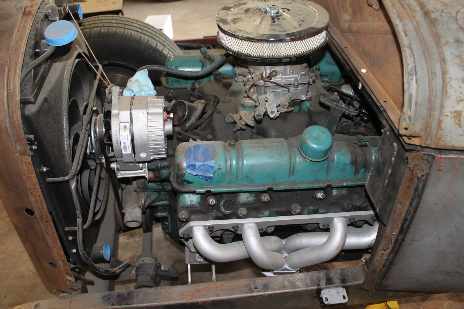

    This is what i was planning to install if the shroud does not work. Cooling components makes a shroud with a fan that fits the 32 radiator but it hits the pulley. I might be able to modify the unit and move it up to clear the pulley. I just wanted to get as much info i can so i can decide what to do.
    It's a lot of work just to mount the shroud. I need to drain the cooling and remove the lights and undue the wiring to remove the radiator. Don't want to do that more than i have too.

    I plan to mount the old chrome fan . I only bought the other fan because all other fans i look at would not clear, i needed a thin fan. And yes as soon as the car starts moving the temp will drop fast.

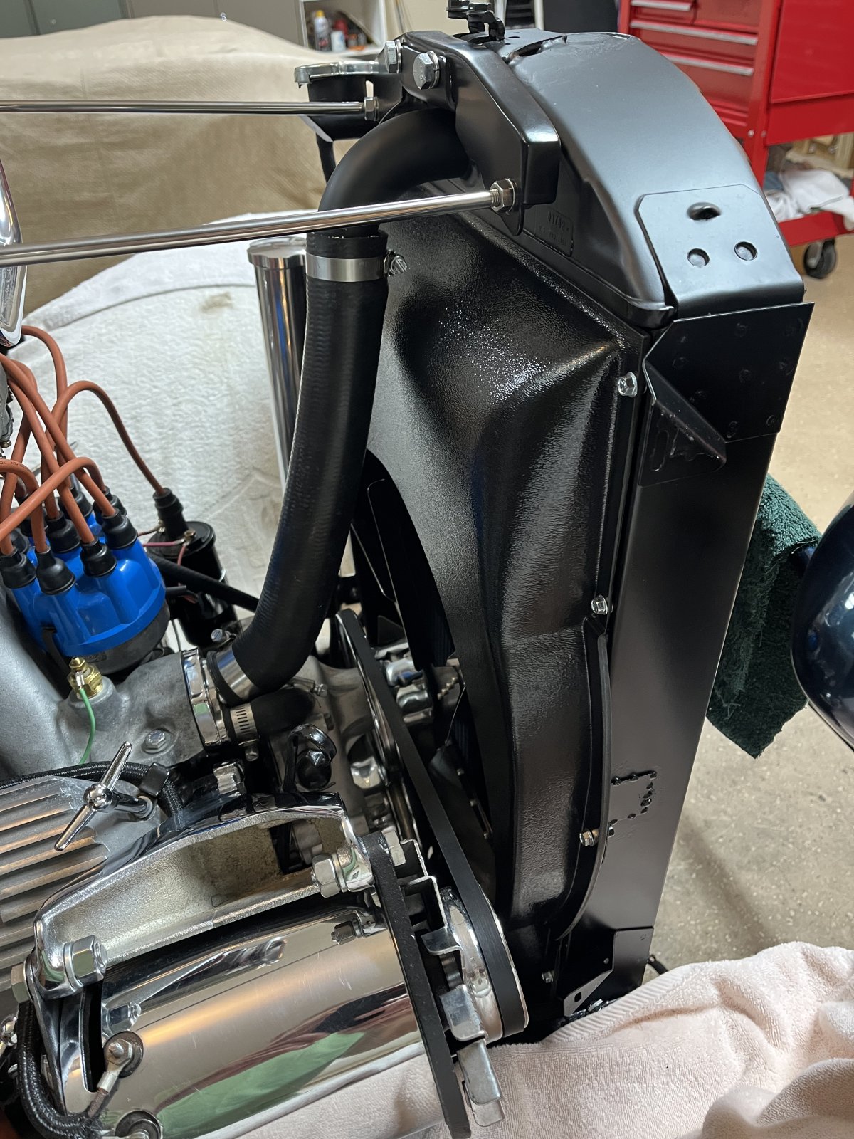

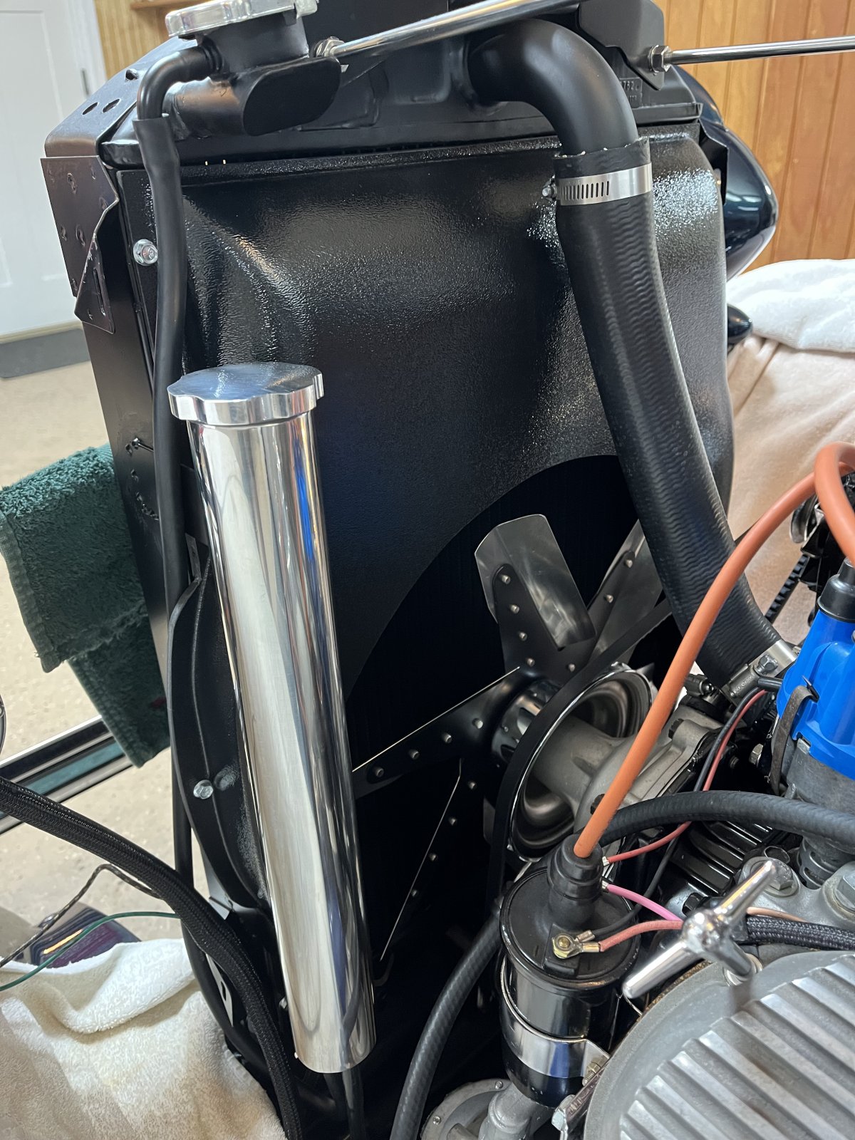

    Finally had some time to install the fan shroud .
    I also installed an over flow tank. I should have it back on the road this weekend.

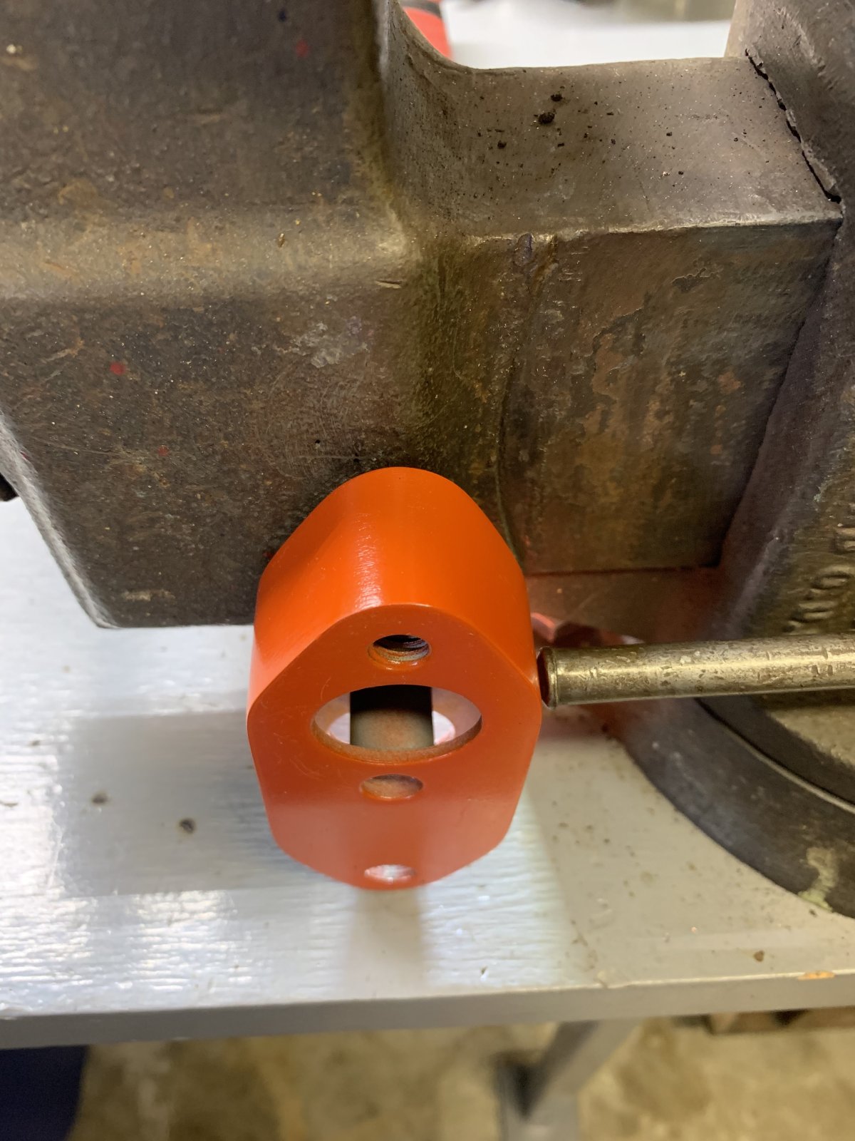

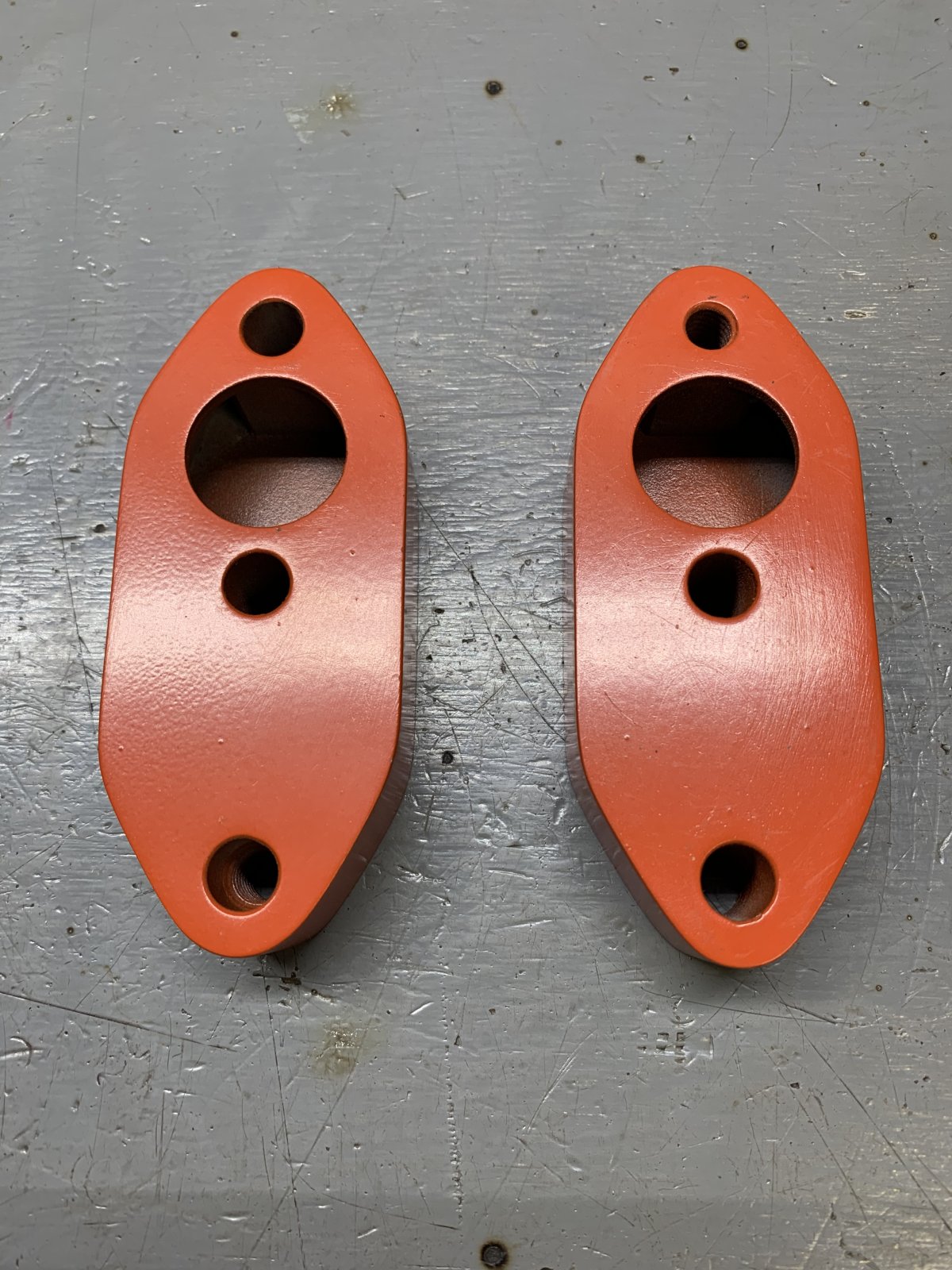

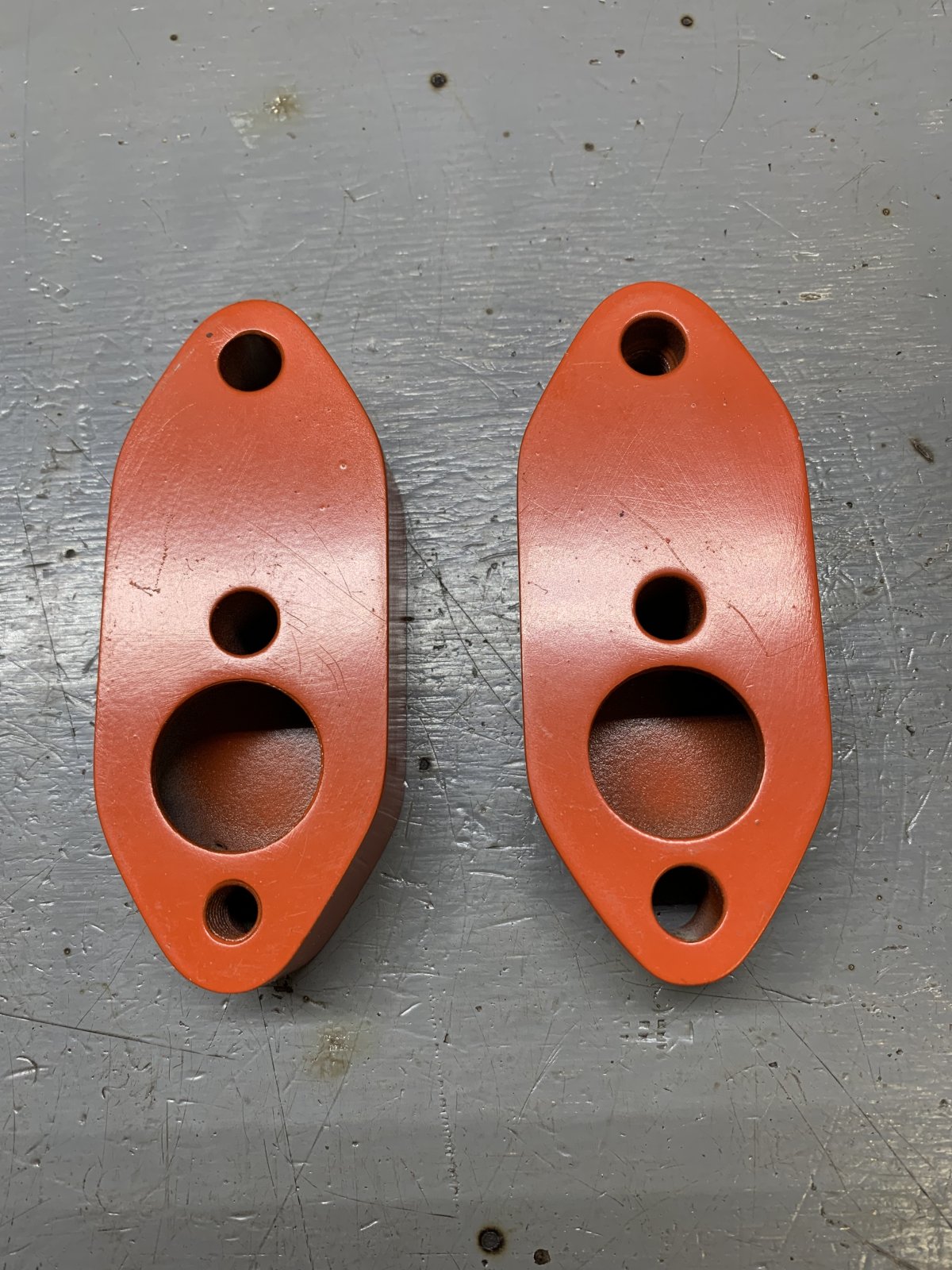

    On another site a fellow posted pictures of how he inserted a tube or pipe into the waterpump fitting for the heater hose so that it reduced the size of the fitting hole. He said that his waterpump was pushing less coolant thru his radiator because it was bypassing thru the large heater hose passage where it was not being cooled. I wonder if a simple test like disconnecting the heater hose and putting a rubber cap over the fitting, held by a hose clamp might produce a different result while idling.
