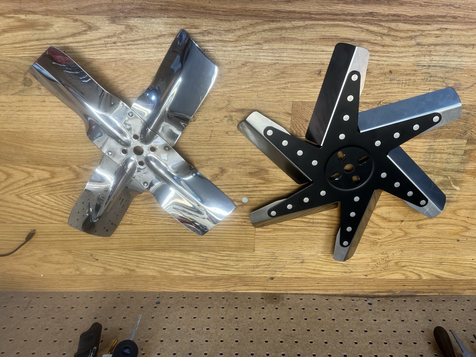

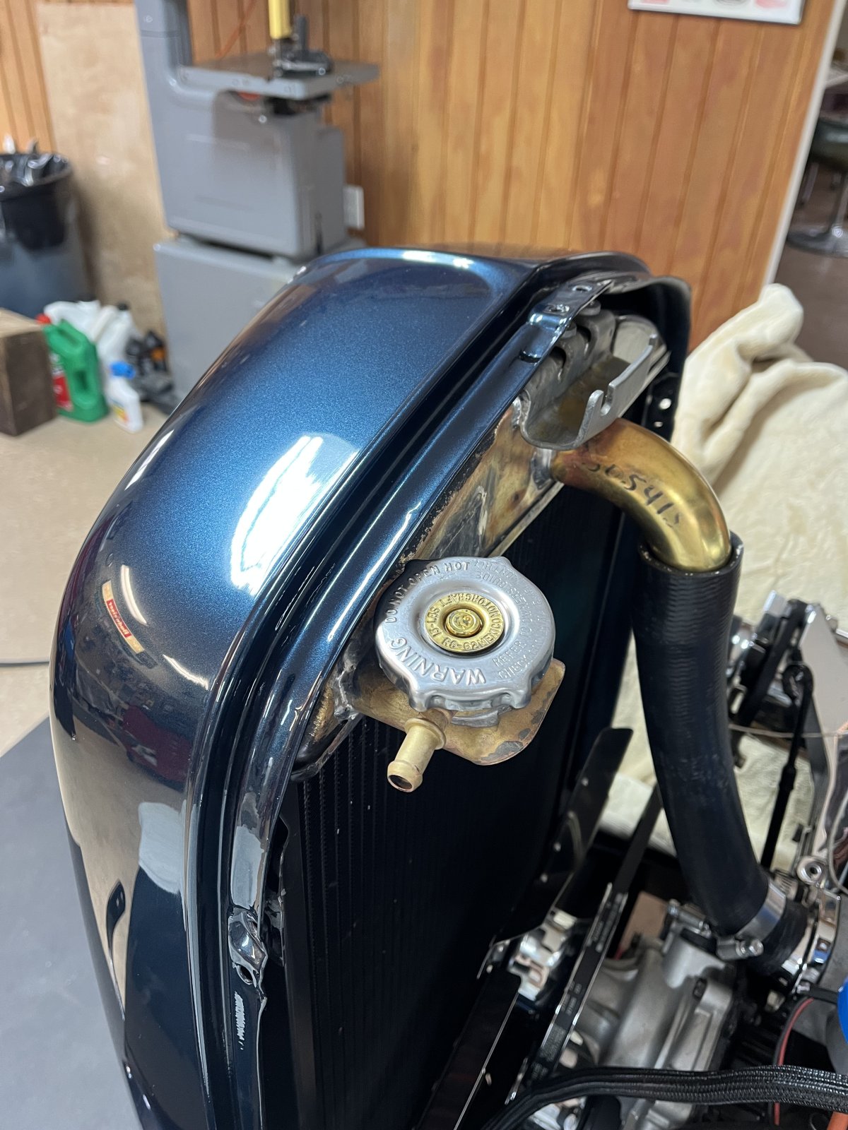

    I am trying to fix a cooling problem on my car . The temperature hits over 220 only if the car is not moving for a few minutes. I flushed the block twice.
    Replaced the 1932 ford 4 cylinder radiator with a new four core unit from US Radiator.
    I planed to fix the old radiator but it was patched and changed so much over the years and was a mess.

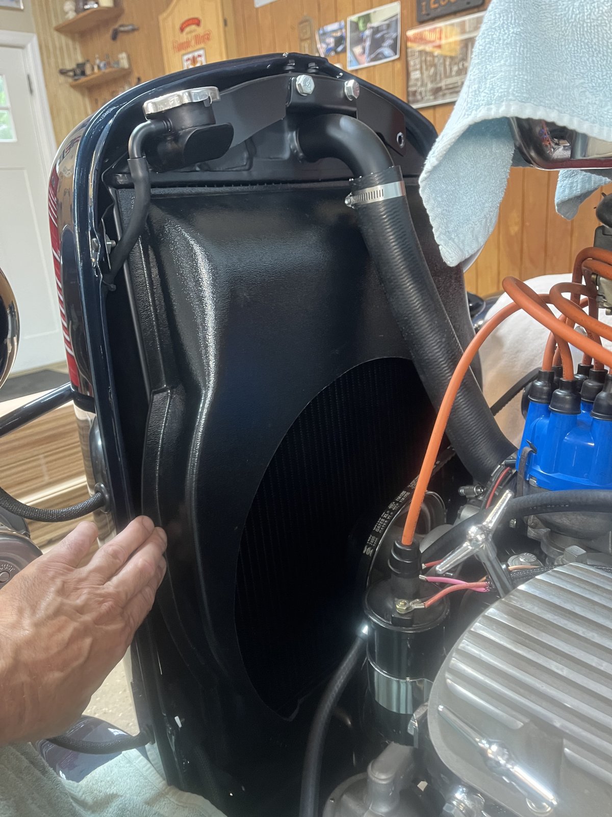

    I am now installing a radiator shroud. My car came with four blade fan that the builder had cut down to clear the cross member and he chromed it.
    I also have a new six blade fan that will fit. Will the six blade fan move more air?
    I like the look of the old blade and would like to use the old blade.
    My thought is with the shroud both fans will move enough air.
    Thanks for all the help. Ron IMG_9078.jpeg IMG_9658.jpeg IMG_9656.jpeg IMG_6004.jpeg

    6 blade should move more air, won't hurt and the shroud should help.

    Your 6 blade fan looks like a "flex fan", they don't move air for chit in my experience. They are designed to flatten out and reduce drag on a race car which is the opposite of moving air. I'd try a larger factory fan off an a/c car, and check your gauge as others mentioned. Shroud will definitely help. Running 210/215 is about perfect for a cruiser IMO so you're not too far off as long as it stays steady. I've had a brand new autometer gauge read 20deg off at the hot end so verify actual temp first.

  7. Try using a '55-57 Chevy HD steel 6-blade fan in addition to the shroud.
    You can buy a new repro one, which looks more correct than the flex fan you have and you can trim the tips if needed to clear the radiator hoses.

    That Flex fan is pretty much a race only ,
    They donot pull much,

    Without a shroud a fan some distance away from the radiator will mostly just circulate air behind the radiator - it's easier to pull air in from the side between the fan and the radiator, than pulling air in through the radiator. Some air will come through the radiator right in front of the fan, but a lot will be coming in through the gap on the sides.
    Nature is lazy, if you give it the opportunity to do things the easy way it will.
    The shroud will force almost all of the air the fan moves to be drawn in through the radiator, and spread all over the entire radiator, not just the spot in front of the fan. I'm betting that the shroud will fix, or at least vastly improve your overheating standing still situation. Get it done and see if anything more has to be improved.

    I can only fit a 15" blade , any larger it will hit the crossmenber
    jimmy six likes this.

    The fan is at the lower section of the radiator i can't change that. I am hoping the shroud will force more air through the radiator to fix the issue. I will post the results after i get this job finished.
    ekimneirbo and dana barlow like this.

    Looks like your fan (w/o shroud) is too far from the radiator. With a shroud, and the fan sitting right in the opening, it will probably cool better. Ditch the flex fan. They're crap. You could always mount an electric pusher fan high on the front side of the radiator to cool the top (hotter) part better. looks may suffer...

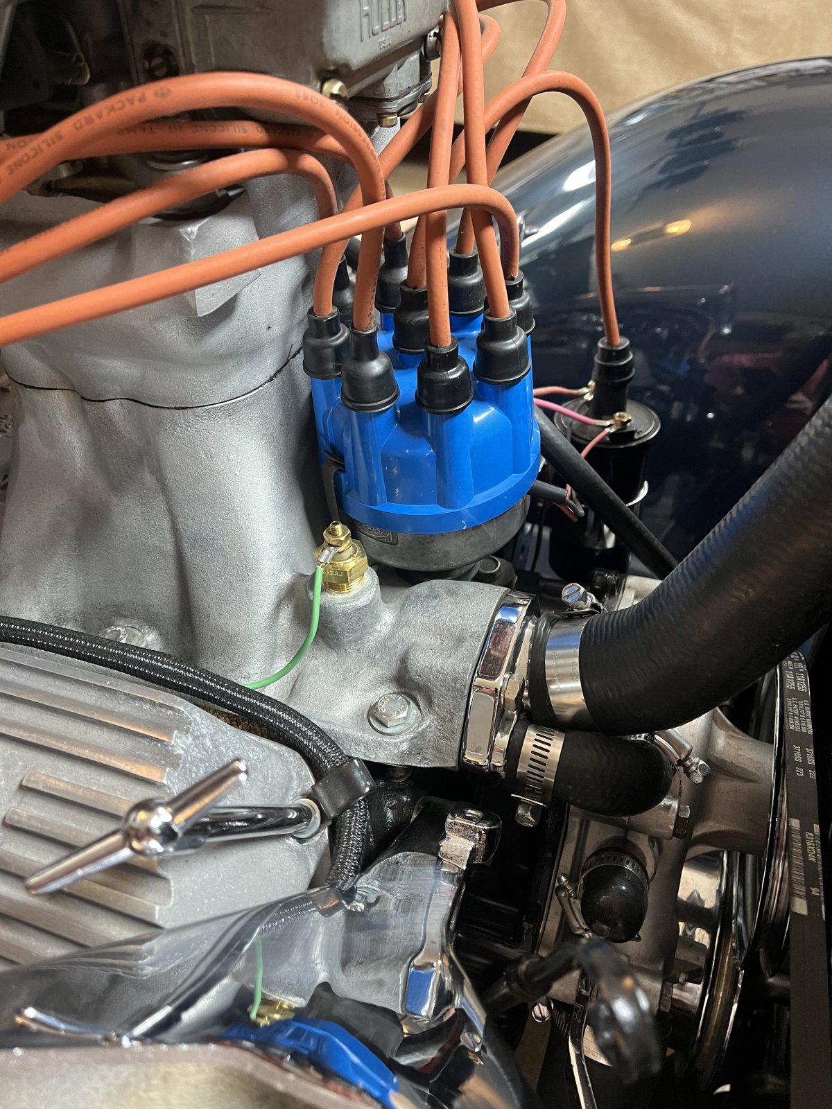

  27. If the temp. sensor is in the head it will read a little higher. I like putting them in the intake near the thermostat. My thinking is that its awful close to the exhaust for an accurate reading, especially when sitting/idling. I’ve also been told I’m full of it but that’s another story……

    The sensor is in the intake behind the thermostat

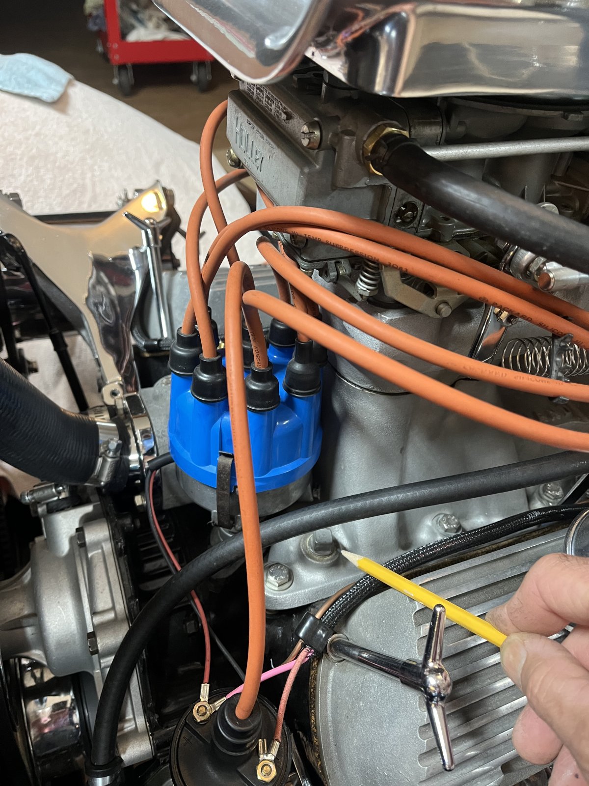

  30. ModelARon
    Joined: Jun 14, 2017
    Posts: 363
    ModelARon
