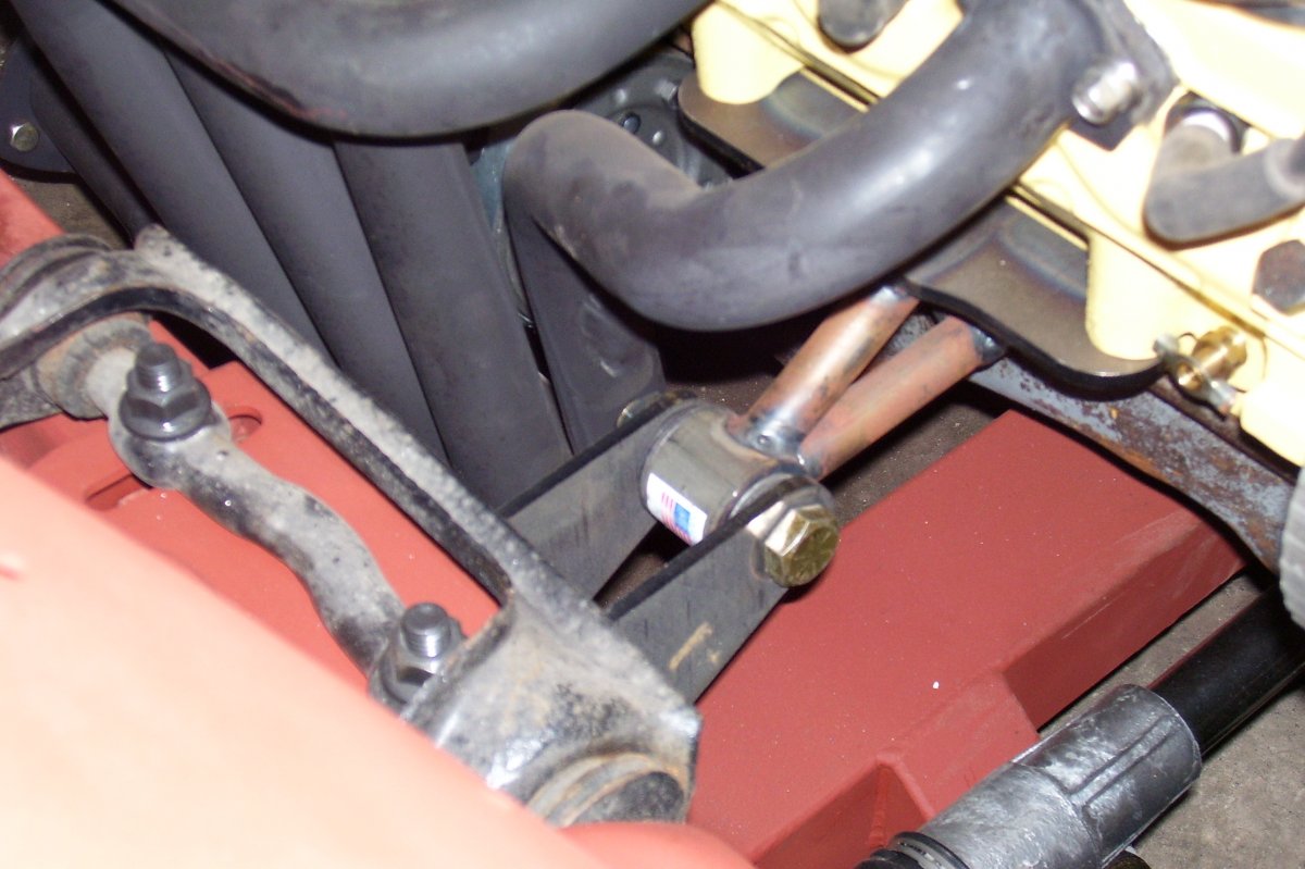

    Jim Weimer Rod Garage MII crossmember and the pan is a 5.0 Fox body Mustang pan.

    More recently I used a SBC 350 in my 1960 F100 with a Industrial Chassis Inc Dakota IFS.
    That worked out pretty good, but was my 2nd choice as I had intended to install a SBF 302, but I discovered issues with the Ford oil pan and the IFS, whereas the SBC was much easier to accommodate.
    I do have power steering with the Dakota IFS which is pretty nice.
    Some of the stuff I've done can be found in this thread I started a number of years ago.
