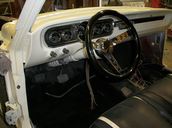

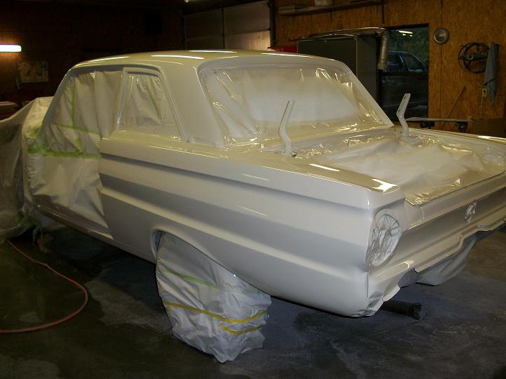

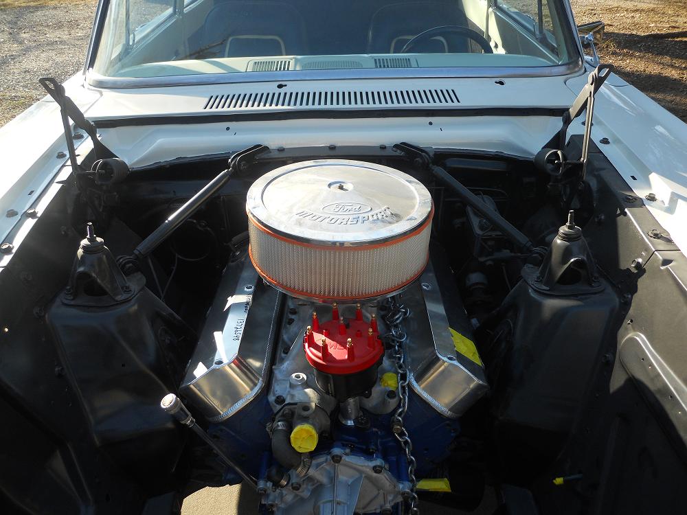

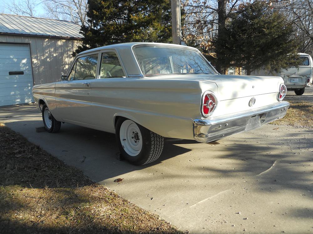

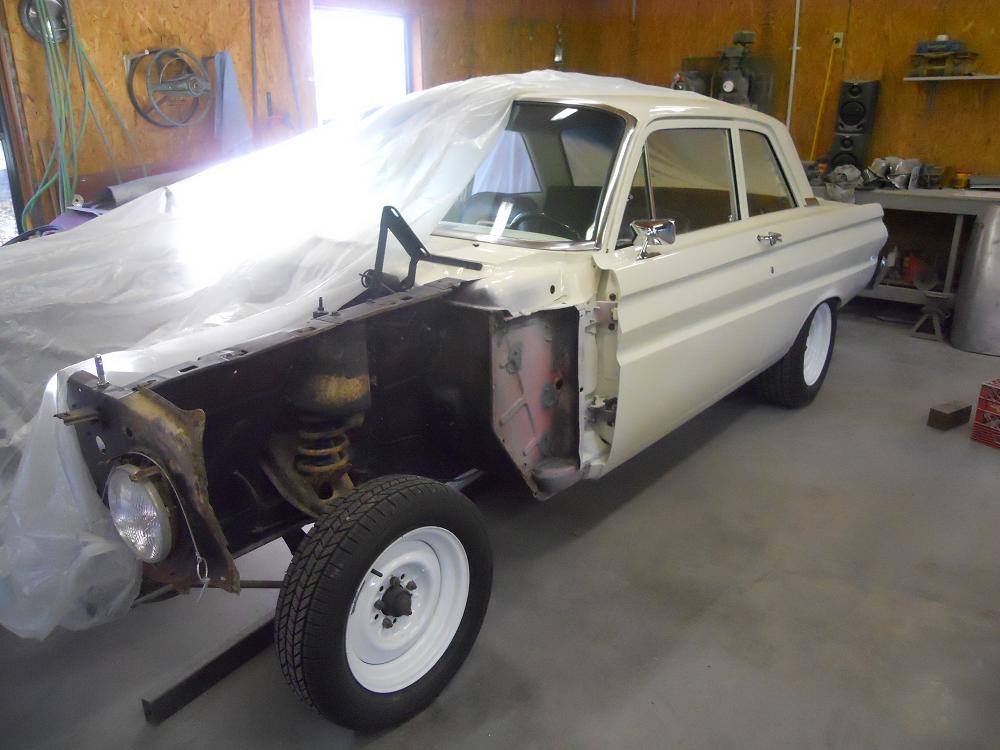

    Update: Been awhile since I started this adventure, the day job has made for slow progress. The roller sounds sweet on the run stand, and I might even get the rest of the car done by the time the track opens. P.S. the huge breather will not be run, it's only to keep squirels out.

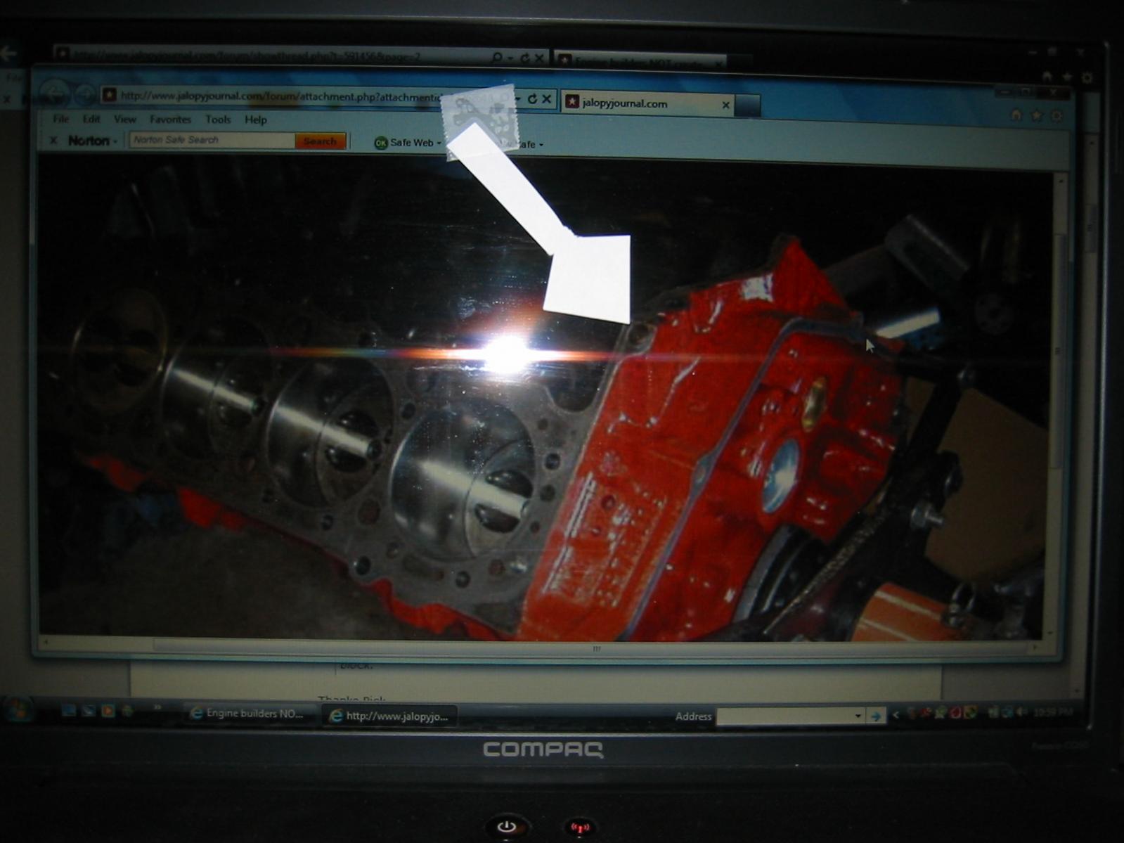

  14. Go back and take a look at the picture in post #23.
    At the back of the engine you can see the horizontal, machined surface where the rear edge of the intake manifold sits on the block (this is where you usually use silicone to seal the end of the intake to the block) ... there is also a hole on that same surface for the oil pressure sender ... now, if you look at the deck surface the drivers side head sits on (not just around the cylinders but look up near where the deck surface meets the surface the intake end sits on) there is a a hole on the deck surface, right up near where the intake manifold sits ... this hole is supposed to be fitted with a plug. The hole can still be seen when a head is installed BUT the hole is also partially covered by the head, so the plug can not be added after the head has been installed.
  15. The arrow shows the hole for the plug ...

    Your pic is none too clear, but are you maybe talking about the holes in the intake manifold mounting surface in some blocks that were put there to accept studs molded into the rubber gaskets for the ends of the intake manifold?
    Really, I'm not trying to be a smartass, just never found an oil hole back there except the one for the oil pressure sending unit or line to a mechanical gauge. And I've built literally dozens of these engines.
    Dave
    On edit: OK, I went back thru the thread and found another pic you posted that was more clear and in focus. You're talking about a galley plug that is driven in rather than a screw in plug that I was envisioning! Yeah, there needs to be an expansion plug in that hole for sure, and I would be concerned about an engine builder that left it out!
