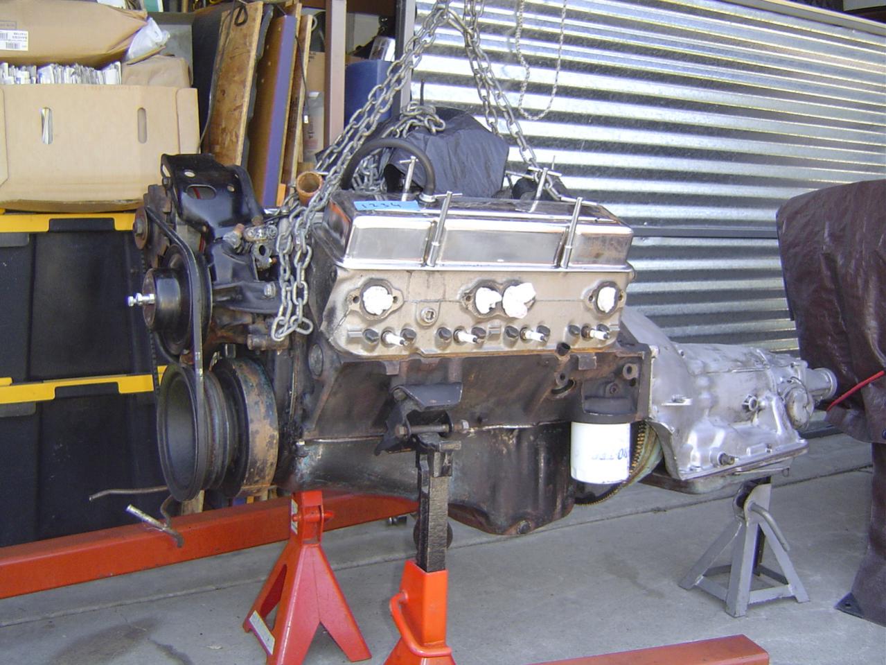

    How about something like this...?
    Bout as easy as it gets...
    Does your 283 have side mount perches...?

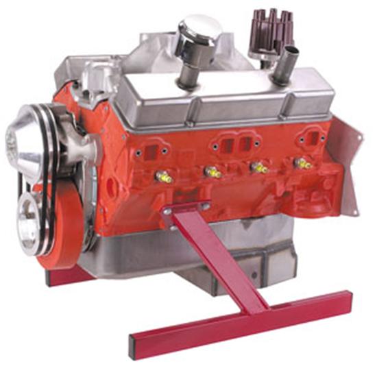

    I needed a way to store a 302 with attached AOD trans. So, I got one of these from Speedway. Basically outriggers attached to the engine motor mount bolt holes. The tranny rested on a 2 x 4. The stand is $43.

    Yikes !!! That looks a little precarious to me.

  6. Nova Thug
    Joined: Jun 9, 2012
    Posts: 185
    Nova Thug
    from SG Vizzle
    Ya, I left the chain and picker attached while I degreased the engine and trans together prior to placing the combo into the engine bay. I wouldn't recommend long term storage like this but certainly you could clean and paint up the engine and trans still coupled together this way.
