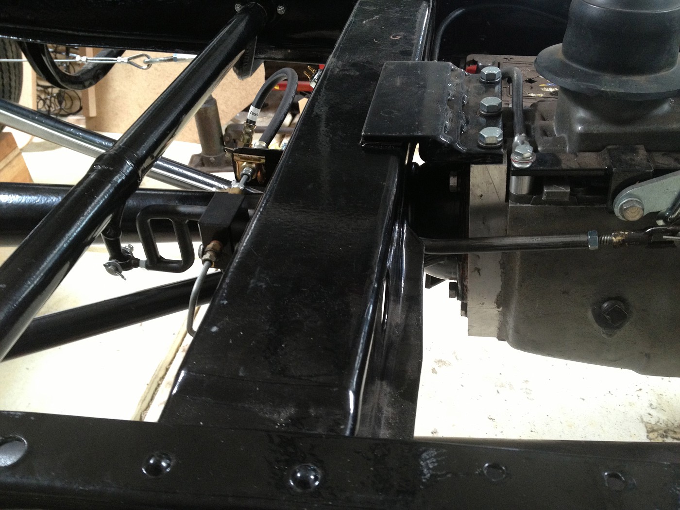

  6. lodaddyo
    Joined: May 5, 2002
    Posts: 1,250
    lodaddyo
    DE258F8C-201A-4EE1-91BC-B96594B97ECC.jpeg I am using the same guides on mine. Two on each radius rod. This the only crappy pic i have. I can take a better one tomorrow.
