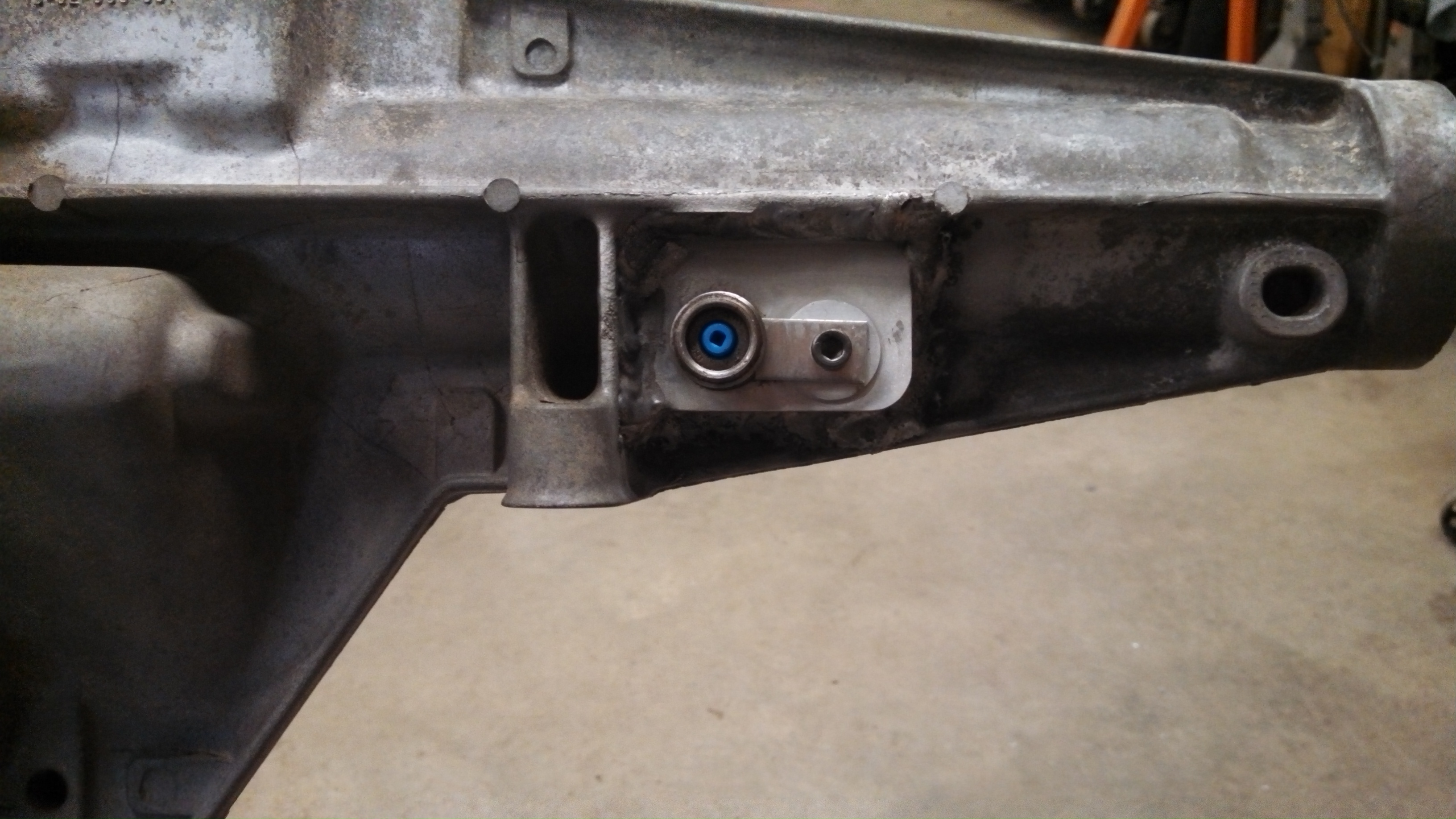

    I can convert your electronic t5 s10 housing to mechanical. PM for details.

  13. I've seen you advertise in CL for trans conversions. You live in Mankato? what do you charge for the conversion?, You should advertise on the HAMB, could be a worthwhile side business.

  15. Kato Kings

  16. I have a 94-95 BW T5 in my 1951 3100. Need to convert to mechanical speedometer. you can email wds1948@yahoo.com--Thanks Bill

    Kato, Love your stuff. Do you still do the T5 electric to mechanical speedo conversions.
    Just joined this site to try and get a hold of you, George, roetzer922@roadrunner.com
