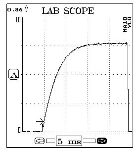

    Here is a look at a simulation of a 1.5 ohm V8 coil with no ballast resistor.
    Now you can see that the "reactance" of the coil, it's tendency to fight a change in current such as when we turn it on, reduces current flow as we increase the frequency of switching it.
    It has more "Resistance to the current".
    This decreases the current across the Ballast resistor which cools it and lowers it's resistance.
    The combination of the coils increasing resistance to the switching current lowers the current and Voltage Drop across the Ballast Resistor.
    If you measure the applied voltage to the coil it goes up with RPM thereby acting as a ballast to limit the high idle current, while it's resistance lowers as an effect of the raising RPM and it's outut voltage raises.
    True it is a passive device but it's effect when inserted into a primary circuit is to alter the applied voltage to the coil.
    You can tell you are looking at a ballast resistor charging curve, strangely enough by it's ballistic shape.
    Vs the predominantly straight charging line of a current limited primary.
    So when inserted into the circuit, a ballast resistor will react tp RPM by lowering it's resistance.
