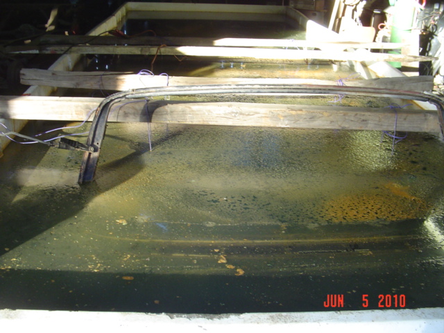

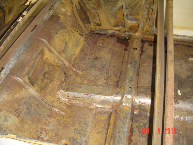

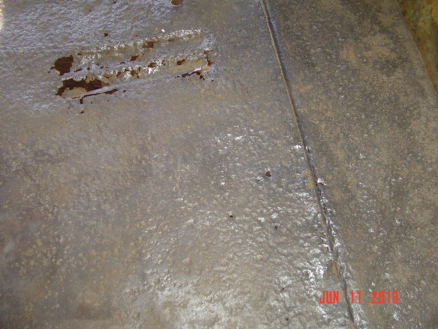

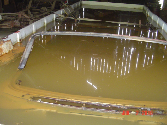

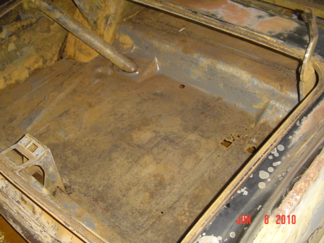

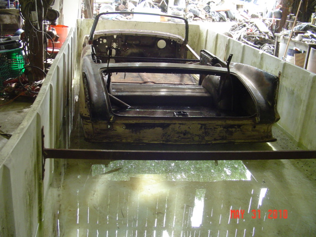

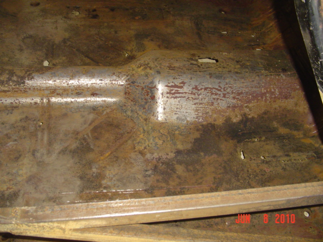

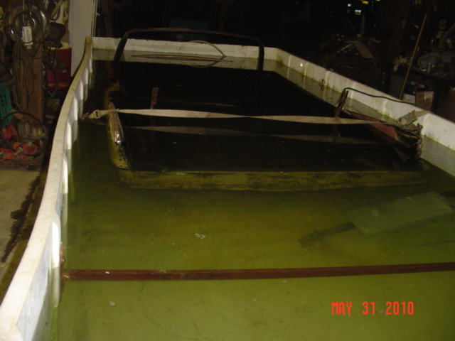

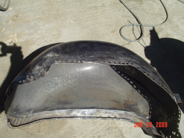

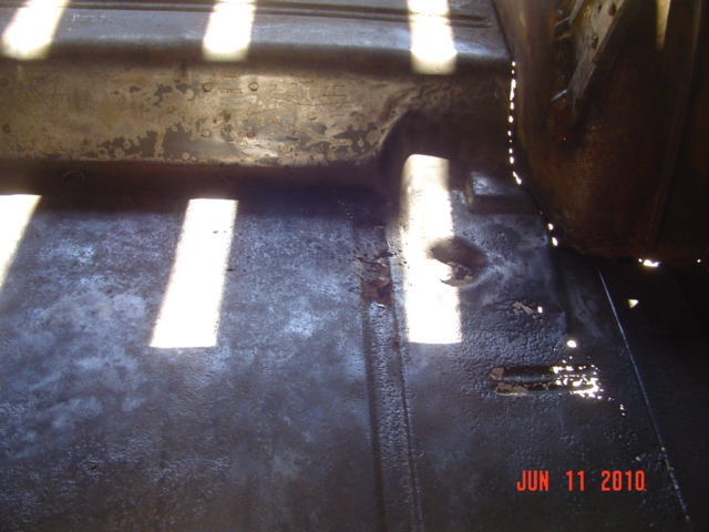

    Here are some of John's (big m) comments about his electrolysis bath:
  8. Gotgas
    Joined: Jul 22, 2004
    Posts: 7,178
    Gotgas
    from DFW USA
    continued...
  9. Gotgas
    Posts: 7,178
    Gotgas
    from DFW USA
    continued...
  10. Gotgas
    Posts: 7,178
    Gotgas
    from DFW USA
    ...continued.
  11. Gotgas
    Posts: 7,178
    Gotgas
    from DFW USA
    I sincerely hope John doesn't mind me adding this info here. I found it compelling and hope it will help someone else have the same success on their project as he's having with his. I don't know where you're gonna find a tomato hauler though. :D
    kidcampbell71 likes this.
