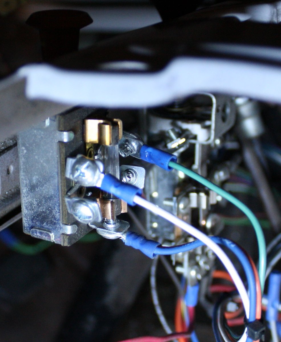

    If you pull one of these motors from a Blazer make sure you get the bracket and the control box mounted to it. I also cut a pigtail from the harness so I can wire it into my harness as factory. It will have 4 wires; black (ground), orange (hot), white (power, low speed), green (power, high speed). The low speed is an intermittent wipe. The high speed is a conventional low speed.
    I wired my motor into an over-the-counter headlight switch, putting the low speed on park light position and the high speed on headlight position. You are basically putting all wires except black to power to get full speed, leave green off for low, and orange only parks the unit. If you wire the orange into switched power you might get funky wiper motion when you start your car. I do. Once you are running you have to run them to re-park. I would wire to constant hot with a fuse.
    Here is a pic of the switch I used. The blue wire is the hot from the fuse panel. It shares a position with the orange wire. Pic is rotated because the forum is smarter than I.:rolleyes:

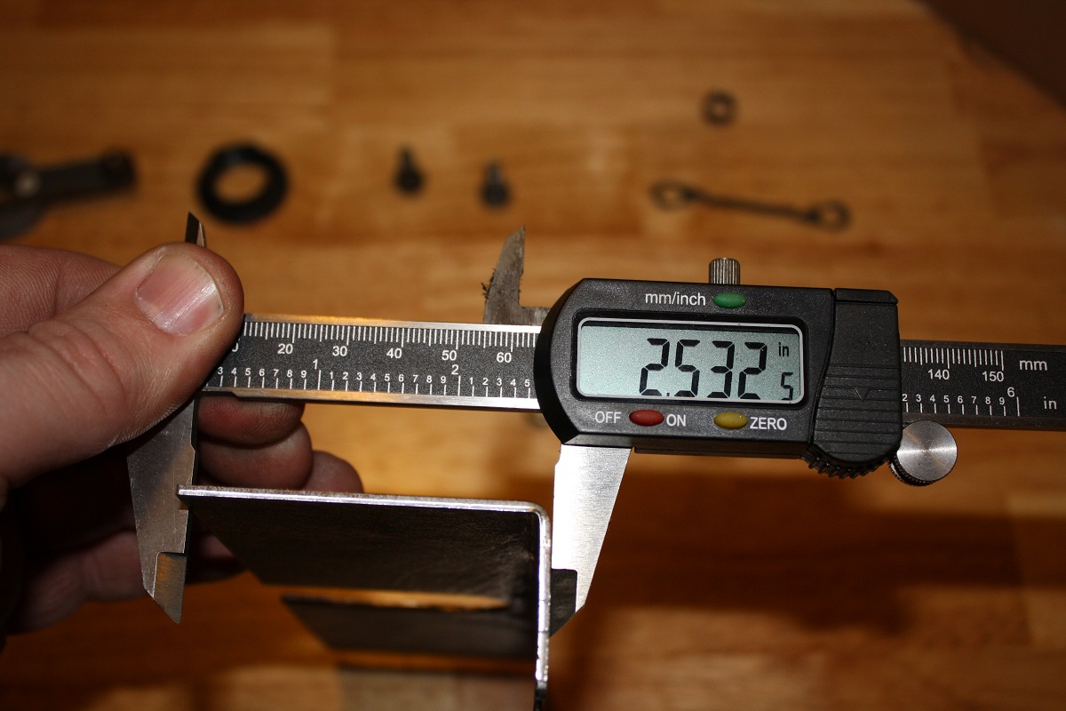

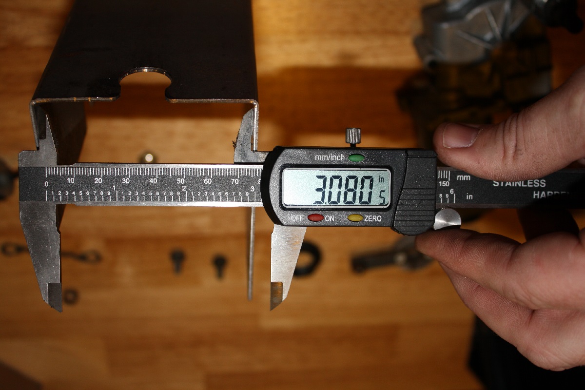

    Some bracket dimensions...
    The bracket is 7" long overall as well. Roughly 14ga as I recall. The most important dimension is the 3" inside one, but even that one can be tweaked slightly with the spacer we'll be making. I had a sheet metal shop work two of these up for me. Only needed one as my mark one prototype worked out fine.
