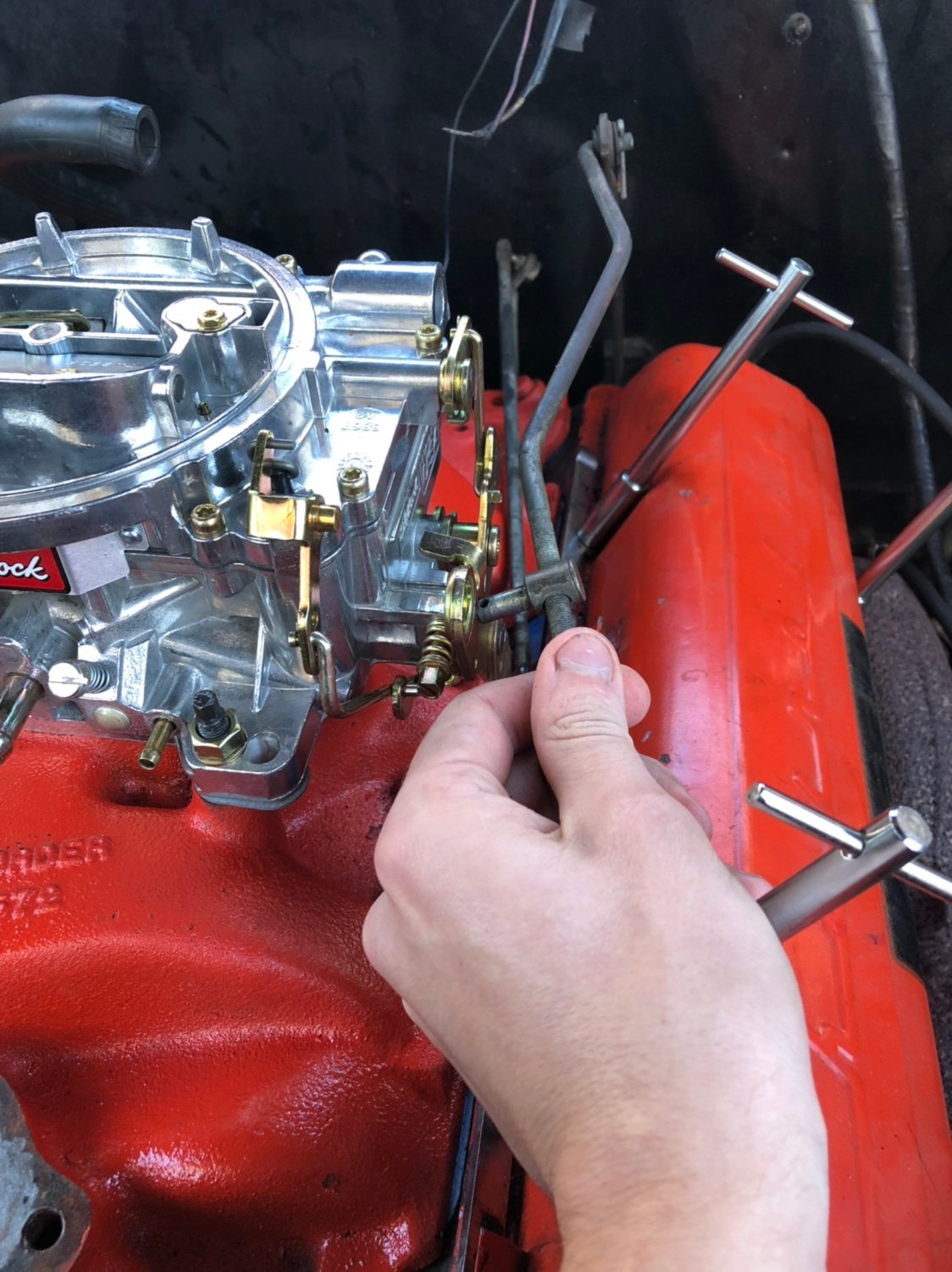

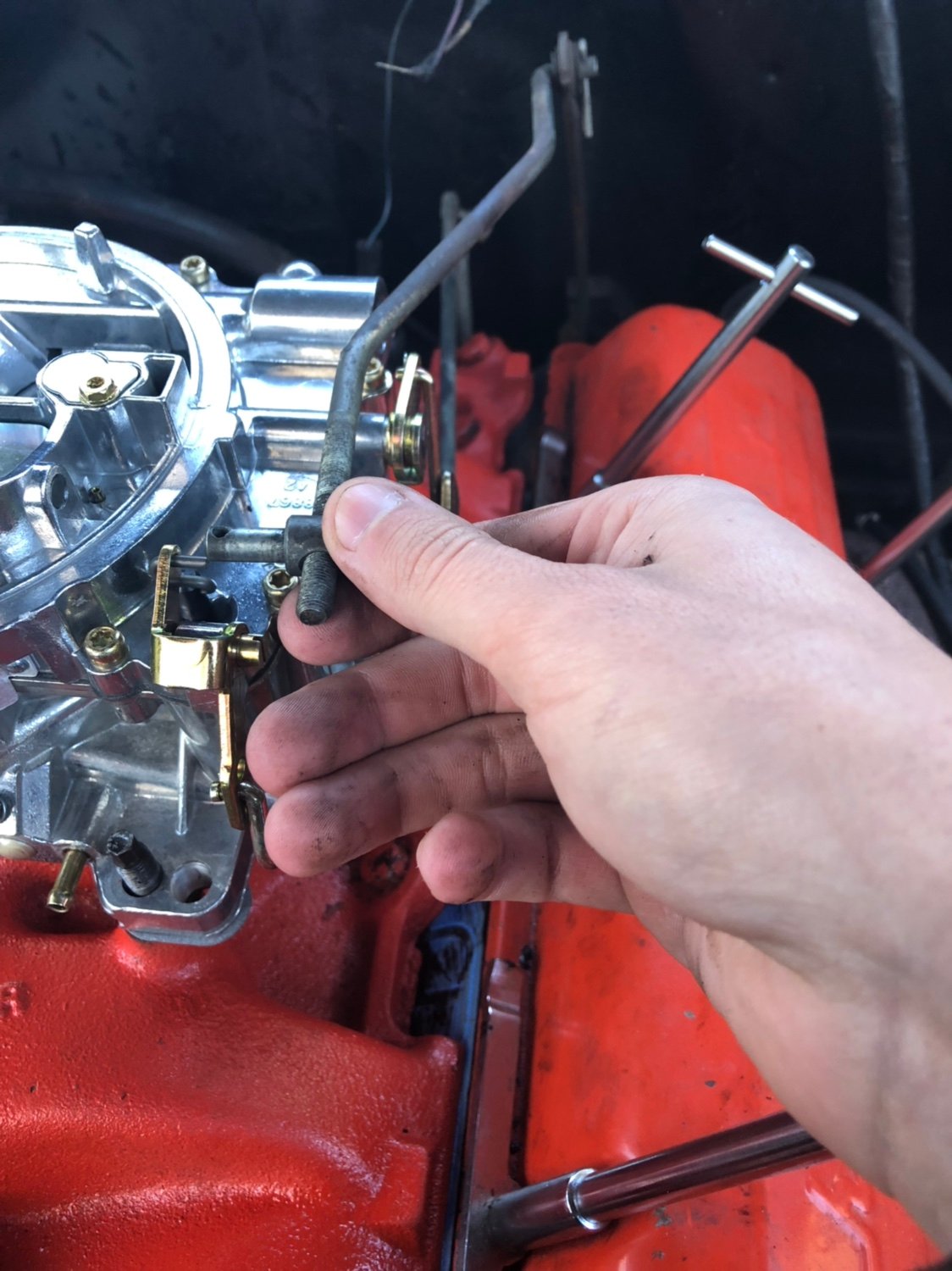

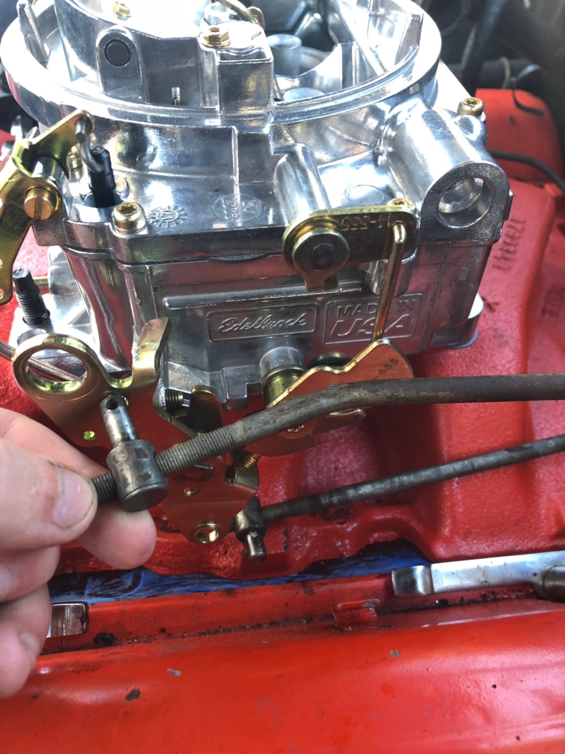

  1. Hey guys! So I’ve recently decided to swap over from a 2 barrel Rochester 2CV to a 4bbl Edelbrock performer 500cfm carb in my 64 impala 283. I’m also using a 62’ 283 4bbl manifold that I picked up. One of the issues I’ve ran into was the my stock throttle linkage just wouldn’t fit/line up with the carb. I’ll include some pictures and you can see because the carb is wider than the 2CV, the linkage is skewed on and angle and just will not fit. It’s also not long enough it seems. If you guys know of any solutions that would be great! Also would like to keep it as original as possible, so minimal cutting, drilling etc is preferred! Thanks![​IMG][​IMG][​IMG][​IMG]

    Take some of the bend out of the linkage rod.

    Unbolt the throttle arm [by the firewall] and "Z" bend it over to the LH side.
    It isn't that difficult in a Vice.
    If you don't want to touch that, look for a shift rod off a Hurst Shifter

    Straighten the rod out, run a die over it to get more threads, cut it off as needed. Simple, and over and done.

  9. Bending the rod might fix the throttle linkage, but the other problem is the kickdown linkage. I can get it to fit, but it’s way too short. When it’s installed, you can’t even open the throttle.

    Did you unscrew the carburetor end of the linkage to see just how far off you are? It looks to me like there are plenty of threads left on the throttle rod.
    On the transmission linkage:
    1. Stick a rag in that open distributor hole on the intake
    2. Remove the kickdown linkage from the car
    3. Cut it in half
    4. Weld in an inch of 1/4" rod to lengthen it
    5. Dress up the welds
    6. Reinstall it.

    I'd heat the linkage up at the offset parts and straighten them out a little bit. Can probably do it on the car if your careful. It won't take much and you gain length as you make the offset smaller, plus you can align the connector at the carb while doing it. The kick down rod is simply too short. You can try heating the very top of the part sticking up behind the motor and rotate it forward a bit. It doesn't look like you need much. If that can't be done take a piece of 1/8" flat stock about 1" long. Drill 2 holes in it. Bolt that to the top of the arm through one hole and then put the pivot stud the linkage attaches to in the other hole. Use good lock washers! Should gain you enough to allow it to connect.

  19. Think I’m going to try and bend the existing throttle linkage to fit like a few of the guys here said. As for the kickdown I think I’m either going to cut it and weld a piece in to make it longer or look for a longer rod. Thanks for all the ideas guys, it’s much appreciated
