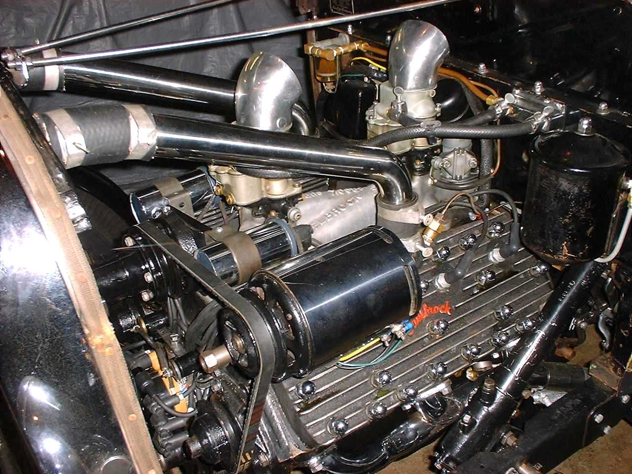

  12. 50specialdeluxe
    Joined: Nov 23, 2009
    Posts: 88
    50specialdeluxe
    Here's the only pic I have of the setup...I'll get better ones once I get home from Rust Revival!

  14. gashog
    Joined: Dec 9, 2005
    Posts: 984
    gashog
    That be the early intake without the generator mount. I used the same one on my 8BA with early heads and a Harman Collins dual coil crab distributor. The idler bracket is a chunk of C channel and an old 3-brush generator. IIRC, I had to drill/tap the block for the LH rear bracket bolt. Be careful of those aftermarket generator mounts. There's more difference to them than side; some adjust vertically and some at a 45 degree angle. That may be the deal breaker in deciding whether you mount the generator on the right or the left.

  17. Bruce Lancaster
    Joined: Oct 9, 2001
    Posts: 21,681
    Bruce Lancaster
    The one in picture has no heat under the carb...probably not good where you live.
    If you have the exhaust heat you can easily block it if unneeded, but you can't add it...
    Also it is the version with no bracket, made for '39-41 applications. Think about where the fan is going to go...
    Fuel pump stand, lack of heat, and lack of bracket are all problems here. You can adapt your way around all, but this seems like a lot of trouble.
