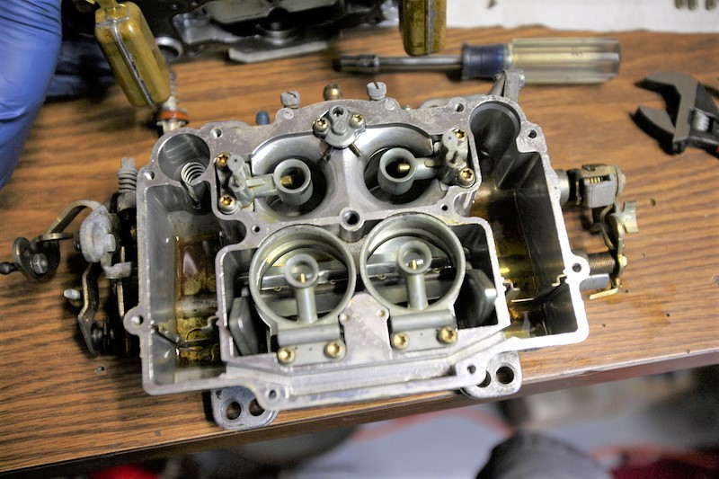

    I have a Edelbrock 1405 Performer carb that has a less than strong accelerator pump discharge. This is a fairly new unit. Upon examining the carb I find that with the design dimension of 17/32 inch ,which is the dimension from top of the pump shaft to the air horn top in the rest position in the middle linkage
    hole, the pump head is 1/4 inch below the bottom of the vertical slot in the pump chamber. I have always believed that this vertical slot was there to allow fuel to run into the pump chamber under the pump head to set up for the next squirt. Talked to big people at Edelbrock and no one knew anything of this condition. Even with the pump completely detached from linkage the pump head will still not come up above the bottom of this vertical slot..... Has anyone discovered this before.

  2. The accelerator pump plunger acts as a check valve. On the up stroke (when the throttle is released) the fuel can flow into the accelerator pump well past the plunger. On the down stroke the plunger seats against the plunger stem like a check valve and the fuel is forced through the passage and out the accelerator pump nozzles.

    Looking at the floats in comparison to the accelerator pump how far is the fuel level above that slot if it is above the slot? It looks like it serves as much or more as a vent for the air above the accelerator pump piston as it does for allowing any fuel in. Hooptie_Rebuild_Shoot_Two81-vi.jpg Edelbrock carb body (2).jpg

    The cup on the pump should never come above that slot when the carburetor is assembled. If it did during normal use it would wear out the cup trying to make the gap.

    I have seen a few of the Carter/Weber/Edelbrock, "AFB" type carburetors that had the accelerator pump wells scored up, thereby losing pressure at the "squirt". The top opening of the accelerator pump gets dirt and crud deposited on top, and finds it's way into the well, scratching the walls up, causing the pressure leak. Has anyone come across/heard of a repair kit for this? Is the well scored up pull toy? I am Butch/56sedandelivery.

    Center of the Galixie member hit the answer on his post I believe. In addition I discovered that the pump chamber in really bored in a slight tapper, meaning the upper portion at or just below the vertical slot is larger in dia than the lower portion. When the pump head is at the idle position the rubber skirt that does the work is not sealing against the chamber walls, as it will be when pressed down, thus allowing gas to flow by it into the chamber bottom. Maybe not the best design but that's how it works. Please note that Edelbrock carbs are set up rich for cruise but not for power. My plugs were smutty but my motor stumbled at power. My factory metering rods were 7047, Edelbrock had me change them to 7342 which means the power stage would be richer while the cruise would be leaner. Springs were also changed to silver at their direction. I now do not believe any carb is a bolt on happy ending situation, they all must be fine tuned to each individual condition. Thanks for all the input.......
