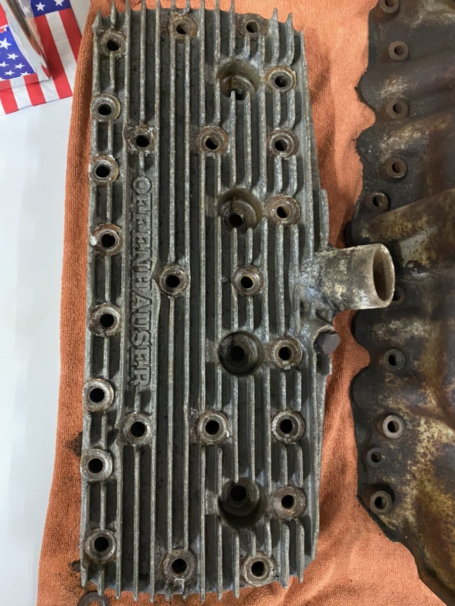

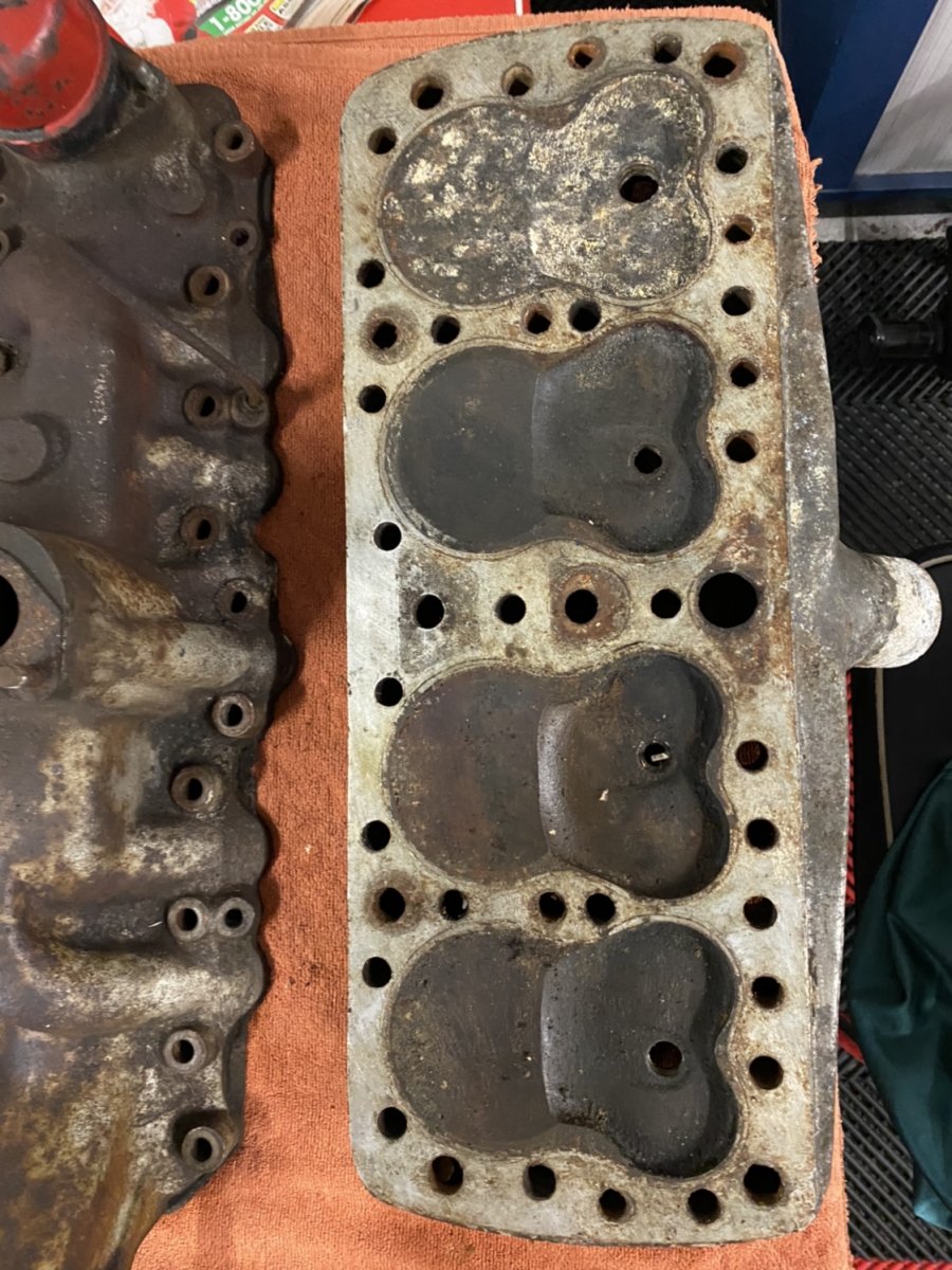

    These are the Offis.
    Perhaps sand blasting and little grinding..?

    Yea, the Offenhauser heads look a lot better.
    A full 360° grit blast, a run through the surfacer to clean and square the decks, maybe a pressure check.
    Install.

    Those look much much better.
    It looks like most of the stuff on those heads is gasket funk.
    Definitely No!....,on the grinder and sand blaster!
    They need a good bath in hot soapy dish water and scrubbed with a hard bristle brush.
    Personally the most aggressive clean up I would do, would be a drill with a wire brush on the combustion chambers only.
    For the deck surfaces....
    I would carefully scrape with a blade (like you would clean old gaskets off a part). A utility/razor knife/box cutter is a good stiff blade to use with care.
    After the deck surface has been scraped.....,
    I would use a big flat file, medium to fine cut to true the surface.
    You are not trying to draw file it true, rather you are keeping the file flat and true until the all the deck surfaces are clean.
    Really you are just cleaning it up and checking it for true. It’s going to have some low and high spots but you’ll know pretty quick if it needs machining.
    The heads on one of my flatheads, I kicked up out of the ground with my heel. They were cast iron Mercuries and they cleaned up great by the methods above.
    Good is good. Bad is bad.
    I’m not above working with old crusty stuff but you have to have something to work with.
    Those Offys look like they’ll clean up.
