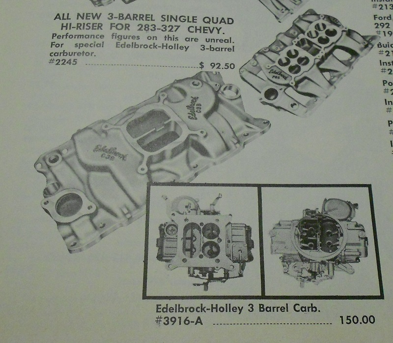

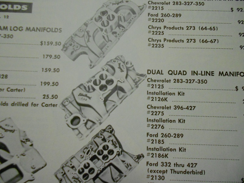

    It goes back before the LT1, maybe way back. Could swear I've seen new product ads for the C4b from Hot Rod as early as '64/'65? Here's both the C4b (4 barrel) and C3B (3 barrel) in a 1967 Bell Auto catalog.

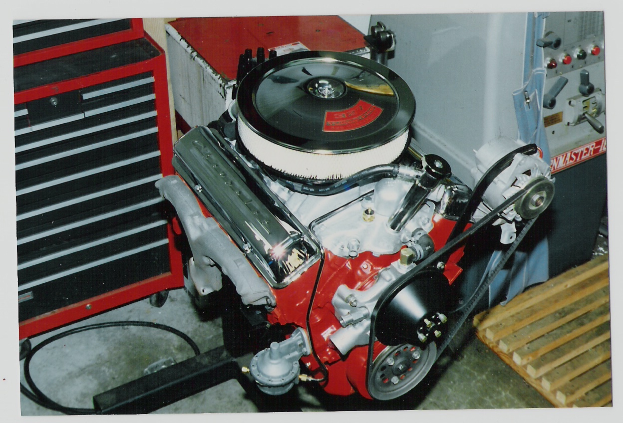

  24. 350hp/327....factory 1966....?

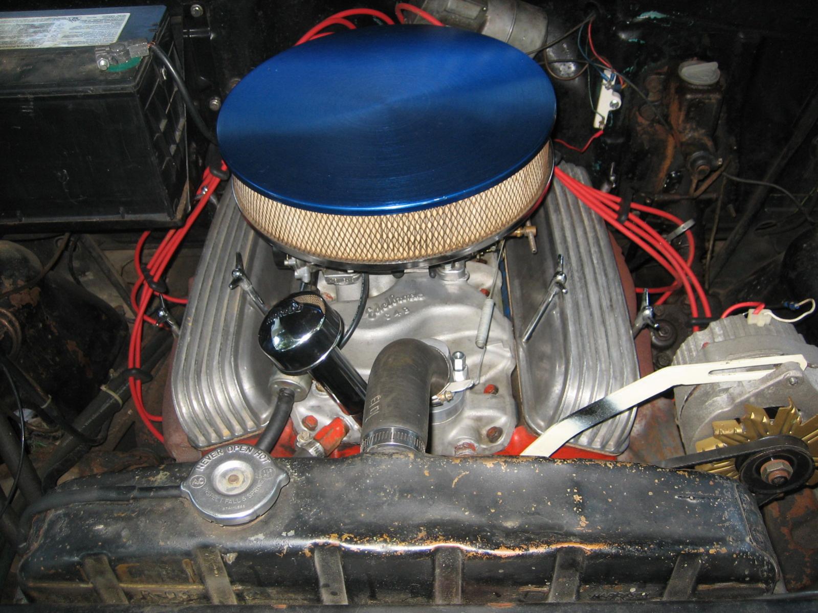

    Works good (C4B) on the 327 in the 55 with an Edelbrock carb.
