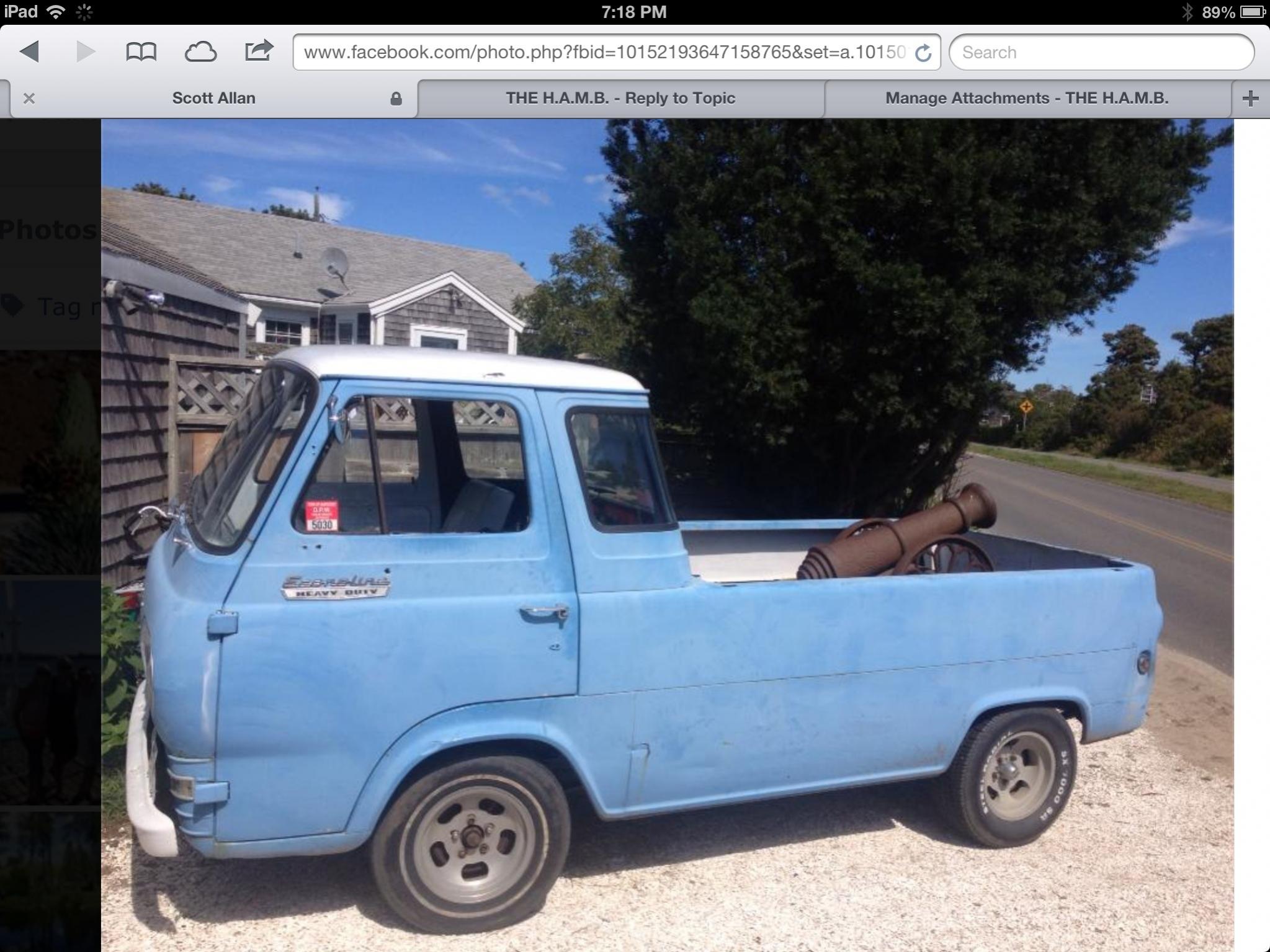

  1. peter schmidt
    Joined: Aug 26, 2007
    Posts: 657
    peter schmidt
    from maryland
    I have a chance to trade my current daily o/t truck it's a 98 f150 v8 5 speed for a econoline pickup. It's pretty solid some rust needs the basics from sitting tune up brake work ect... But it's a real cool truck. It's a 6 cylinder 3 on the tree. Now I love my current truck it's paid off never gives me any trouble but the econoline is just too cool to pass up. Who here has driven one daily? I only drive about 10 miles to work but travel farther for shows to buy parts ect.. Will these trucks tow anything it seems kinda sketchy to tow with but idk I've never driven one. Just looking for some people's opinions on picking it up for a daily. I would only fix the rust bolt on some different wheels and try to lower it some after getting it running up to par first. Also anyone do an axle flip on the front of one of these? What you have to do as far as steering ect.

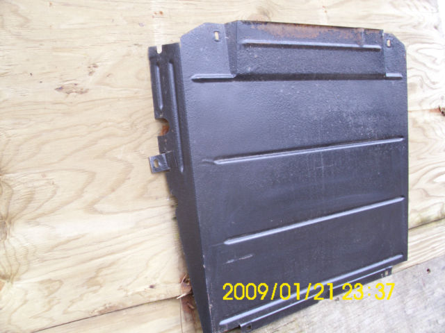

    Just a quick question here . Did you have the ALL IMPORTANT "Louvered "sheet metal pan in front of the radiator mounted ?? If not , oh yes, those trucks WILL overheat - BIG TIME ! That is one piece that needs to be reproduced as folks would remove the pan to work on the front end . Because it could be a pain to re install, it was often discarded . Both the Chevrolets and Dodges used them too. scrubba
  21. goodturn
    Joined: Sep 3, 2010
    Posts: 92
    goodturn
    Sorry. I hit the wrong button. 200 it was.
  22. Scrubba,
    You have a photo of this piece? Sounds like it would be easy enough to make....
    Thanks, JH
  23. Hellfish
    Joined: Jun 19, 2002
    Posts: 6,413
    Hellfish
    The funny thing is that some people say they improve air flow, and others say it hurts.
    Mine was missing, but a PO replaced it with a piece of sheet metal. It doesn't have the sides, but it's better than nothing. Even driving it in 90+ degree heat and in traffic, I never had a cooling problem. I replaced the stock radiator with a 6cyl Mustang radiator ($100), and then with an aluminum radiator when I swapped in a v8
    These are some photos I found online of that belly pan

    Hi . Look in the files on the econoline groups on how to make the belly pan .
