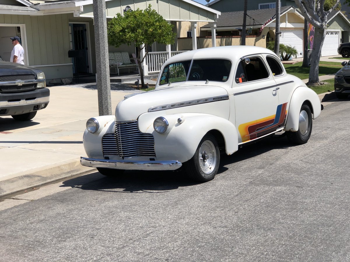

  29. jimmy six
    Joined: Mar 21, 2006
    Posts: 14,795
    jimmy six
    This ones real and has been in this 40 Chevrolet since 1962 which has that date code. Been ok 20B53E27-3C0F-4C87-8D15-AC8C660E9B74.jpeg AA75E700-529C-48DB-97AB-3A1F19A817B4.jpeg
    Desoto291Hemi likes this.
