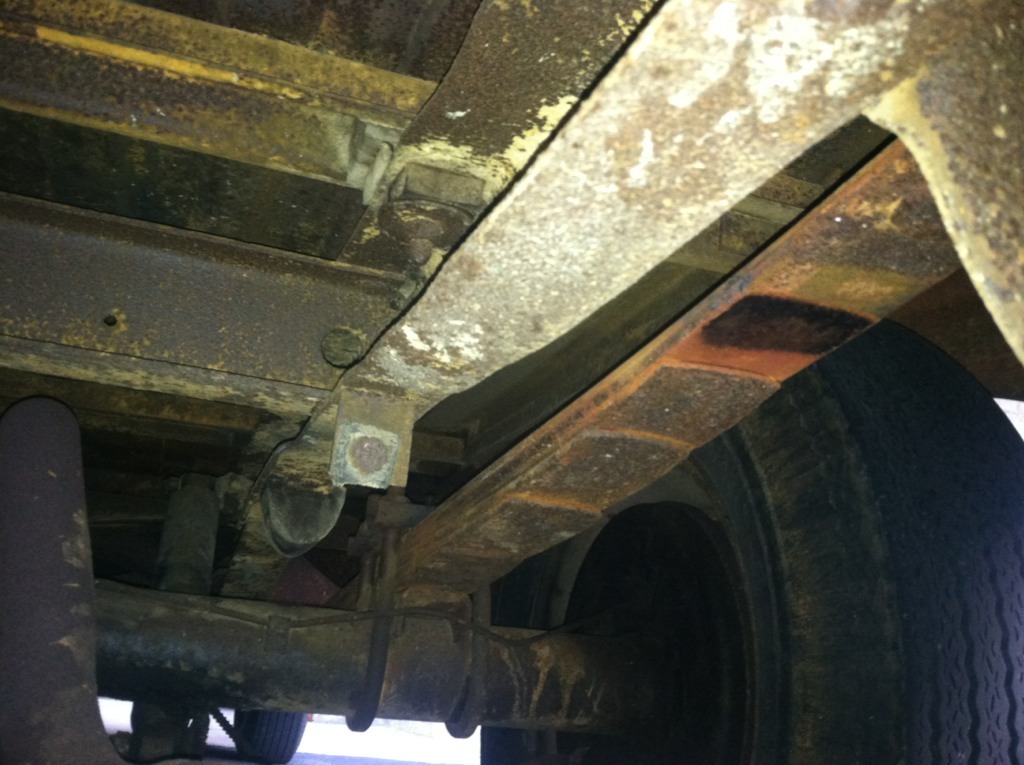

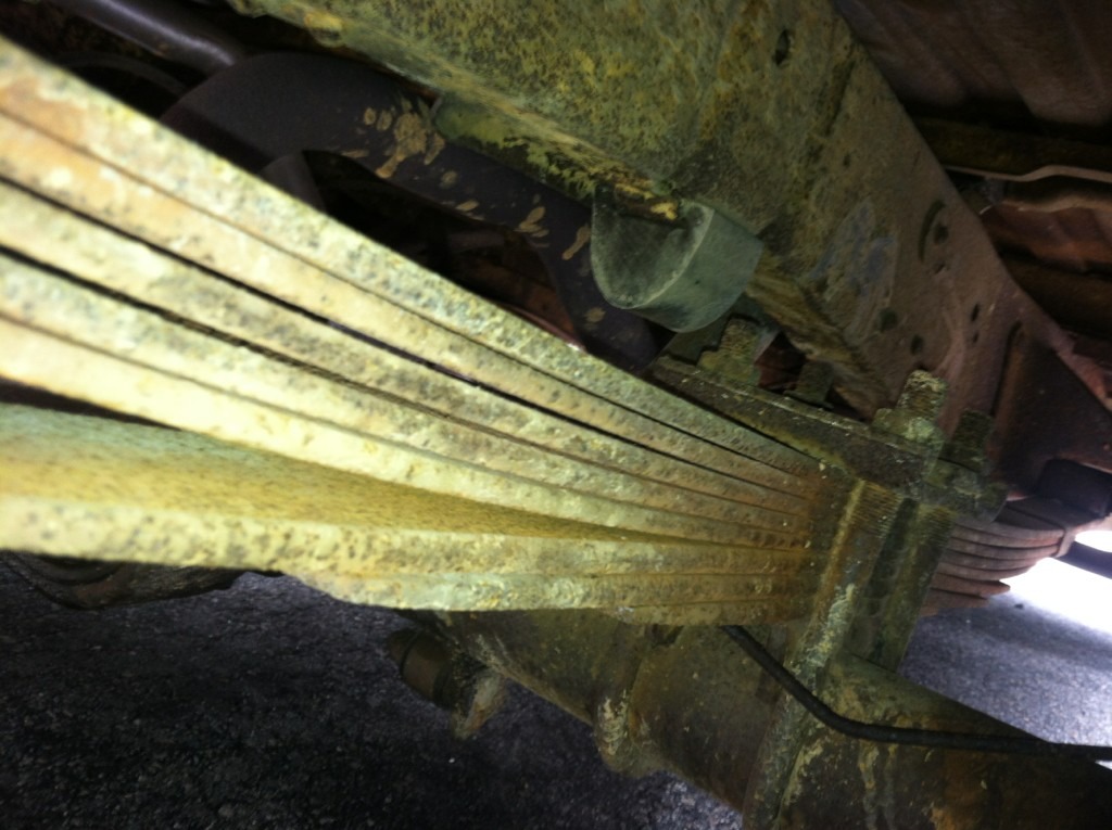

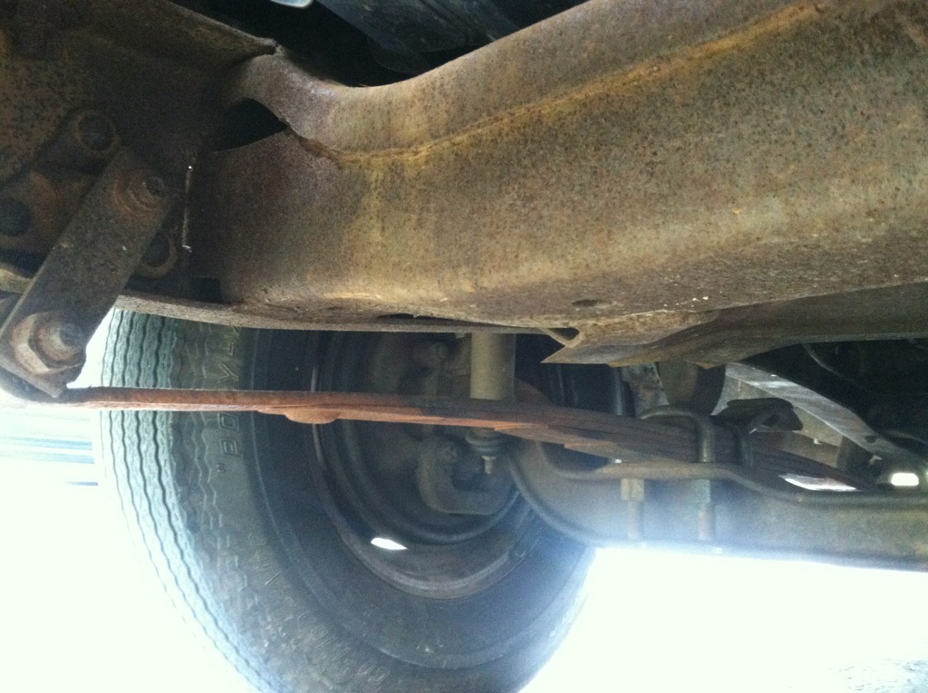

  17. The tires are G78-15's (bias ply) I found them barely used on Craigslist. The truck steers a LOT easier on bias plys than with radials.
    Here are the before and after leaf spring photos. Starting from the top, we removed 2 and 4 on all four wheels.
    Before Font:
    Before Rear:
    After Front:
    After Rear:

    That is exactly what I want to do to my 58. I wonder, does it put too much stress on the main leaf (photo 3 after front). Anyone have any insight on that? Thanks for the photos!

    It looks good...Is the front bump stop resting on the axle in the after shot?
