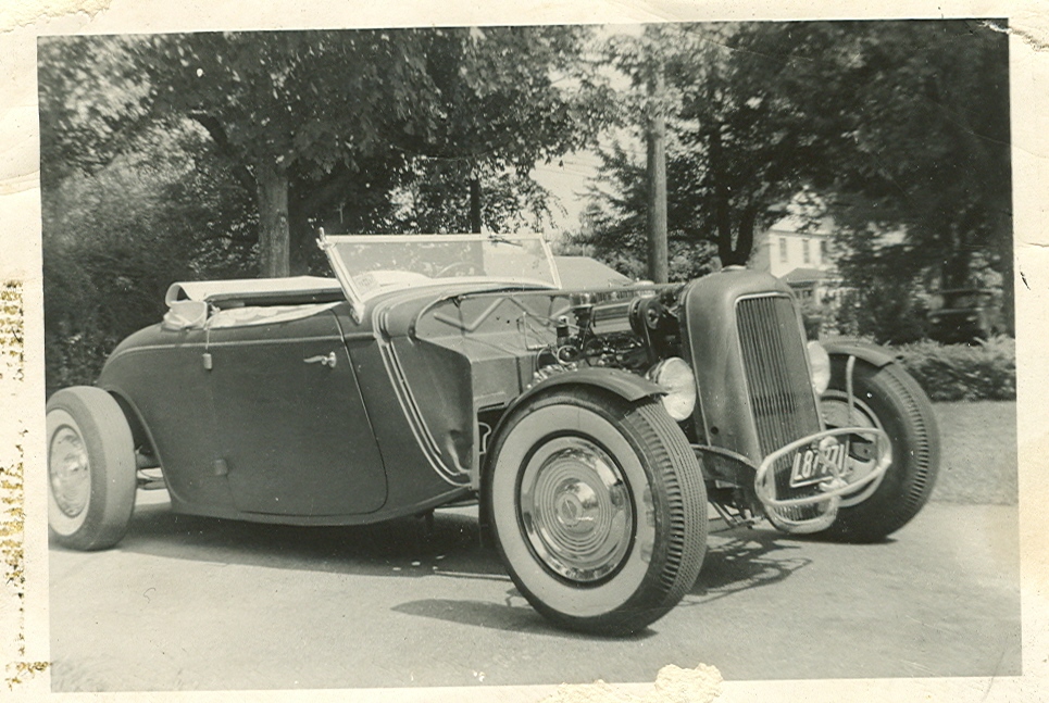

    I have a 29 model a roadster. I'm wanting to build it with east coast style deep channel cycle fenders on the front and rear and real low to ground. I'm wondering if anyone has some rough estimates on how much I can or will have to z it in the back to make something like car in the pic. How much z in the rear can these cars take. Any thoughts or even pics would be appreciated

    I know this isn’t a roadster but this car was kicked up about 8” in the rear and three in the front and it was channeled three inches over the frame [​IMG]

    You can Z it till the crossmember pokes through the decklid. Or you can mock up all your parts, find the "usual" spring height for the spring you will be using, and base your frame on real measurements. There are tons of variables on other people's cars that might not apply to yours. Cheater's measurements will be a good start, but if his spring perches are set differently, or the tire diameter is larger/smaller, or the front axle is dropped more/less will all drastically affect the look.

    I hear ya there are ALLOT of variables or sure. I'm a little ways from getting started. I just was looking for different setups people are running to kinda get and idea on some measurements. I have a model t rear spring for the back to lower it and out front j have a 5 inch okie Joe axle. And reverse eye spring. I was looking at boiling brothers chassis measurements it helps Also but they are running spring behind axle I'm running spring over axle.
