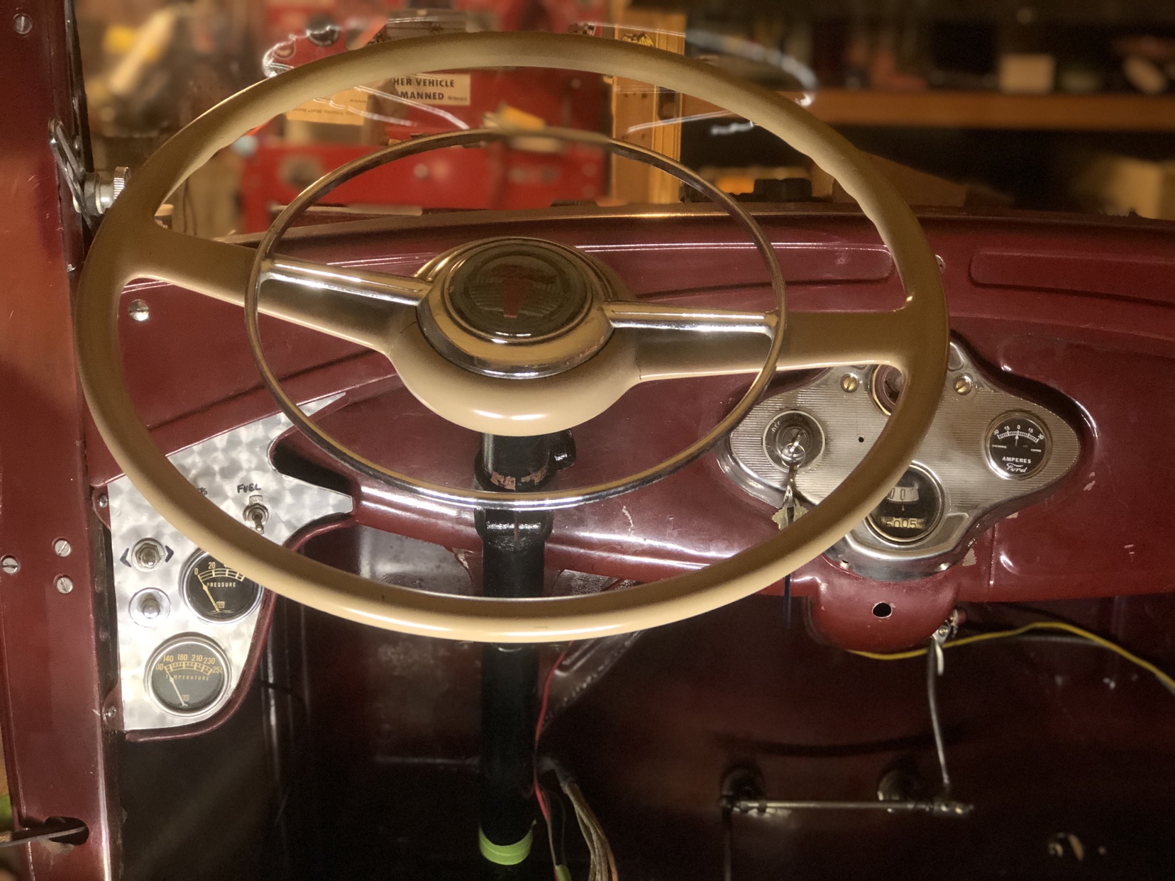

    I saw a pic recently with the steering wheel positioned such as yours (but I think it was a roadster) I thought to myself, you know back in the day the majority of the rods were very similar to this with a big wheel and high up in the car. It looks strange, but then it looks so Right!
    lothiandon1940 and OLSKOOL57 like this.
  2. Phil55Kratz
    Joined: Apr 15, 2012
    Posts: 175
    Phil55Kratz
    That’s what I’m sayin! When I bought this car I pictured a giant white steering wheel up like a big old bus wheel.. and I put tons of though into the position and felt it was perfect .. then I chopped the car without hardly any thought haha. I’m really trying to build this car just the way they were built back in the day. There’s stuff that I’m not sure it will stay but it’s really got the look I was after. Havin fun!

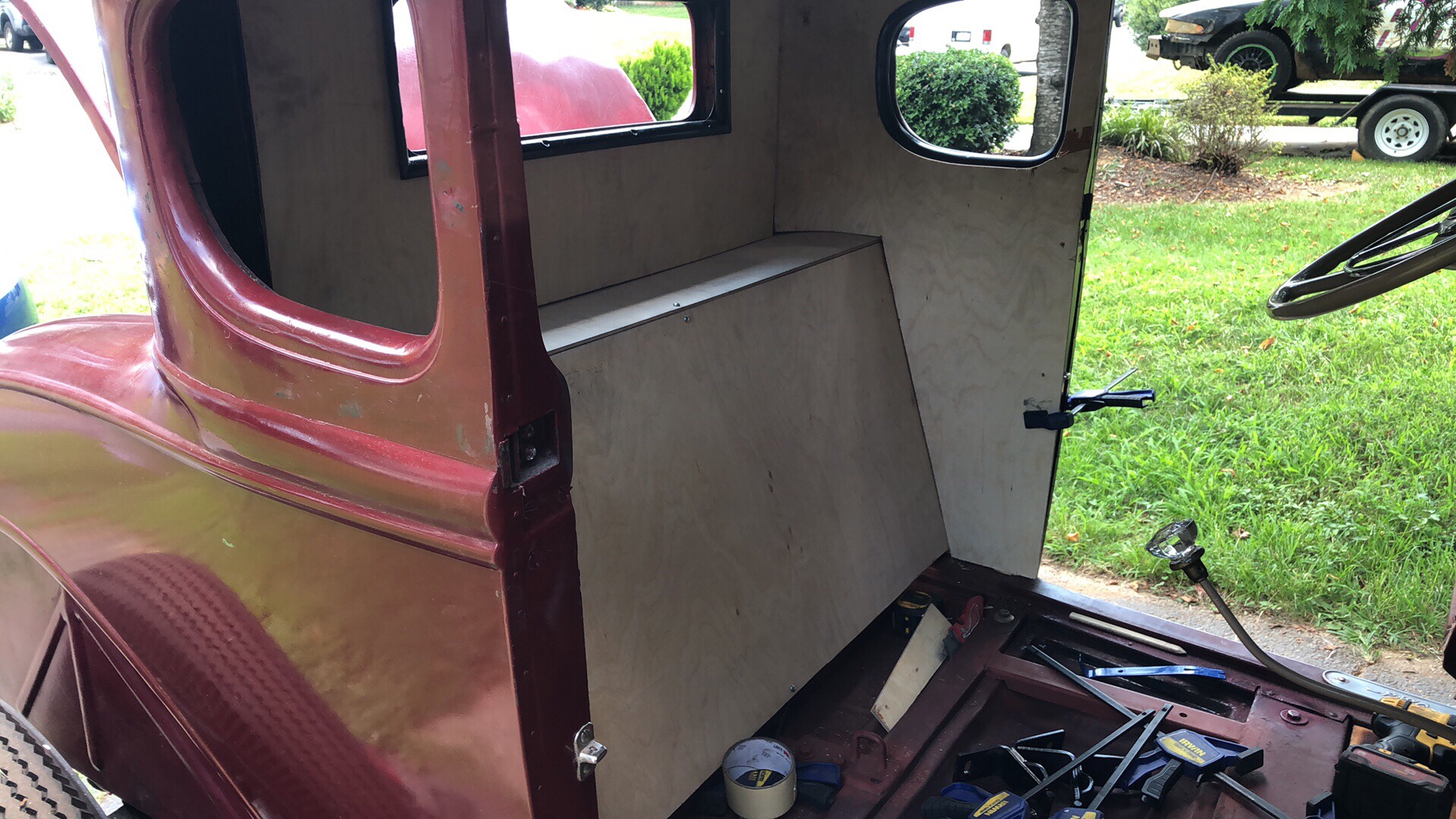

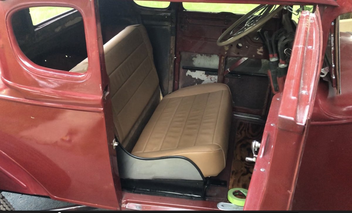

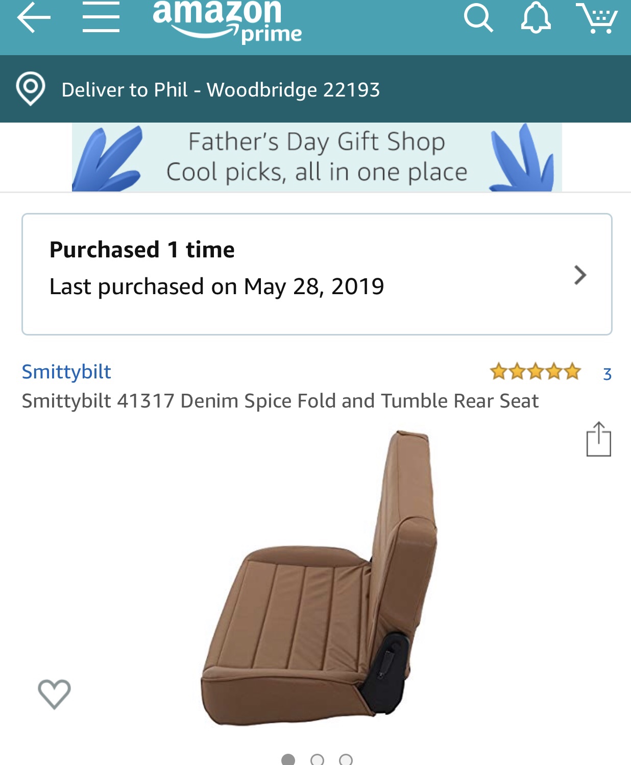

    So since I chopped the car I needed to do something with my seat. My stock seat was in great shape and I could have probably made it work but I decided to sell it. I planned on buying foam and making a seat from scratch. Man just with foam and vinyl I would have had 250$ in It already! Decided to buy a Jeep Wrangler seat off eBay the cover looks decent and will work until I can get upholstery done . The seat is pretty cool but it felt to shallow and the backrest was way low. Plus I don’t wanna just slap any old seat and calm it good. So I pulled it apart and made a platform for the backrest. Tried to give it the original look as much as possible. Worked out great.. still have some finishing to do but I’m happy with it so far.[​IMG][​IMG]

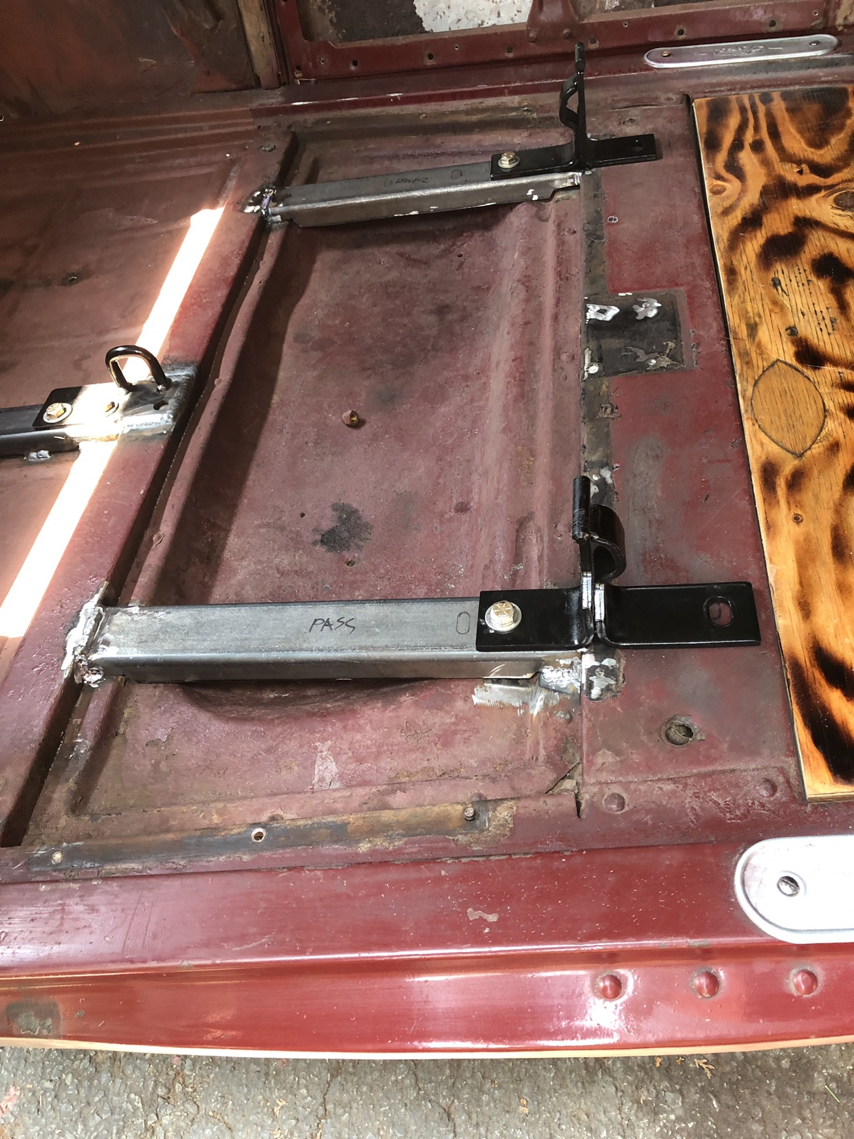

    Like the seat! I'm doing mine with a caravan seat, actually a combination of two. Robbed the adjusting mechanism from the rear seat and added to the middle non adjustable one. Just finished the mock up, the wife and I will do the upholstery.

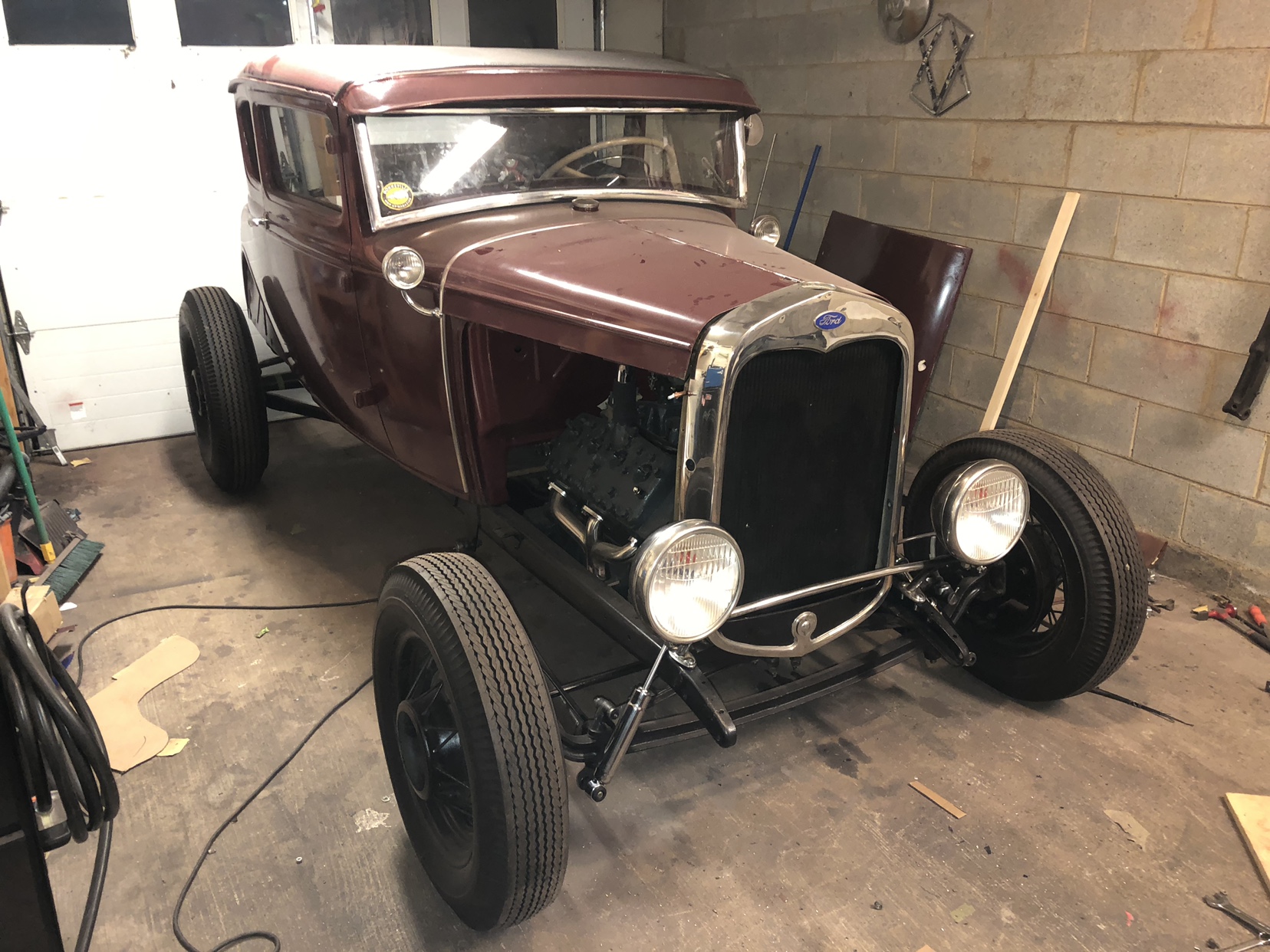

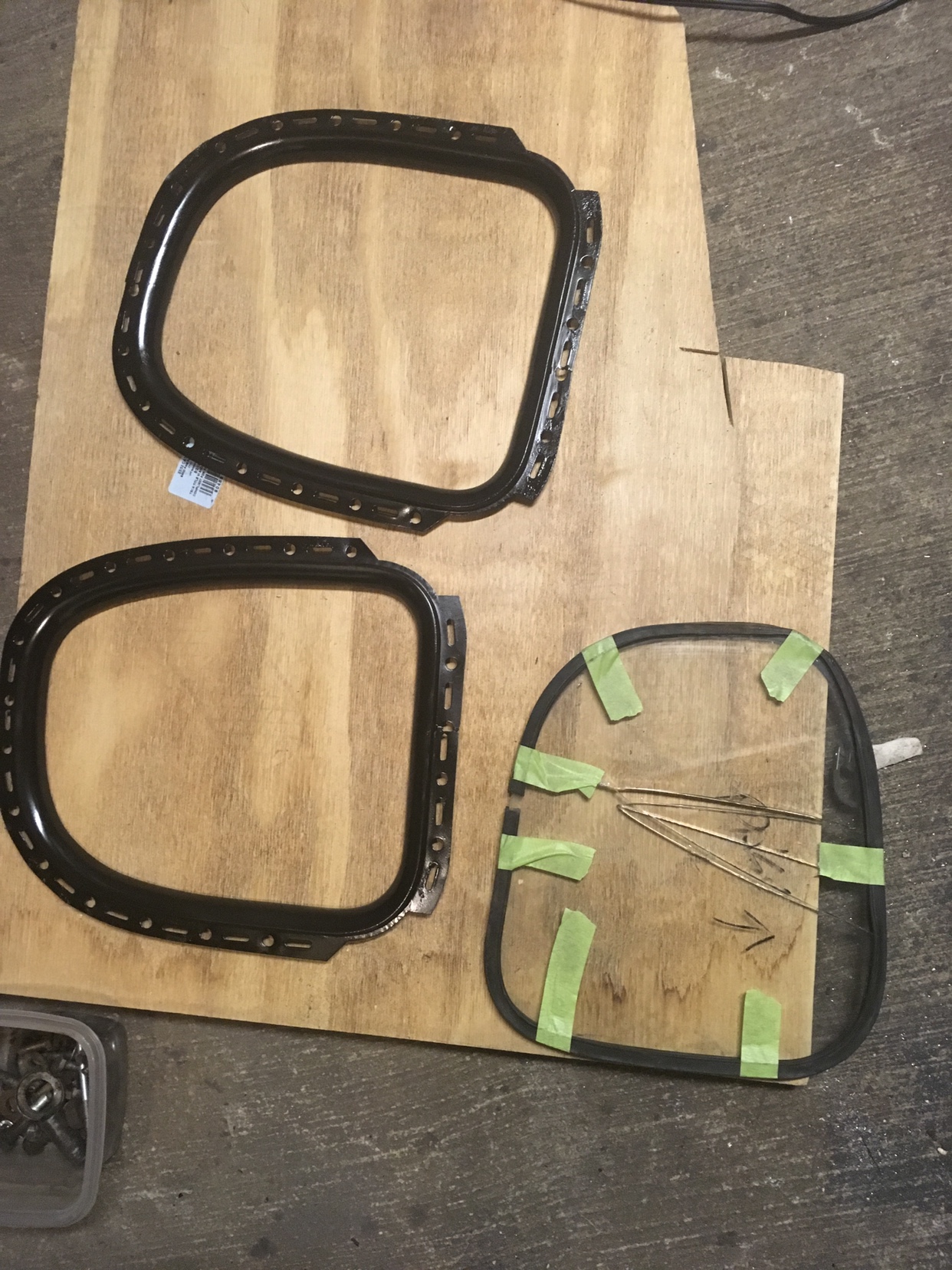

    Been away from home working for the last couple weeks.. finally back at it! Cut the glass down and the window garnishes one window was reg glass and I dropped it and killed it.. no biggy cause I wanna get tempered glass anyway. Messed with the headlight bar tonight and started to make some front shock mounts... orders some new head gaskets for the motor.. since I took the heads off to check it out. I’m really closing in on a lot of it. Really just gotta get my head in it and get it goin. [​IMG][​IMG][​IMG][​IMG][​IMG]

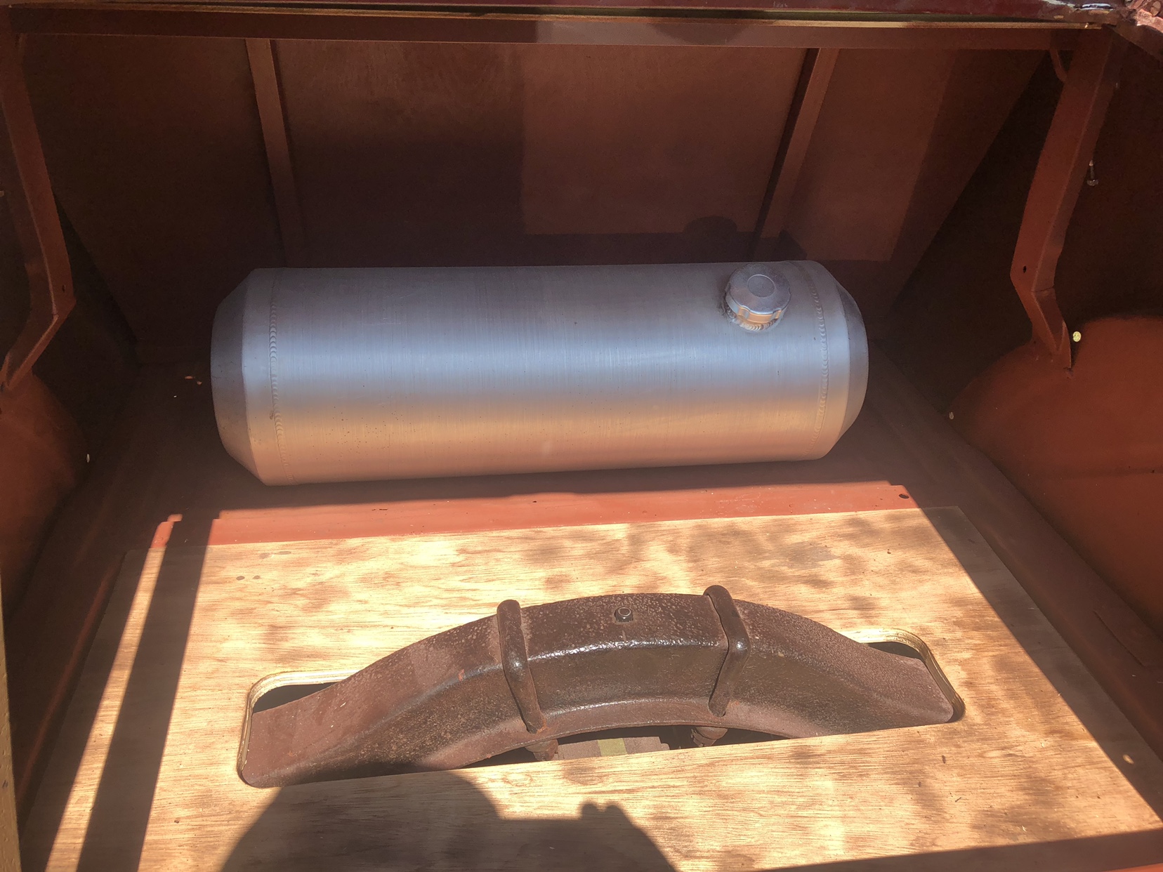

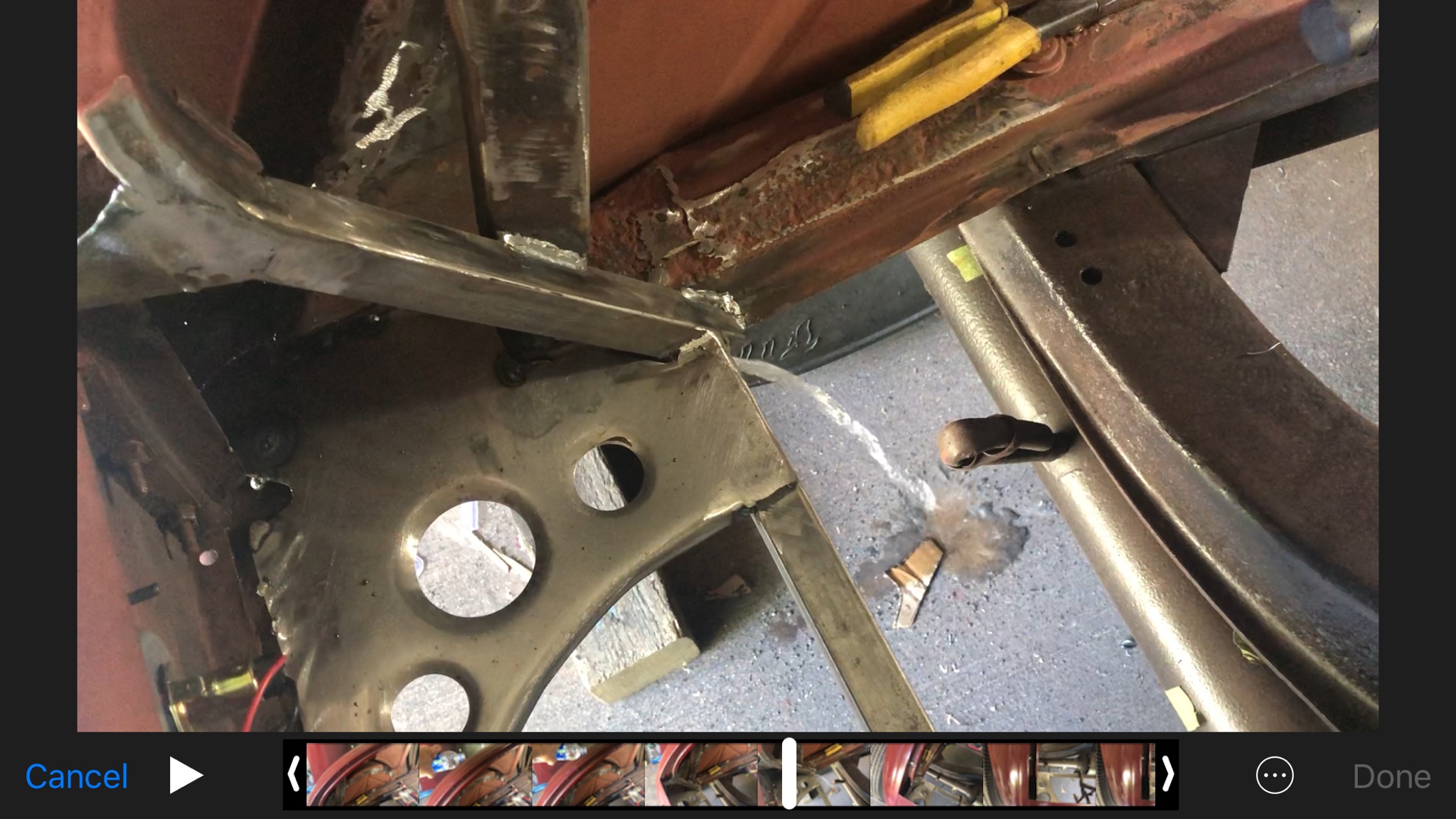

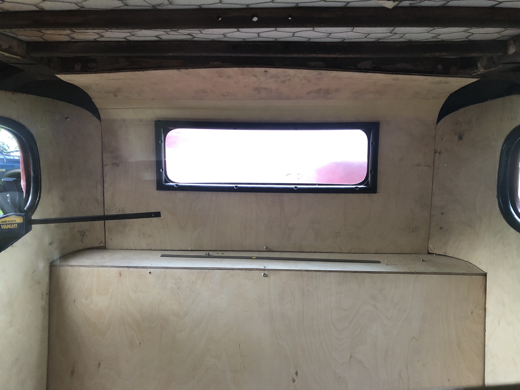

    The rear section of

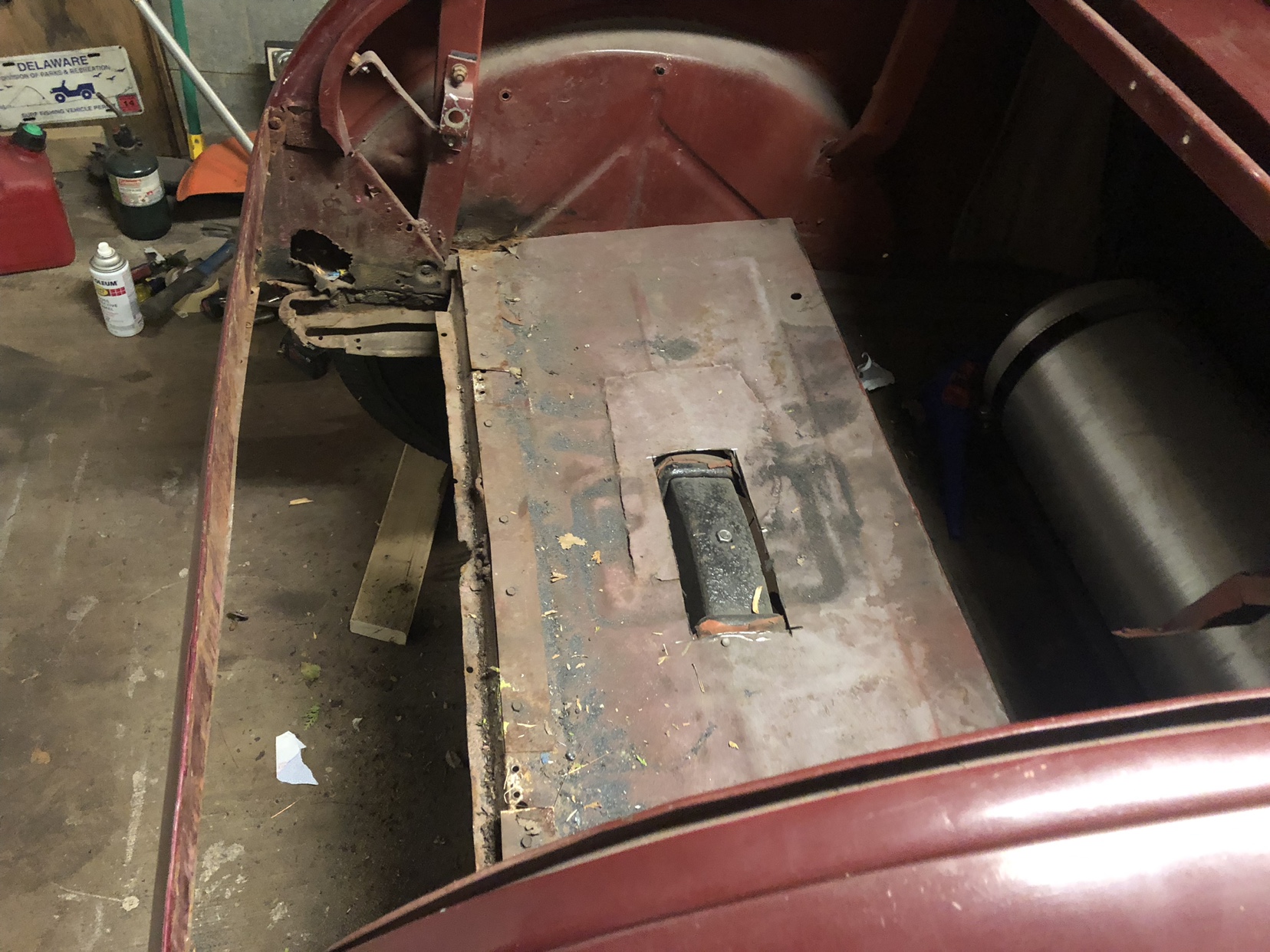

    My coupe was a bunch of notch up wood and bondo that someone did.. since I’m getting rid of the rumble seat set up I beefed it up and made some drain gutters today. I still gotta make a channel for the lid to rest on. And have a catch. I’ll make that so it drains well too. I need a bead roller! I wanna make the floor boards but don’t want to do em just flat.

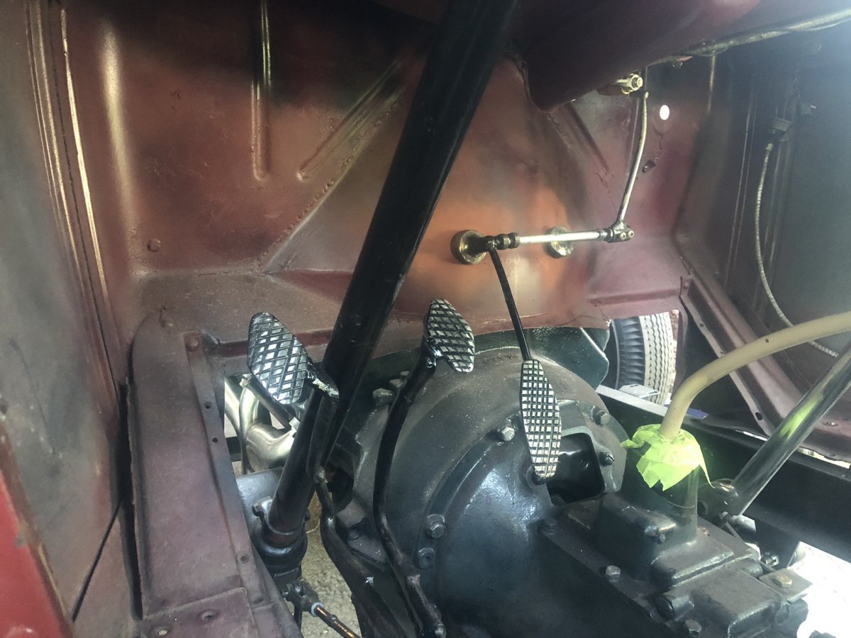

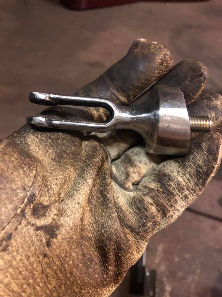

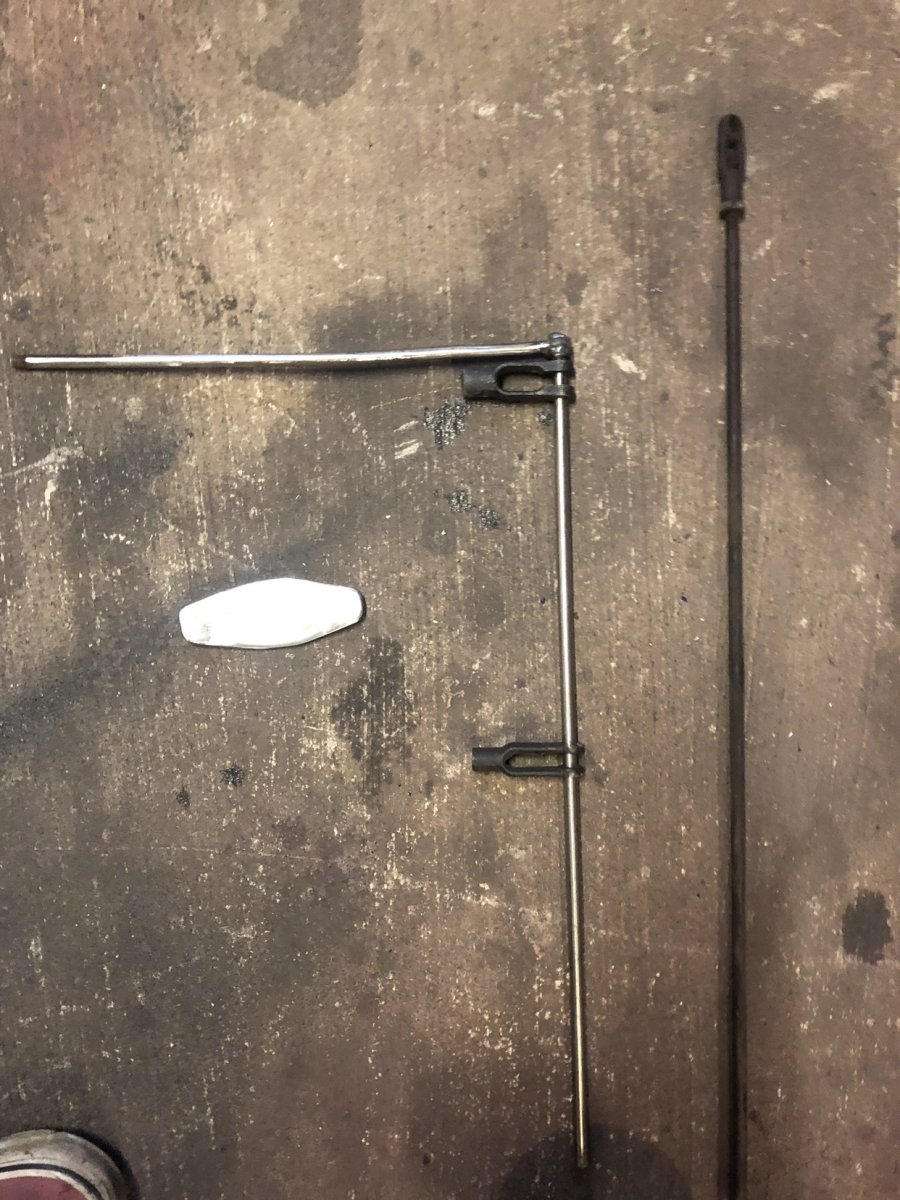

    Made up some pedals and the throttle linkage from some stufflating around. Mostly used parts from the mechanical brakes . And my dewalt drill and a grinder(redneck lathe) to make a ball on the end of the linkage arm. IMG_3733.JPG IMG_3734.JPG IMG_3735.JPG IMG_3737.JPG IMG_3748.JPG IMG_3806.JPG

    Coming along, looking good ! What’s that pedal made from ?

    Thanks made them from flat steel and carved some grooves with and angle grinder.. and bent a little to get it some contour. not the prettiest thing in the world but gets the job done for now. I’ll be at TROG but just cruising around (hopefully)

    Like your gas pedal set up. We are doing something similar as we have a big old Y block distributor on the other side of the firewall so cant get a straight shot on the engine side.
    We did discuss putting a cover over the upright throttle arm , so the passenger cant say whoa your going too fast and step down on the arm>>>

    Haha nice never even thought about the passenger hitting the brakes hah.. not a bad idea. There were so many diff ways I coulda done mine but this kinda has the look I wanted and it’s sturdy. Still simple to modify if ever needed also.

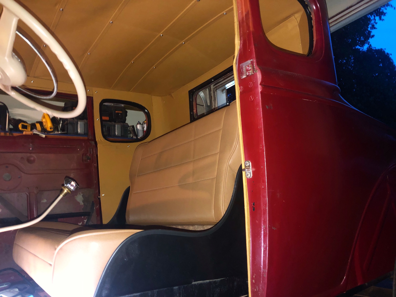

    I think I have A.D.D. Or at least I just decide to take a brake on some things and do something else. This week I decided I wanted to do the interior. I don’t really want anything to crazy. Those is what I ended up doing . There’s a piece of wood in the trunk, that’s just temporary kinda been waiting on doin the trunk sheetmetal cause I wanna get a bead roller.. anyway, here the interior. Still gotta make the windlace around the doors and make the header peice. But you get the idea.[​IMG][​IMG][​IMG][​IMG][​IMG][​IMG][​IMG]

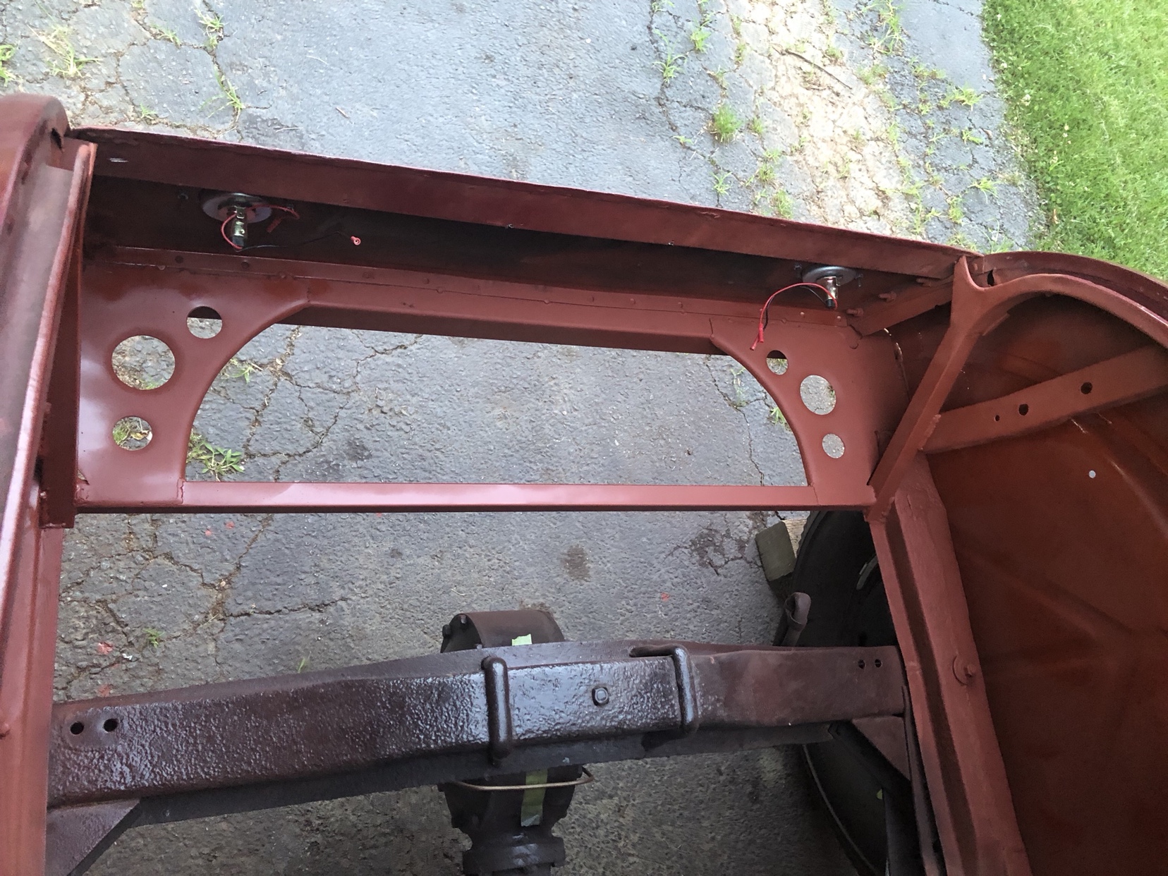

    Haven’t been moving very fast on the car lately I started a new job and all kinds of crap has just made it kinda difficult to get the car going. I still have been chipping away at a lot of little stuff that needs to get done. I have it mostly wired . And today I spent most of the day goofing off making this gauge and switch panel. I have most of my tools at work now and it was a pain trying to cut holes and stuff .. but it turned out alright for now. I may remake the engine turned plate eventually as I got it a little crooked when I was drilling holes. Haha it has the right. Look in my mind anyways. Also got the car running So it starting to get exciting . Just seems like a never ending list still but that all part of it.

    Nice switch/gauge panel!
