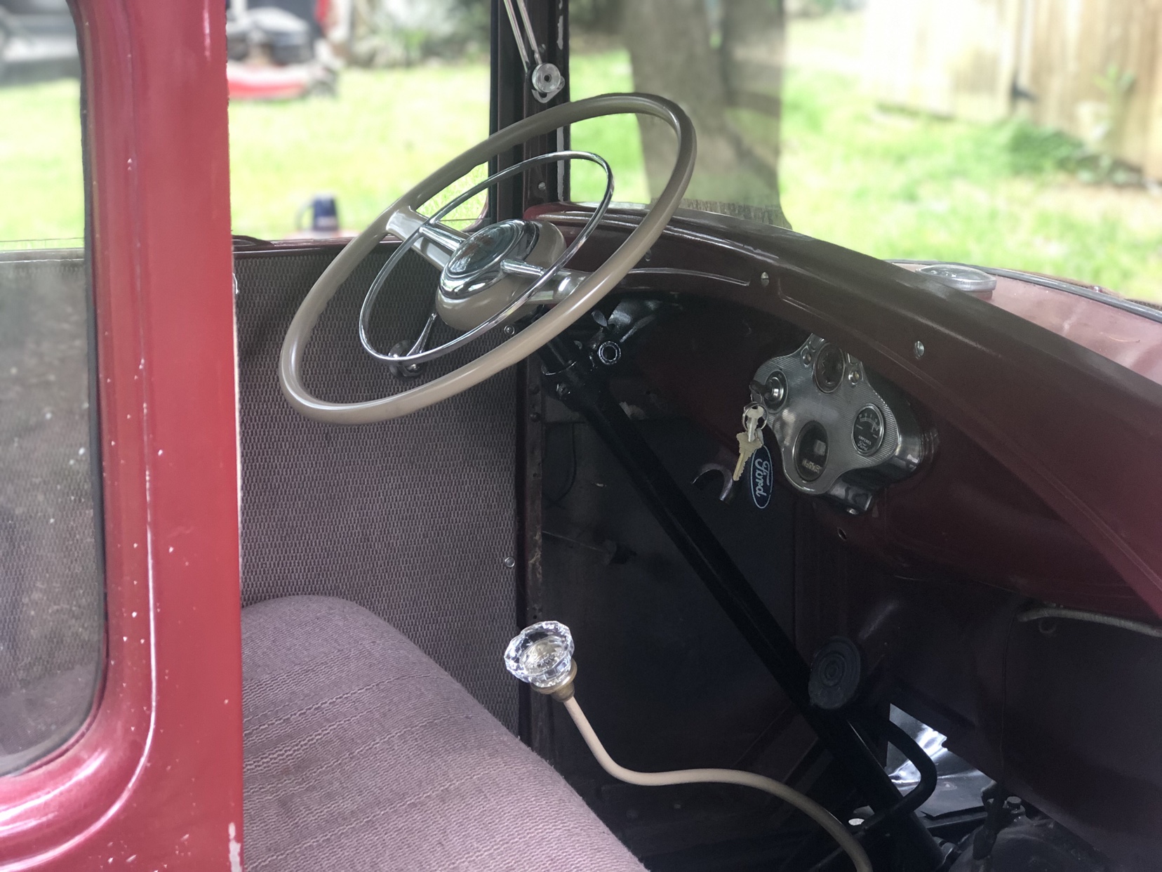

    [​IMG][​IMG] made my drag link from an old tie rod and put the steering wheel on to make sure it’s
    Centered.. seems good so far
