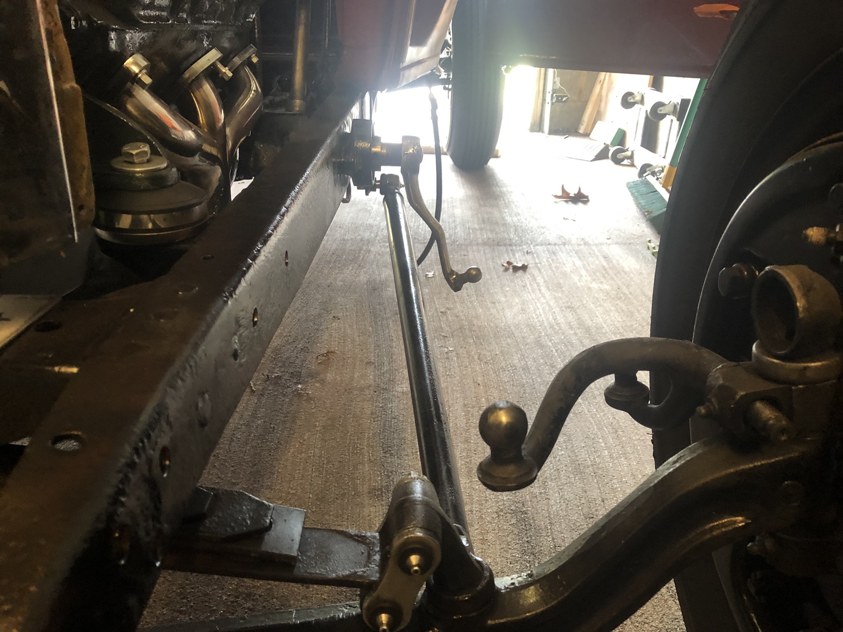

    Thanks for the kind words guys and the reference pics. I decided to move the steering box back 4”. GordonC I’m not expecting to gain any power with the headers they were $90 shipped on ebay and stainless. J like the way they look. I do actually have my motor to the right about 1/4”. (Not much but anything helps hah) But I’ve settled to where I like all the angles. (Well about as good as it gonna get.) and I have to shorten the column even if it was on the stock location so now I’m gonna shortest the steering shaft about 5” and that’s that. Now just gotta make up a drag link and modify the pitman arm . Also got the clutch linkage finished up. [​IMG][​IMG][​IMG][​IMG][​IMG][​IMG][​IMG]

    I finished my Pittman arm yesterday.. the ball on all my steering arms and everything is beat up( I have worn out balls) But I am modifying and making it all work to see where stuff needs to be. I need to get some oxy/acc tanks.! I have torches but no tanks ... don’t use em much so I have a hard time justifying it... until right now when I need it and I’m broke haha. But anyway. If I were to do it all again I wouldn’t use model a spindles. Or the kingpins... I had originally planned to keep mechanical brakes for a little bit while I was gathering juice brake parts but changed my mind. Really there’s nothing wrong with the spindles or the steering arms but the cup thing on top of the king pin is kinda ugly. Prob could just change the pins( yeah! Prob will at some point) anyway the pitman arm is doable now (cut and welded) and then I threw the hood on today to make sure my radiator is where it needs to be. Well the radiator is a little too tall. (Chinese so it’s expected) I tweeted the tabs at the bottom a little and got it down 1/4” but if I were to run the hood sides they wouldn’t work. The hood is a touch high at the nose but it’s not really noticeable. I’m thinking of notching my crossmember to drop it down another 1/2” seems like the simplest solution or just don’t worry about it. I really want to have the grill, hood/sides all in the original location. So there’s no goofy stuff going on. Like it was meant to be there. My favorite cars to look at are the ones that are thought out simple and stuff works. I like all the subtle stuff that no one knows what’s up. I do stuff in my garage which is tiny so I keep it simple![​IMG][​IMG][​IMG][​IMG][​IMG]

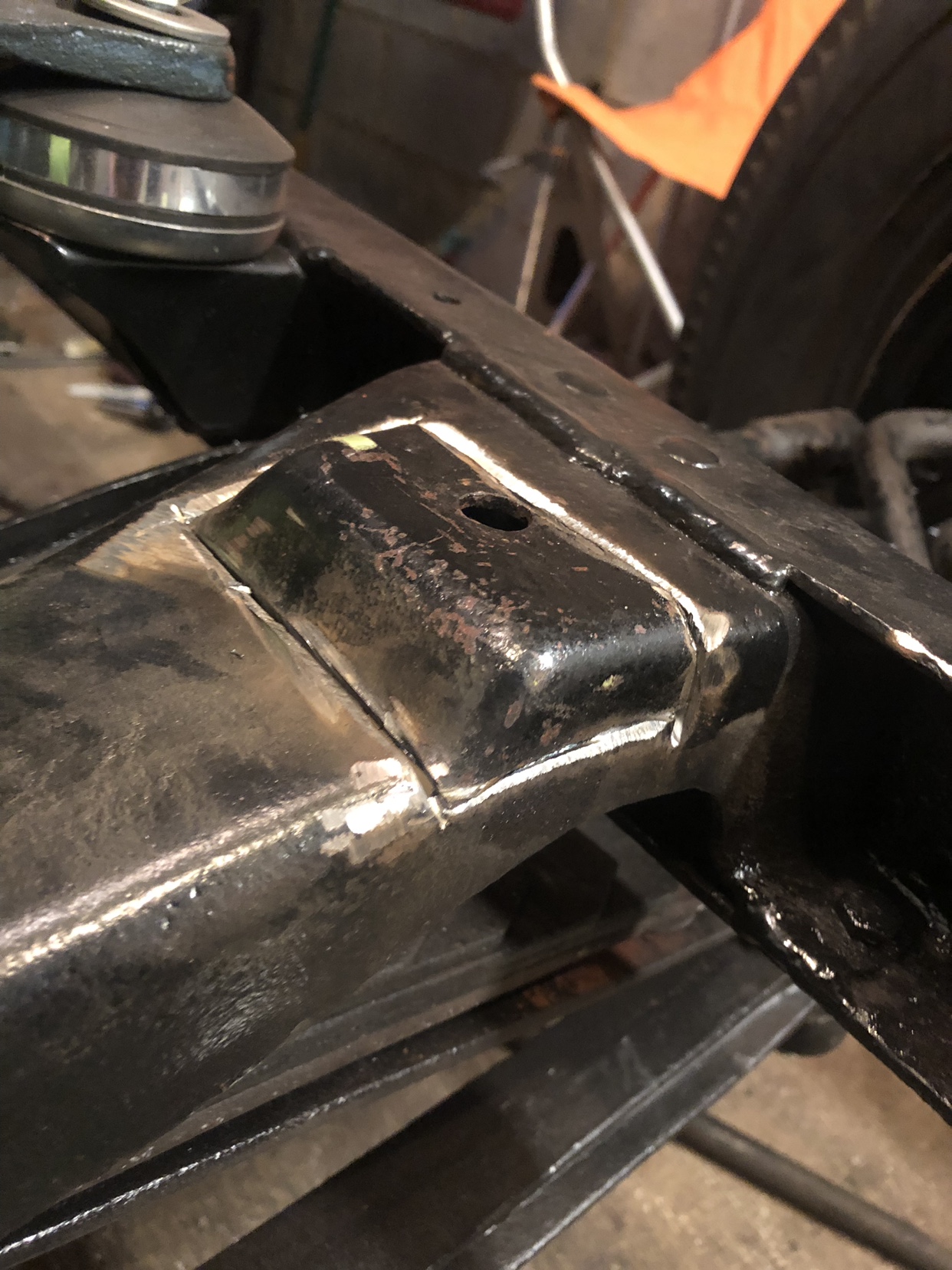

    Pretty mush everything on my car is early ford stuff the only things that aren’t. Is my Chinese radiator and my headers. The radiator was $120(I think) on ebay and some will gripe and say get a walker or something... I’m trying to get this car together in a short amount of time and. I’m not spending $800 on my radiator . But , as they say you get what you pay for.
    The radiator is decent. But it’s not the greatest fit. First think that sucks about it is that it’s at least 1.25” too tall. So rather than cutting into the tank and welding it back up the best thing I can come up with is modifying my crossmember. This bought me .75”. And I’m happy with it. Simple and easy. I don’t have a way to weld aluminum at home so this was the simplest solution in my eyes. Also painted it black. (.....rolling stones )...) [​IMG][​IMG][​IMG][​IMG][​IMG]

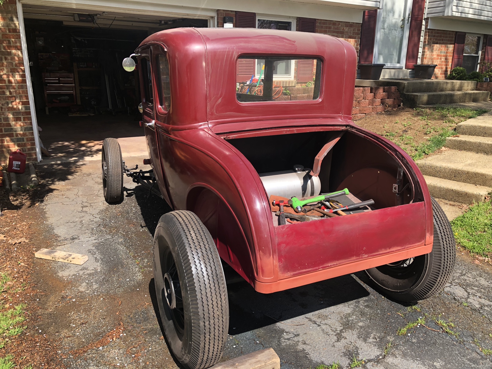

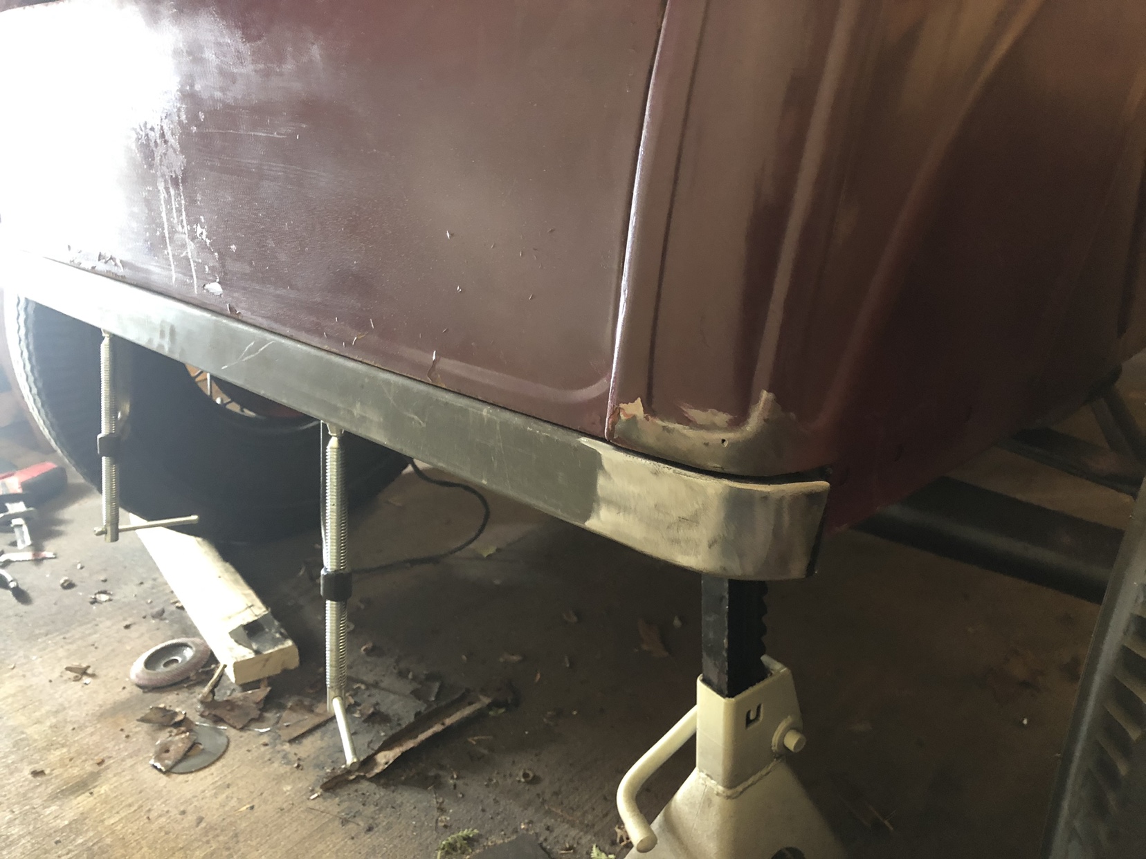

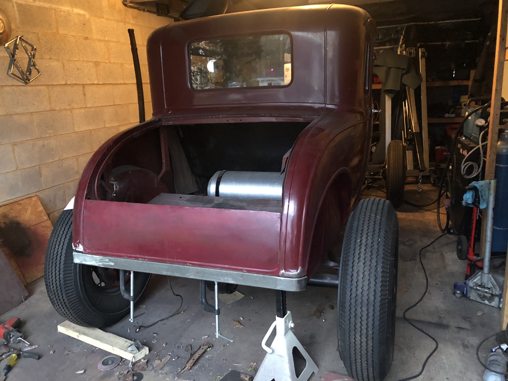

    Decided to take a break from some of the mechanical stuff last night and get a little metal work done that’s been bugging me. The whole car was original steel for the most part but years ago the trunk was hacked for a rumble seat. And the lower piece was wood. I’ve replaced the passenger side wheel well but need to do the drivers. . Last night I made this lower piece and still gotta finish it up but that was easy and it will be out of the way. IMG_2813.JPG [​IMG]

    Little more done tonight. I’ll prob finish it up tomorrow after work and then get back to the brakes and stuff.. IMG_2840.JPG IMG_2845.JPG IMG_2849.JPG IMG_2852.JPG IMG_2854.JPG

    Some of this stuff up and threw some primer and some paint on it. For now. Still have some stuff to do in the trunk. But I’m more worried about the major stuff right now. If I ever paint the car a lot will be revisited /stripped anyway so no sense in spending a lot of time on the small stuff. I need to get back to the mechanical stuff so I can get this thing goin!
